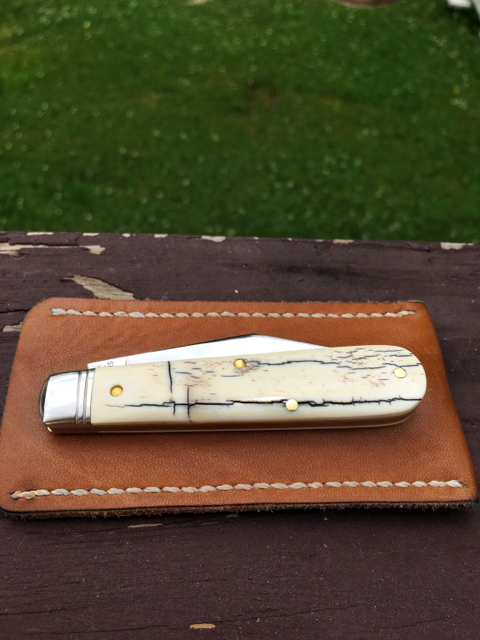

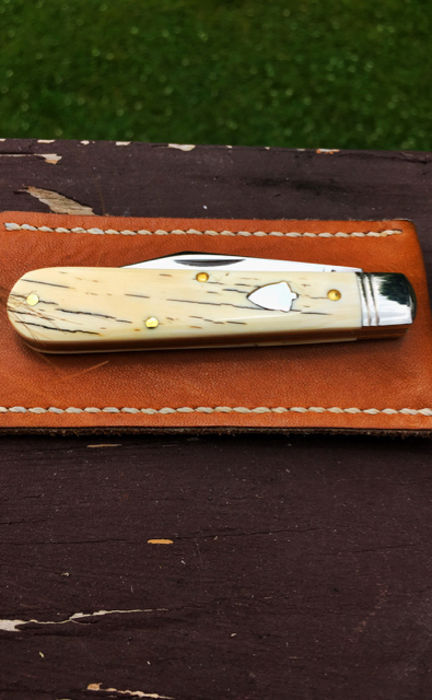

Got this gem in the mail today. Picture don't do it justice. #15 boys knife in elephant ivory bark.
[emoji7]
