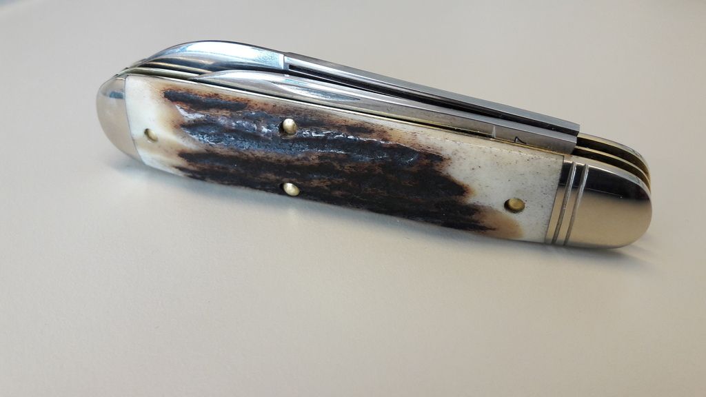

Today I got my first GEC, a #78 American Jack two blade with stag covers. I am really pleased with this knife. Opening the blades is a bit difficult as I feared, luckily I have strong and short nails. I found a video how somebody had ground the kick on the pen blade slightly lover to make more room. I have no idea what kind of warranty policy GEC has so doing this mod might not be good idea?

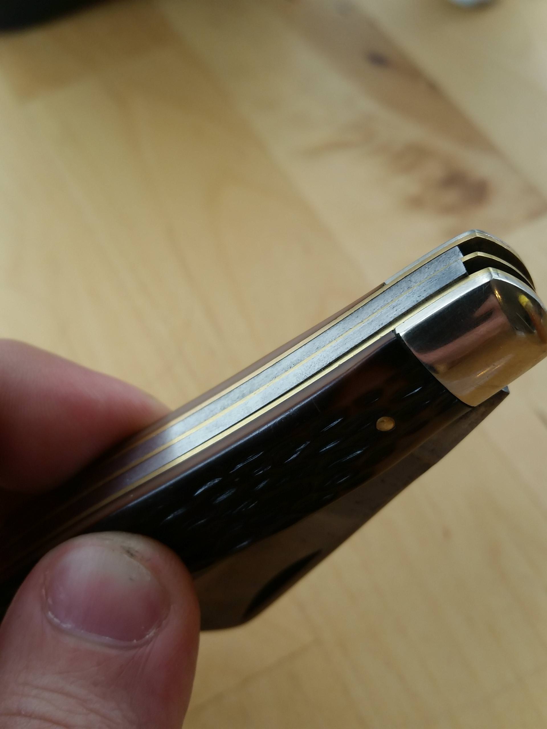

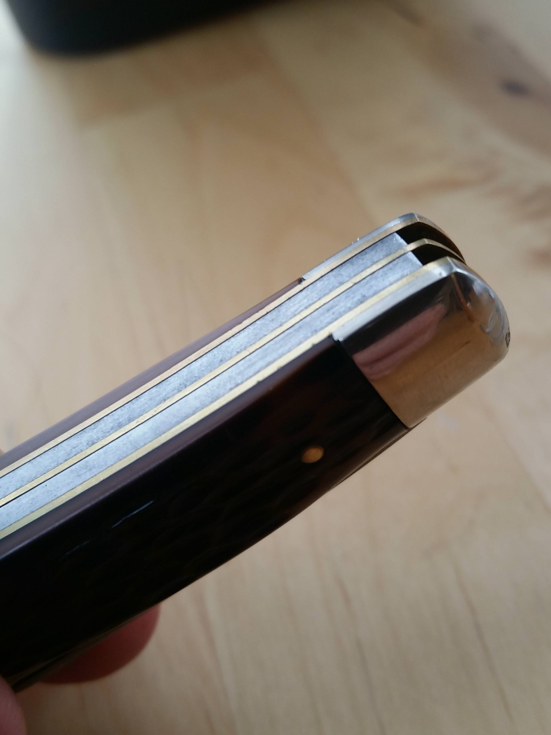

I filed the kick a touch on my 56 secondary blade. Also took a touch off the spine. Makes a huge difference when using the main. The spring sank just a touch, I knew it would be the case. It is very slight, if I hit it with the buffing wheel you’d probably never know. I also turned the spear into a clip so I’m thinking my warranty might be void anyway :P
I filed the kick a touch on my 56 secondary blade. Also took a touch off the spine. Makes a huge difference when using the main. The spring sank just a touch, I knew it would be the case. It is very slight, if I hit it with the buffing wheel you’d probably never know. I also turned the spear into a clip so I’m thinking my warranty might be void anyway :p
Well let's see it!
I did file away from the pen blade kick with a fine diamond sharpener and yes, the spring sunk. The difference is barely perceptible, it is easier to feel with your my fingers than see. The difference how easy the main blade is to open is bigger, now I get a better angle when pushing my nail in. The bottom of the nail nick in the pen blade is just beginning to touch the handle. So in my opinion this modification is risky, but I'm happy I did it. I feel also that since there is less tension in the beginning of the opening cycle the pen blade might actually be a bit easier to open now?

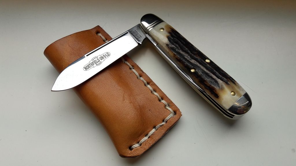

I also have a leather sheath I never got to finish that fit the GEC, so I glued and stiched it. The leather edges need to be sanded, but the knife fits great. I'm carrying now my first GEC in it's own moose leather sheath.
