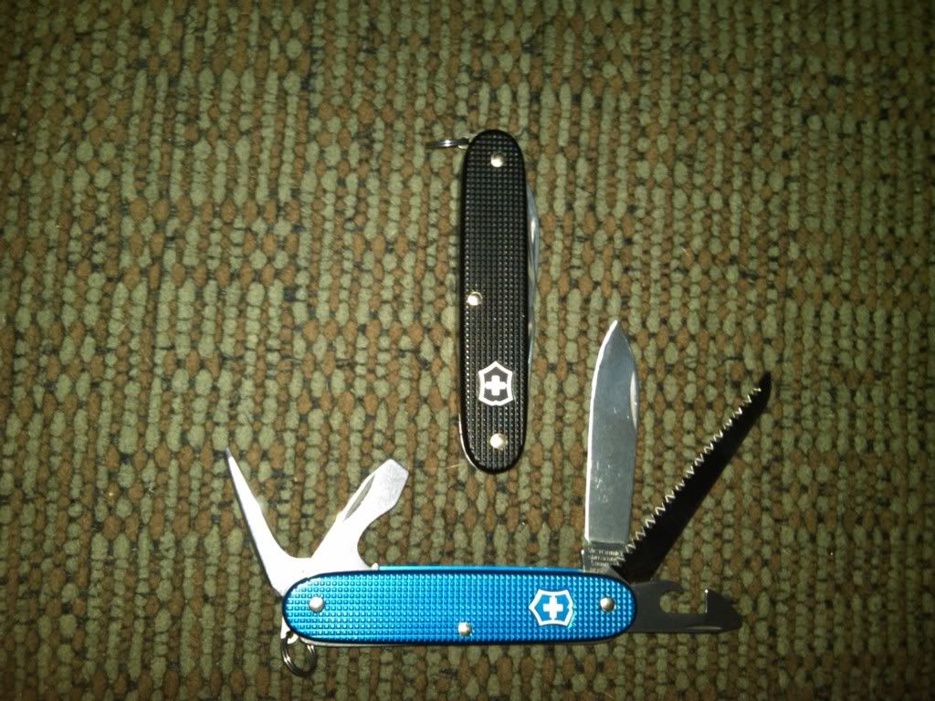

Thanks again, Stealth. Now, I am shopping for used SAKs as "donors." I may have woken a monster.:o

The tweezers are great and I should buy half a dozen spares. I bet I couild work a pair into the next mod too. May be more work on Alox, but there's got to be a way.
do you happen to have the name (or link) of the fellow that is doing the modding- don't trust myself :)
Check your messages. I have to tell you that this was a bit of tedius work, especially peening the heads on the back. Doing the front (off the knife), they came out perfect until I flattened them a bit while peening the back.
Would you care to share the diameter of the pins?
The pivot pins were .117" to .119" and the spring pin (middle one) was .095". I used .115" brass stock after getting Kaleb's approval. E-mail me if you want more detail so I don't derail the thread.

You wouldn't happen to remember where that blue one in my first pic came from would you?;) I think that came as part of a trade we made a couple years ago.
I would do a tutorial but I would have to post it elsewhere and those who visit whatever place that is probably know how to do it already. My interests lie primarily in steel as it pertains to wilderness and survival applications AND in self-sufficiency, such as in the case of making or mod'ing the gear to support those interests. That's why I shared it here. Besides, it's now my favorite SAK. That would be a stretch for any mod trying to justify not nmoving it.

It wasn't all about the .107" difference in thickness and 26% reduction in weight (I figured someone would want to know this). That was simply a happy side efffect of losing a couple tools that were doing ME no good to tote around. Yeah, it's noticably more compact and will get carried more too though.
I have a multi-tool in my pack in case I need a screwdriver, so no sense having extra screwdrivers in my pocket. The can opener was terrible at best, comparatively speaking anyway. I am a child of the "c-ration days" and I have a P38, plus a backup, at any given time and it works beautifully. The bottle opener, well, I might just be lazy, but I am not lugging glass bottles of anything out into the woods and then dragging the empty bottles back on top of that. Besides, there is a bottle opener on my multi-tool in case I decide to go back on my word.;)
And for my biggest complaint about the Farmer - the lanyard ring mount that digs into my hand when I use the saw or the knife blade - GONE and GOOD RIDANCE! Man, I loved the idea, but once I started using the knife, I decided it really should have been a good ol' fashioned and bulky bail.
Now that I figured this out, I will watch for an old, beat up electrician's knife at the flea market and grab it to salvage the bail if I want to put a "dummy cord" on my SAK.
:foot:Now, if anyone is offended by my outspoken derision of the parts I removed, please don't be. These parts served me no useful purpose, especially that lanyard thing. The Farmer is a great knife, but I saw in it an out-in-the-woods tool that could do a LOT of what I need to do out there and it's trim enough to slip in along with other stuff and always have it with me.
By the way, this was not my idea. I saw it somewhere, maybe on SOSAK. There is a fella who does professional mods on SAKs for folks and this is a popular mod. Also, I needed to goof off for a while. Been a long time and it was nice to work on something that didn't HAVE to be done NOW.

Again, thanks to my friend Kaleb for the help. I could have let him do it, but I just have to mess with stuff. Next one will be perfect.:thumbup::D

Yes, and I don't mean to berate the tools across the board either. I removed mine to make it a woods-specific tool. If I were carrying it under other circumstances, those tools would have been more useful to me and I could have tweaked the can opener to make it work. Some may work fine, right out of the box, but the ones I have had required some attention.
For anyone who wants their can opener to work, the problem with mine was that the "claw" that hooks under the can's rim, was too rounded to get a bite and the part that was supposed to pierce the can had a large flat spot on it. Bending the tip of the claw toward the scale, and then making it flush again with stones would give you a sharper tip to bite into the can's rim. Since the design makes you work forward, that claw hangs up a little and is not as convenient as dragging the claw on a P38 as you reposition for the next cut. Sharpening the piercing part would be easy enough but keep the angle high and don't polish it like a knife edge. Some toothiness on that part makes it work better. The can opener on my blue Farmer is better but could use the claw tweak. The one on the silver one was pretty bad.

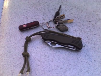

I finally got a pic of my current favs, a Sig Lite with my "tool keyring" and my new OH Soldier.
I think the P-38 is the only bit of redundancy, but I've mentioned before as liking one as my preparedness talisman.
