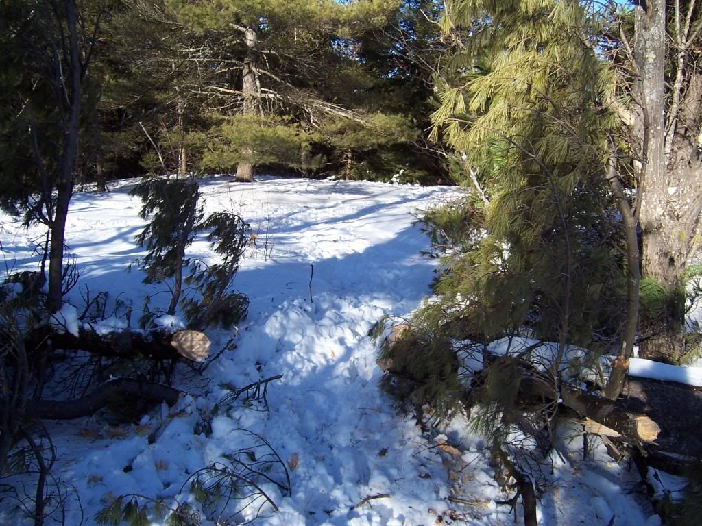

The weather definitely tests your metal. Plus this site is 1.3 miles and 1200 vertical feet up the trail. Packing iron up the trail in rain gear is sweaty work.
Peg, would love to join out on the trail some day. Great work. Need a road trip to visit out west.

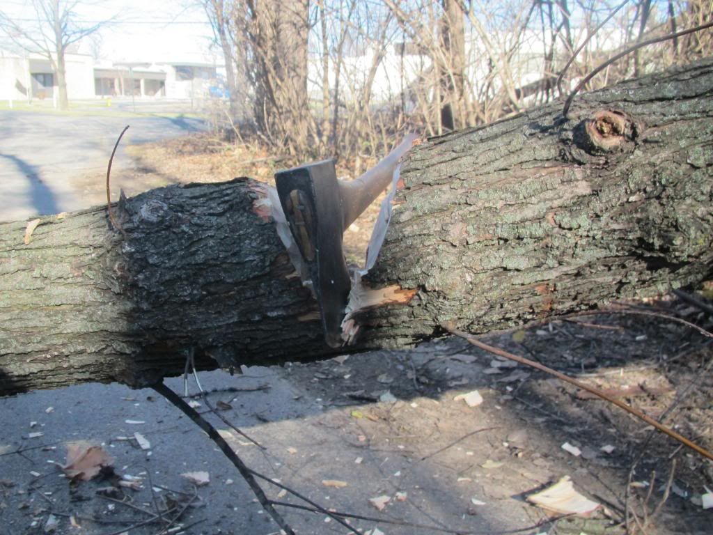

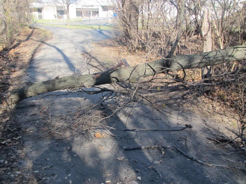

Had some heavy winds that brought the top of this tree down over a walking trail in the neighborhood. I took my Collins Legitimus down with the dog one afternoon to clear it out. Being it was the holidays I don't think the parks dept would have been along to help for a couple of weeks. It was still razor sharp after the workout.
This was the second cut.

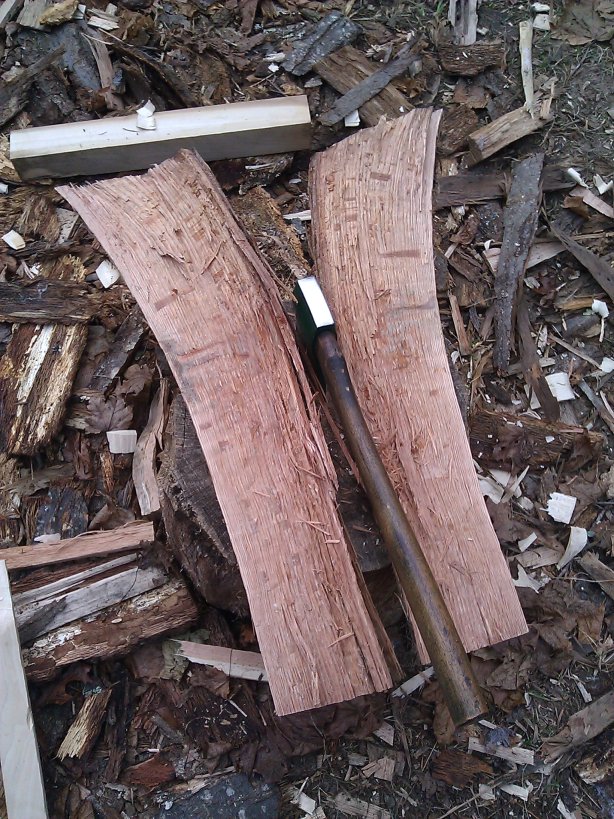

Cold snap coming our way, time to catch up on the firewood with the 3.5lb Mann:
I knew this one would be tough, and it's too long for the stove anyway. After starting a split from the end, I stuck the axe in the split from the side and pounded on the poll with another log. It got predictably stuck, so I figured it was time to practice some wedging techniques. Out came the little 1lb hatchet:
The first wedge released the big axe easily enough. Time for a second:
Once the wedges had done as much work as they could and the piece was mostly in two, the hatchet made short work of the remaining fibers.
I like this little hatchet, but the head is still coming loose after re-wedging. I couldn't get the head off to re-seat the shoulder of the haft the last time. Looks like it needs another attempt.
Did you get some strange looks it that neighhood? Anybody offer to loan you there chain saw?
Just wondering. My neighbors used to offer there's all the time.
Like your axe to. I love it when they have vintage handles.
I guess Oak does not split easy. You guys are fortunate to have the varietes of hard woods that you do.
The power of the wooden wedge! :thumbup:
What are you splitting there, red oak?
and lots of it.
It was a mixed delivery of mostly red oak and maple.
Oak normally splits easily enough if you exercise just a little care in how you hit it. The problems start when the grain starts to go weird. The spread at the bottom of this piece was very dense and starting to change directions. Normally the Mann just plows through in one modest swing.
