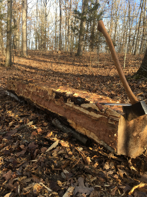

Looks good!Got this log joggled on 2 sides today. Just playing around wit it. Don’t be too harsh on meReady for hewing with the new broad axe when my body gets some more energy. Merry Christmas everybody!
Thanks, good to know. I wondered about the bark being sufficient enough landing. A piece of plywood is cheap insurance though. As far as a beam or post? You decide haha. As of now I don’t really have a use for it other than wanting the experience of it. My hats off to the men who did this all day everyday.Looks good!
I'm not an expert by any means but I can give you one tip from experience. Be sure to lay down wood, plywood works well, under the log where you'll be hewing. So if you miss or go through you won't drive it into the dirt or a rock and ruin your edge. It's discouraging and I've done it.I thought the bark chunks would be enough but they weren't. Look forward to seeing your finished beam! Or post?
Welcome to the club npace. Keep up the good work.Got this log joggled on 2 sides today. Just playing around wit it. Don’t be too harsh on meReady for hewing with the new broad axe when my body gets some more energy. Merry Christmas everybody!
I have thought about trying to get it up higher and may end up doing so before all is said and done. I have seen it done both ways so I’ll just have to try both and see which way works for me.npace--I would suggest you get the stick up about knee height and dog it tight before putting the broad axe to it. For an example of what I am saying, look at the hewing section in the US Forest Service training video "These Old Cabin Logs"
Thank you Ernest!Welcome to the club npace. Keep up the good work.

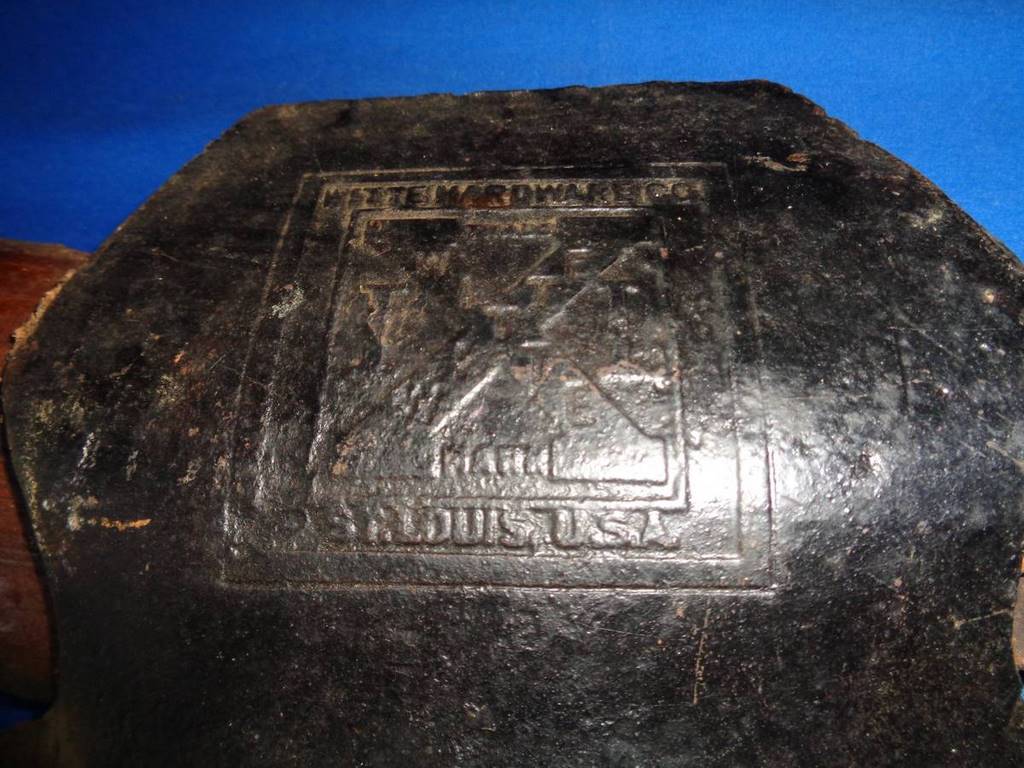

Good afternoon npace. Not sure if you are partial to broad axes or not. But there is an embossed one on CL out in KC. It is stamped Witte Hardware St. Louis, MO. Not sure if you would be interested or not. Nice little piece of history.Got this log joggled on 2 sides today. Just playing around wit it. Don’t be too harsh on meReady for hewing with the new broad axe when my body gets some more energy. Merry Christmas everybody!
That is a nice one I will go look at at that. I work in St. Louis as a crane operator and I pass the old witte hardware store building almost daily on my way to the job. It has been rehabbed into office space but they kept the old witte hardware store painting on the side of the brick building. I have had my eye open for any axes from them but haven’t found any. Thank you sir. I appreciate it.
