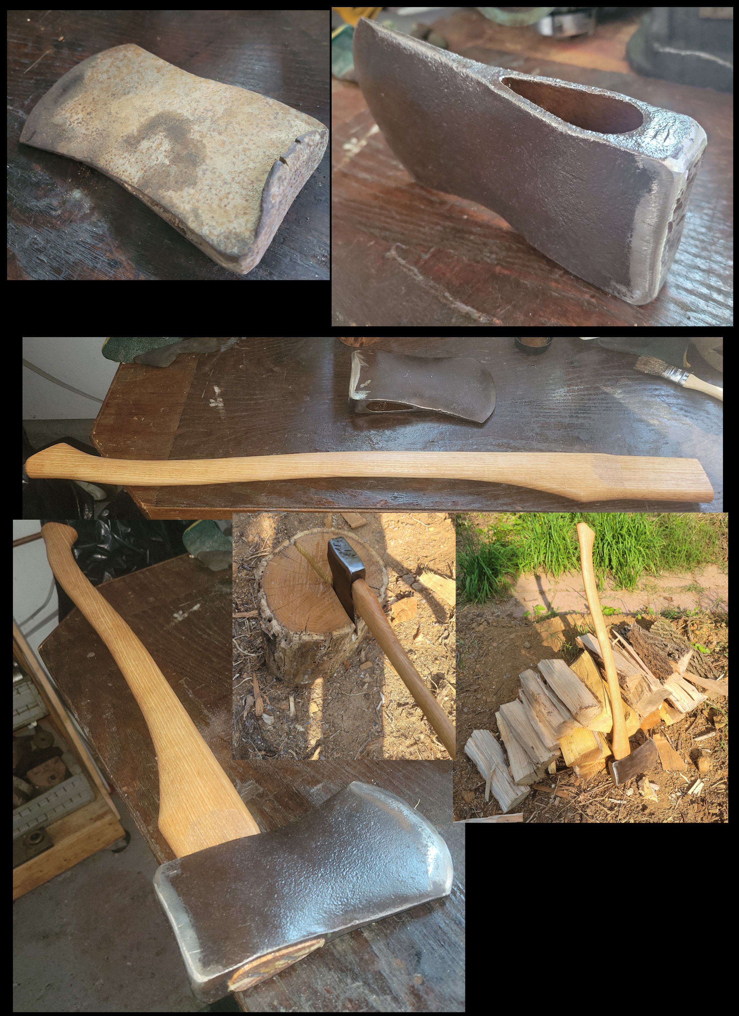

This is an old dayton pattern head of unknown manufacture. 40+ yrs ago the handle broke off and I tried using it as a wedge with the apparent results. My dad grouched at me at the time and the head got lost in the back of the shed. We're cleaning all that out now, and I found it- so cleaned it up and hung it on a 34" haft to make up for the neglect of ages ago. No idea about the manufacturer, it feels like 4 lbs or so- but works fine :cool: I've been using it after breaking rounds down to quarters- its fast and pleasantly accurate compared to the 5lb Council which does hit harder on the big stuff. I have a couple other old heads waiting for hafts.
I prep the hafts by soaking them overnight in linseed oil, then wipe off and fully submerge just the head in more of it for a 2nd night. Once thats all done I give the haft a quick scrub with steel wool so its smooth.
