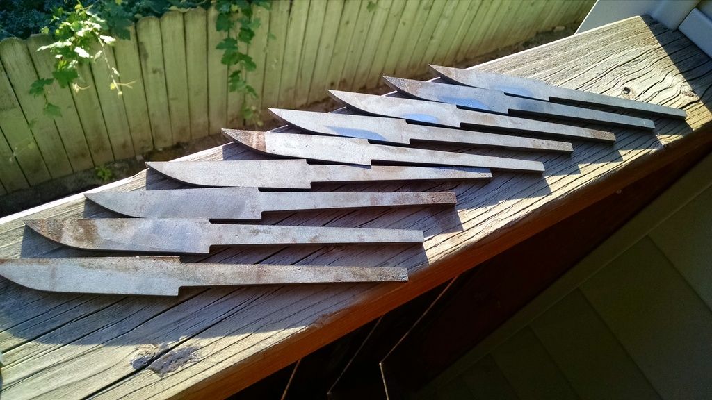

I had been geeking out on knife steels with Daniel.
Without access to commercial liquid nitrogen it looked like high end PM steel was never going to happen in a Malanika Puukko.
I wasn't going to take no for an answer
I have personally taken my time and effort to provide Daniel with the raw materials needed to for him to make this a reality
A high end PM steel Puukko
These will be very limited
This is a labor of love
I'm not making money from this
I haven't revealed the steel because I thought it would be fun to have you all take a guess haha
I'll update with more information and details later.
Needless to say
I'm excited!
The steel is CPM M4 (9/3/2016)

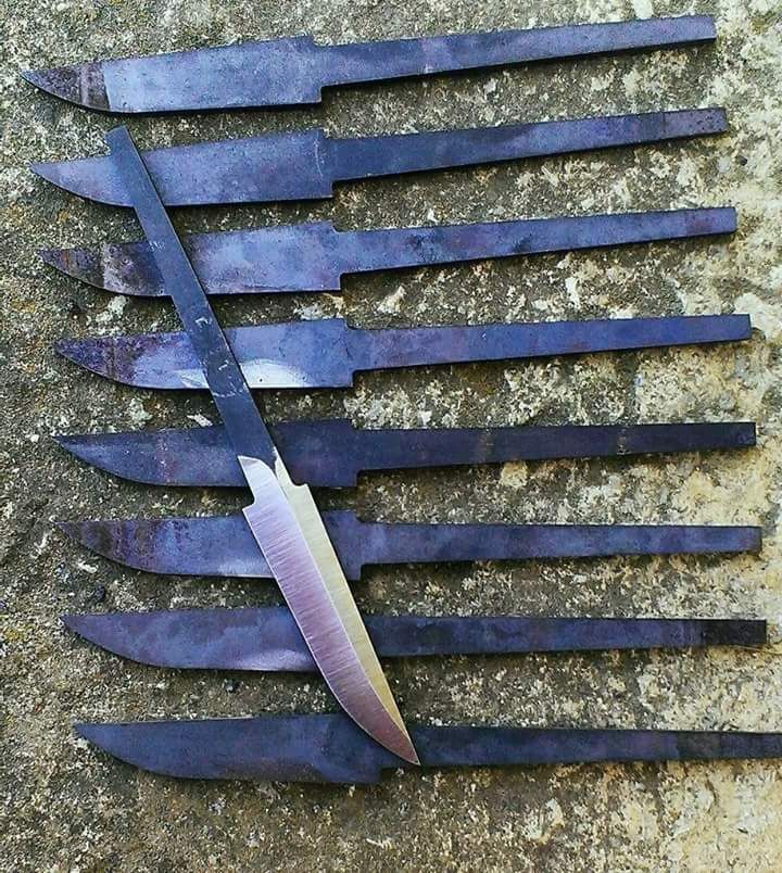

Been drooling over puukos lately. Sounds intriguing. Looking forward to updates.
One question, why wasn't some of the stock removed before heat treat. I would think that would really help speed up the process.
Haha I know right? Me too
Why no stock removal?
1.even heat treatment throughout the blade
2. Don't have to deal with warping issues.
3.its a High speed steel that doesn't loose it's temper very easy. It has a high red hardness.
4. They will be ground on a first waterstone wheel. For speed and also for temper with is not a huge concern given the steel.

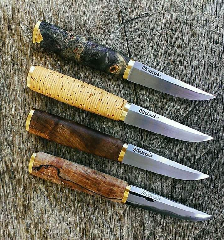

You would be surprised at how well 80crv2 at 62 does with a fine edge :)
Thanks guys
Just Imagine these
In PM Tool steel:)
