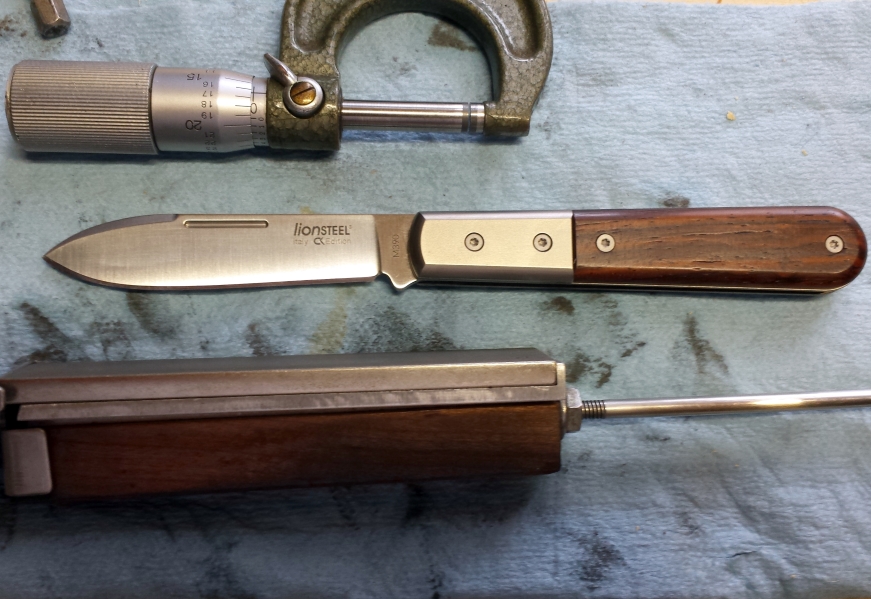

Who has tried to sharpen theirs yet?
I am glad I have diamond stones. Just take your time and know that the longer it takes to cut with stones, the longer it will take to wear.
I used my fine DMT, and a loaded strop. I didn't want to go too polished yet, that will be for further down the line.

I'm wondering how thinly it's ground though. If I'm going to have m390 (and have to sharpen m390) I want a nice thinly ground blade so that it cuts really well. I got to handle one recently but didn't really check the grind. How have these been cutting for everyone?
I wholeheartedly agree, it would be great to see a clip point on the next run.
Back in 09 I tried D2 for the first time and at the same time I ordered a KME system. Best knife accessory investment ever.
I profiled to 18 per side, started with a 320 diamond then 600 on the Santos. Same thing for the CF except I took it to 1500.
Thickness behind the edge came out to .024 on each one. I would have prefered .015 to .017 BTE but it still slices well. I'll send them to razor-edge-knives eventually but not till this winter. They have to be broke in first.
M390 holds an edge extremely well, much better than D2.
Like my other two M390 blades instead of working it till it's dull, I'll hit it with the strop from time to time and only rarely put the diamonds to it.
