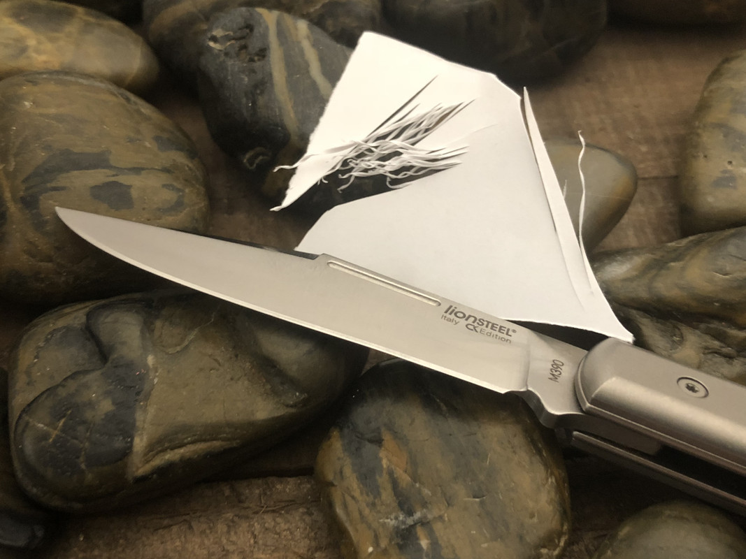

I think they thinned down the blades since the first release, my Shuffler was fairly thin, took a bit of time on my water stones but got her down to slicing very well now.

About 2 1/2 hours spread out over 3 nights I think, including finishing sharpening it. I used a wicked edge system, first with the 100 grit stones and then raised the burr on both sides with the 200 grit. I wanted to be able to touch up the edge quickly on a Sharpmaker going forward, and it worked really well.

It would depend on your system but on my KME I easily re profiled to 17 DPS then a 20 DPS micro in about an hour and a half.
That wasn't steady work, profiled with a 600 Silicon Carbide Stone then finished the micro bevel with an 800 diamond.

Thanks! I am no expert sharpener but am learning. After putting the new edge on the half stop saved my fingers after getting careless with it :eek:

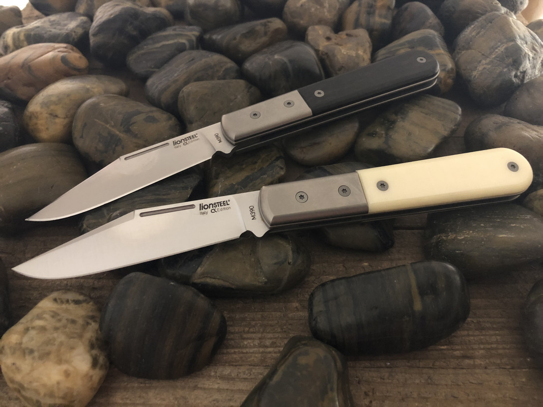

A question about these, are there 2 different color options for the metal part of the scales? In some pictures they look almost black?
Mine arrived today, very happy with them. Seems like these have a tighter pivot or pull, which I very much like, and they are thinner behind the edge than the previous run which I really like.
Looking good. I like this knife with the clip. I have one in polished stag and one in CF. I need me one of them bone micarta jobs :)
