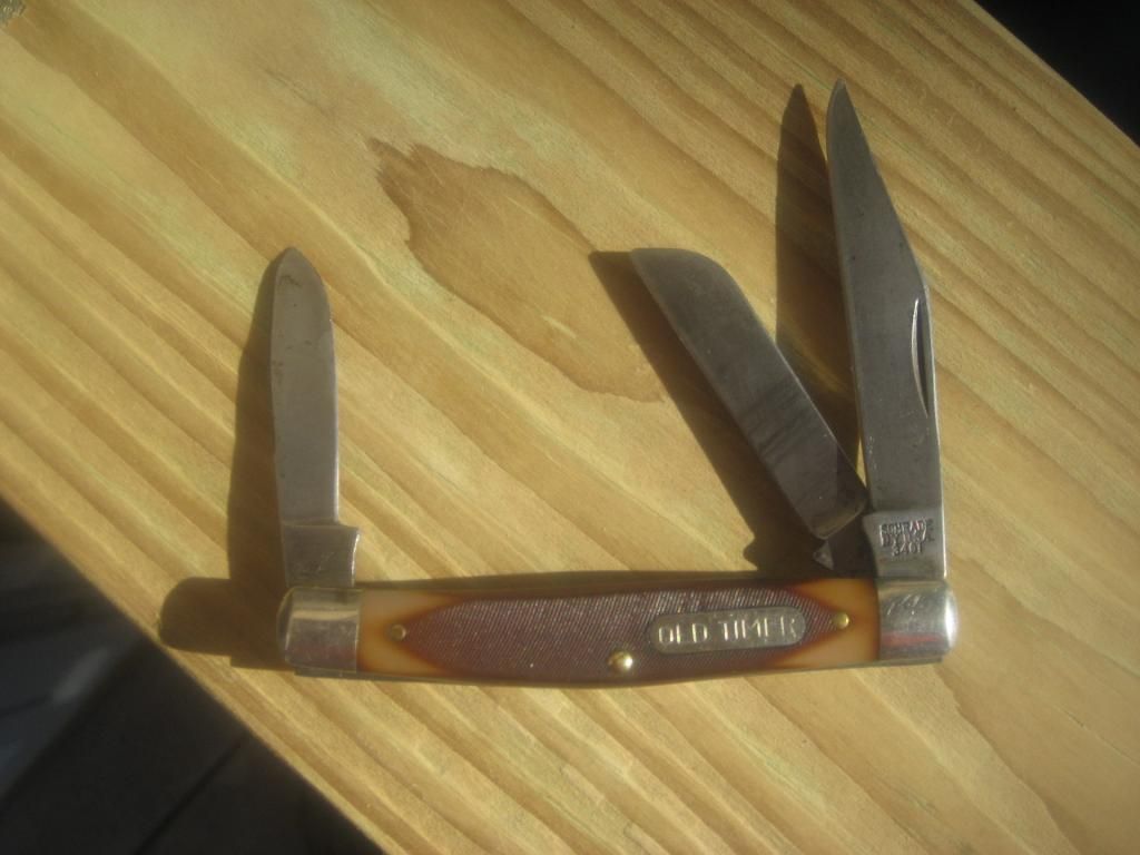

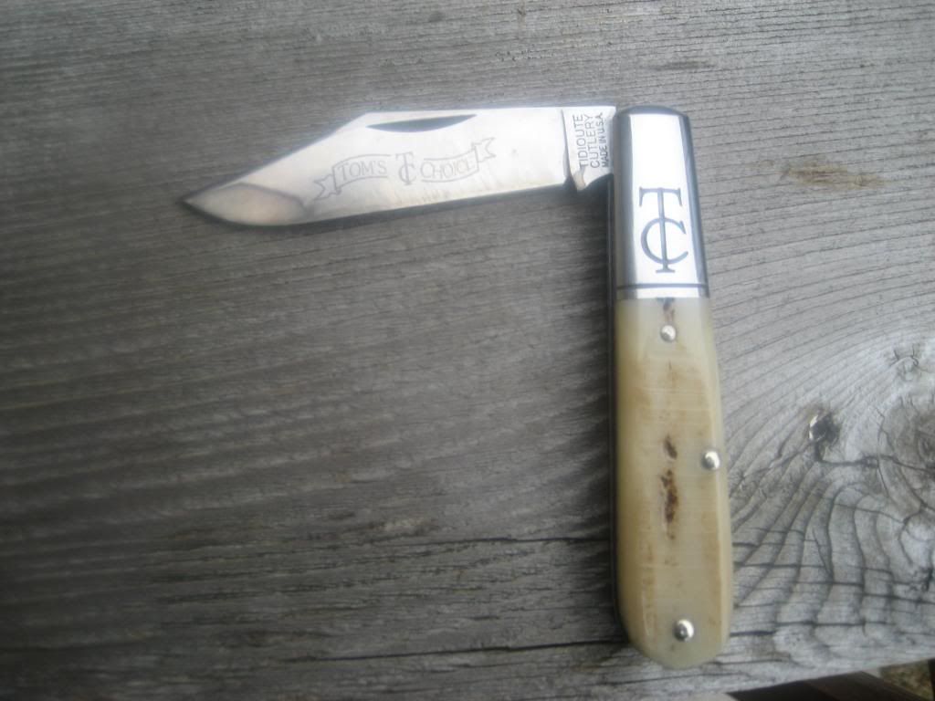

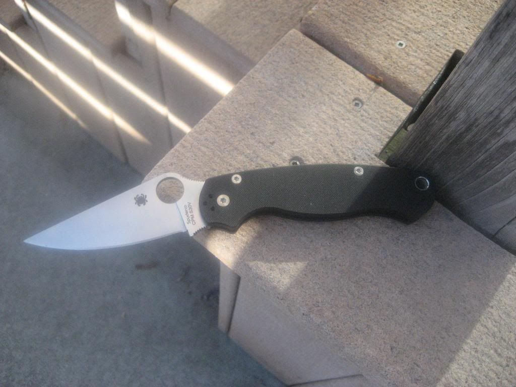

Local knife sharpening service just butchered 3 of my knives.
Is there anything I can do with the Barlow to make it look better?

Unfortunately you can't add metal back, you can only remove more. I have taken very worn blades and flattened the recurve out with a file, and started over with a new grind.

You could take out some of the recurve by removing some material near the ricasso but you would have to also remove some of the belly to get rid of all of the recurve and that would be a lot more material that I would want to remove in one fell swoop. If it were me I would use the knife regularly and periodically resharpen it on a flat and 3" wide stone (or guided system) to gradually straighten the edge out.
I see nothing that you could not have fixed yourself with a decent grinding system like a Lansky deLuxe or an edge Pro and some patience, too bad to look at what the man has done to your knives!

With the GEC, you might want to contact them and see what they would charge you for re-blading that knife.
I just called GEC and spoke to Bill who was awfully nice and he told me to send it in and they'll see if anything can be done. It's worth a shot.

I can understand that and the downside of using it regularly is the regular reminder of that guy messing up your knife. Starting over by selling and replacing the PM2 and the Old Timer is feasible but with the Soup Bone Charlow not so much. I really feel for you Ribeyguy.
The Schrade is the most permanent loss. No chance in factory repairs since they went out of business in 2004. Furthermore, that tang stamp dates the knife to the early 1980s or so. Fortunately though, they are relatively common on the secondary markets and even a NIB example won't cost much more than a new knife from GEC.
I was going to mention this as well. Shoot Christine an email or give her a call. She's super nice and helpful and luckily for you this particular blade shape on that pattern is one of their most common so chances are they have some spares laying around. If not hit up somebody like esynx here on the forum as he does a lot of modifying and may have an extra clip laying around. Good luck and let us know what Christine tells you. :)

It hurts to look at those and I cringe whenever I hear someone mention knife sharpening service. Making a recurve out of a Charlow should be a crime punishable by hard labor (other than knife sharpening).
Ridiculous. I know you're engaging in hyperbole, but it's just a knife. Admittedly Charlows are very nice knives, but it's not like the guy destroyed Abraham Lincoln's congress.
I have a soup bone Charlow that has a similar profile, though not as pronounced. I didn't bring it to a sharpening service, I messed it up myself. I had trouble with its initial sharpening, and instead of stepping back and taking stock of the situation I let my impatience get the best of me. Voila! Instant recurve. I learned a valuable lesson that day about taking my time. Perhaps this misadventure will inspire the OP to learn to sharpen better, a requisite skill if your hobby is knives.
My Charlow may no longer be pristine, but it's become one of my favorite knives. That sharpening snafu was a mixed blessing. I no longer hesitate to use it the way a knife should be used, not romanticize it as some sort of precious artificact. It actually reminds me of some of the older pieces we see around here, many of which have similar shapes.

I was doing the sharpening myself since I got into knives but the tip I couldn't correct and it kept getting more round. I thought it might help and it didn't.
