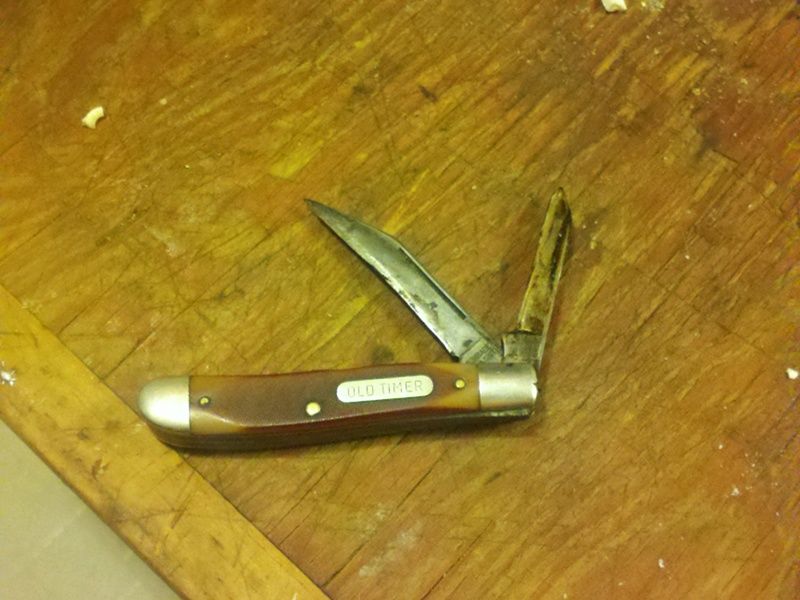

Local knife sharpening service just butchered 3 of my knives.
This is why I beg people not to give their knives to some Joe Blow at the gun shop or gun show or anywhere else sitting there with power equipment...there's a very good chance it ain't gonna turn out well...and a ton of these threads on BF. Sharpening is an art, and folks who are willing to give up their knives for a quick and dirty 5 minute edge generally get what they pay for along with blades with years of life taken off. Folks willing to provide a "churn and burn" service like that are usually more interested in the quick buck than how your blades look and perform in the end. To really get your money's worth, seek out some of the guys on here and check out their work.

I'm not sure if this can be done, but since the Delica blade is smaller than the PM2 blade, maybe the blade can be taken down to a Delica size. I'd be ok with that.

It looks as though the person who did the sharpening didn’t take the edge back to the ricasso, and he paused when changing directions just before that point, removing a lot of metal and leaving a kind of recurve. I don’t see an easy way to fix that without removing a lot more metal, which would just make the situation worse.
But if you can round off the lines of the unsharpened part just before the ricasso to smooth out the transition from edge to ricasso, improving the looks. Then just reprofile the rest of the edge to match one of the stone angles on your Sharpmaker.
Personally, I think this is a job for a professional. I’d send these photos to Clay at Wicked Edge for his advice. He’s putting out a line of non-power knife sharpeners, and some people use his system to run their own sharpening businesses. He’s also good about sharing his own expertise.
I think you have three choices at this point:
Get professional help to restore the edges, fixing the ricasso transition and fixing the profiles and points. You could even have a mirrored edge put on them to turn a sad experience into one that makes you proud of your knives.
You could just sharpen them on your Sharpmaker and live with it.
Or you could use this experience to justify buying a Wicked Edge or Edge Pro sharpening system. The Sharpmaker is useful and handy, but it’s really designed for maintaining a sharp edge that is already correctly profiled to match one of the stone angles on the Sharpmaker. Just practice on a cheap knife first to develop your skill. I always prefer the option that leaves you more empowered.

Thanks for the advice and support fellas. I sent off my Barlow to GEC so we'll see if anything can be done with possibly changing the blade. As far as the PM2, I've reached out to a few of the pros on here in the Custom Shop services offered sub forum, to see what they can do.

Sorry to hear, but frankly why not learn to sharpen yourself? Get Edge pro or something and go for it.
It took a ruined Paramilitary 2 and Manix 2 by a "professional" to convince me to start sharpening on my own. They took off tons of steel and the edges looked like they had gone through a mulcher. The knives weren't even sharp after. When I pointed this out they blamed it on the steel, which was S30v! They told me that bad steels can get sharp.

Those aren't just over sharpened, they're extremely poorly sharpened. That really sucks.
This is a good opportunity to learn how to sharpen yourself. Get an Arkansas stone and an inexpensive, soft kitchen knife, and grind away metal to your heart's content. Learn the process, experiment, and commit it to muscle memory. It won't take that long and when you decide to move up in equipment you'll make much better decisions.
