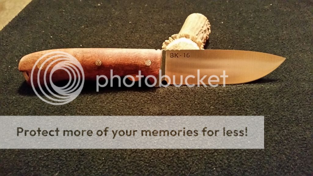

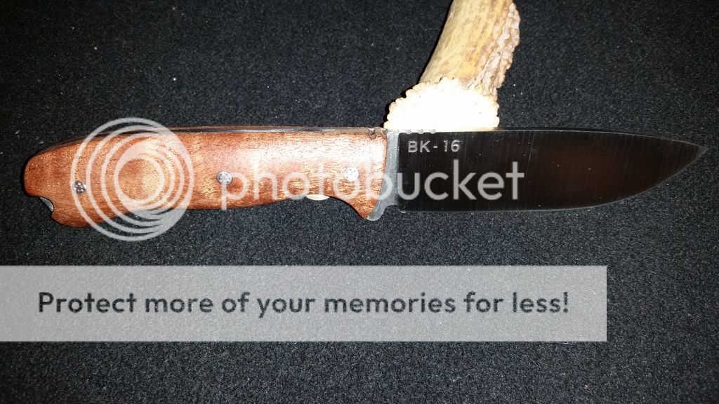

No Busse content, but I only had a Becker that I etched to show.
I did this using an old phone charger with the wires stripped and alligator clamps attached in place of the part that goes into the phone.
My method was as follows:
Hot water and stir and add salt until it doesn't really dissolve any more.
Dip a Q-tip end into the saltwater mix and clamp that into your negative side and while having the positive side attached to bare metal, makesure the clamp is contacting the saltwater soaked tip.
Now start making your passes over your logo.
After a few blottings/passes/dabbings, the Q-tip will be black, use the other side next and just keep going til you have the required depth.
Scrub it as you like, it would only help, but it is not necessary. I did not for the BK-16 shown below.
