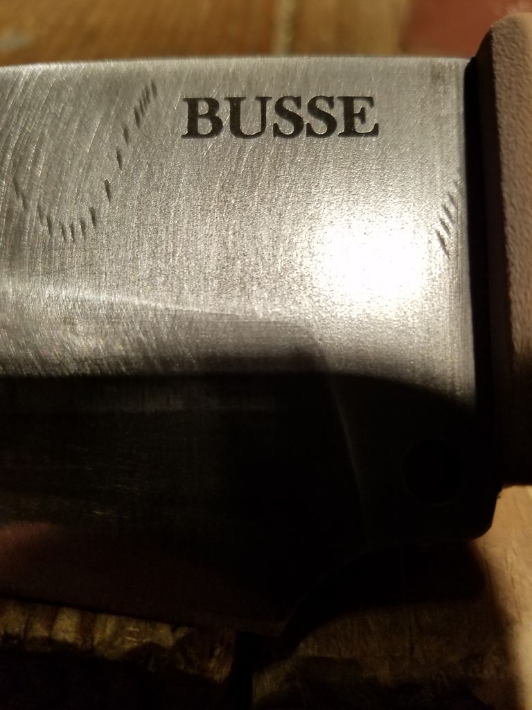

That etching looks awesome!!! Did you use the Q-tip technique recommended in this thread?

That etching looks great. I agree, you got to share on that one. Please. I too am curious about the questions above. That look pro grade.

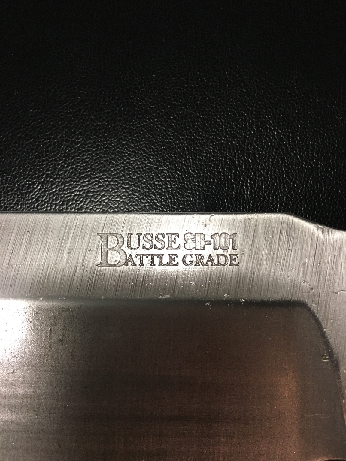

That was with ferric chloride (PCB etchant). I used to use muriatic acid, but it seems to take longer. I really want to try the electrolytic method, guys seem to get great results with it. I just feel like I have more control over the process with an acid. I just blot it on with a q-tip, let it sit till it turns black (seems to vary a bit time wise), scrub it off with a wire brush in a bucket of water, and repeat. And when you think you're deep enough, do it a few more times. Scrubbing it with the brush will show you if you're undercutting the resist.
That etch looks almost factory done. Fine job there, really. Thanks for sharing. I got get some of this stuff.

No problem. On a side note, Infi seems to take a little longer, which makes sense given that it's more corrosion resistant.

Definitely worth taking the time to etch the battle grades. I think the main thing to remember is scrubbing the logo after it turns black. At that point, all of the oxidation has taken place, no more reaction happening. I just use a small, stainless, wire brush.
Wow!! :eek:
I stand corrected. Thought it would come out blurry, but that looks awesome. May have to reconsider.
