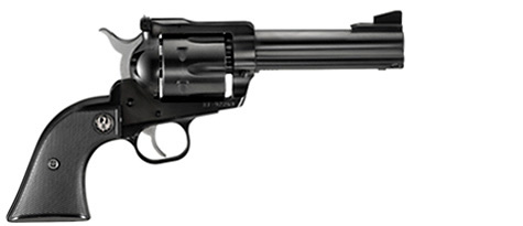

Ok I read your post. Understood most of it I believe. I agree a 44mag is overkill. I also agree a 22lr is great for small game. If you are looking for a lever/revolver mix I believe 357mag/38spl is your best bet. They have the leverevolution rounds that make the 357 able to preform more like a rifle round. Not sure what round it mimics maybe 30-30?? Either way that covers a big game factor then you have 357mag for defense vs big game/2 leg "game" 38+p of the in between and 38 for rabbits and such. It wont mess up the meat that bad (show placement is more a factor) There are also shot shells our there to make your revolver better suited for snakes and birds. If Im way off then get a 22lr all around I hear they can bring down a dear (let the yelling and arguing begin! j/k )
If I was going to get a two gun combo I would go with a Marlin 1894 and a Ruger Blackhawk in .38/357 and work within the limitations.
I'm with NorCal on his recommendation. I think the firearms he recommends are proven commodities offering modern reliability and preformance at a reasonable cost, while also paying due heritage to the area in which you reside.

Now, for a little more unconventional (and still old school, just not quite as old school) combo that would be really cool if you're handloading:
A Ruger Blackhawk in 30 carbine paired with a surplus M1 carbine. Just think about it :D
Brandon
Brandon
I didn't know they made a .30 Carbine Blackhawk. Now I must have one.
