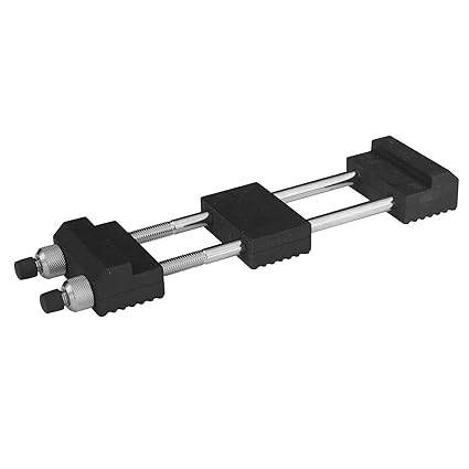

David, the popular generic style stone holder adjusts for length from about 5 or 6 inches to 8" so that's not a big problem. I lay some of my smaller Spyderco Double Stuff and other small hones on the rubber pads of the stone holder without issue. So bear that in mind.

A common stone holder, adjustable for length from 5.5" to 9". The middle section can be moved to accommodate smaller hones.
As I mentioned, I've used it with hones shorter than those used for the Edge Pro. The friction of the rubber alone is sufficient, (for the most part), to hold them in place.
You are misunderstanding his idea. He wants to make a "conversion" unit/holder so that an Edge-Pro sized diamond hone could be placed in a regular stone holder like your picture.
I'm not misunderstanding at all. I'm simply providing him with the image and info to help him plan appropriately either for, or around, the use of the stone holder or other accoutrements.
How well does this holder hold an EP mounted stone for freehand? Does it keep the stone from moving lower as it is used? Both should be easy to prototype and possibly use the same spring loaded locking mechanism. Of course the diamond stones are the top priority.

Without even adjusting the holder to the length of the Edge Pro 600 grit hone, the friction of the rubber on the aluminum backer plate is sufficient to keep it from moving around. By not adjusting the holder smaller, I have access to the end of the hone.
However, if the holder was adjusted to the 6" length, the hone would need to be raised for the ends to be accessible. (1/2" minimum clearance height.)
I don't think I'd personally care to try to wedge the EP stone between the rubber jaws at a sufficiently high clearance height.
It might work, but to me it wouldn't be worth the bother of trying to maintain proper alignment, (front-back, left-right), for both the sharpening and keeping the water on the hone. That's where your proposed cradle would come in very handy.
(I generally have gotten around this by just leaving the ceramic bench stone in the holder with a thin rubber mat on top to hold the small hone.)

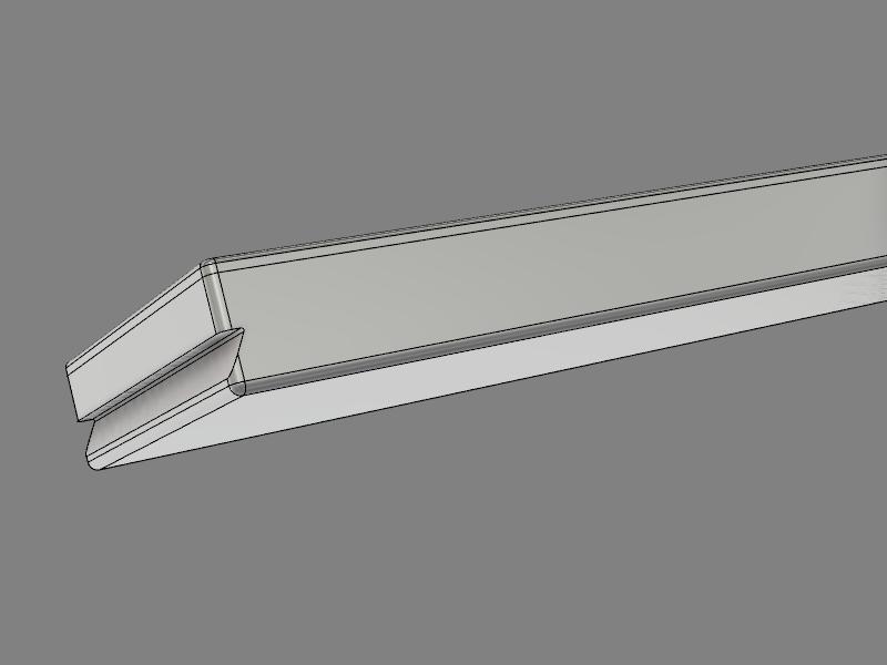

So I am at work today making polishing tape holders for EP, the fun of self employment, and having some ideas. I have no one else to bounce them off so here I am. What if I make stone holders for each size of stone? They would be fully machined aluminum blocks with all edges radiused and then hard anodized, with rubber feet. Think very roughly $35-$65 each. If I am making the stone holders too why not make it so "dovetails" on the stone ends snap into a spring loaded jaw on the stone holder, kind of like EP stones snap into the stone holder on their knife sharpeners? If the holders are heavy enough you could swaps stones with one hand in seconds. These stones will always be expensive, the knives you need them are too, so why not get a really nice stone holder that is designed exactly for your new stones? I would make sure the stones would still work in the stone holder Blues shows above, no reason not to. So, what do you think?

This is what I have so far for how my stones will snap into the stone holders, it is a simple 30 degree dovetail. The top of the dovetail is .25" from the bottom of the stone body so it shouldn't interfere with other stone holders and still work with the 4" stone which won't have as thick of a body. I am thinking the body of the 4" stone should be .35" thick, so far. I am envisioning my stone holders only extending .24" up from the bottom of the stone so they are well out of the way when sharpening. What do you think? Also how do you want the grit ratings set? Microns or mesh?
For reference, this is the 2 x 6 stone that I modeled, with the resin layer on top.
