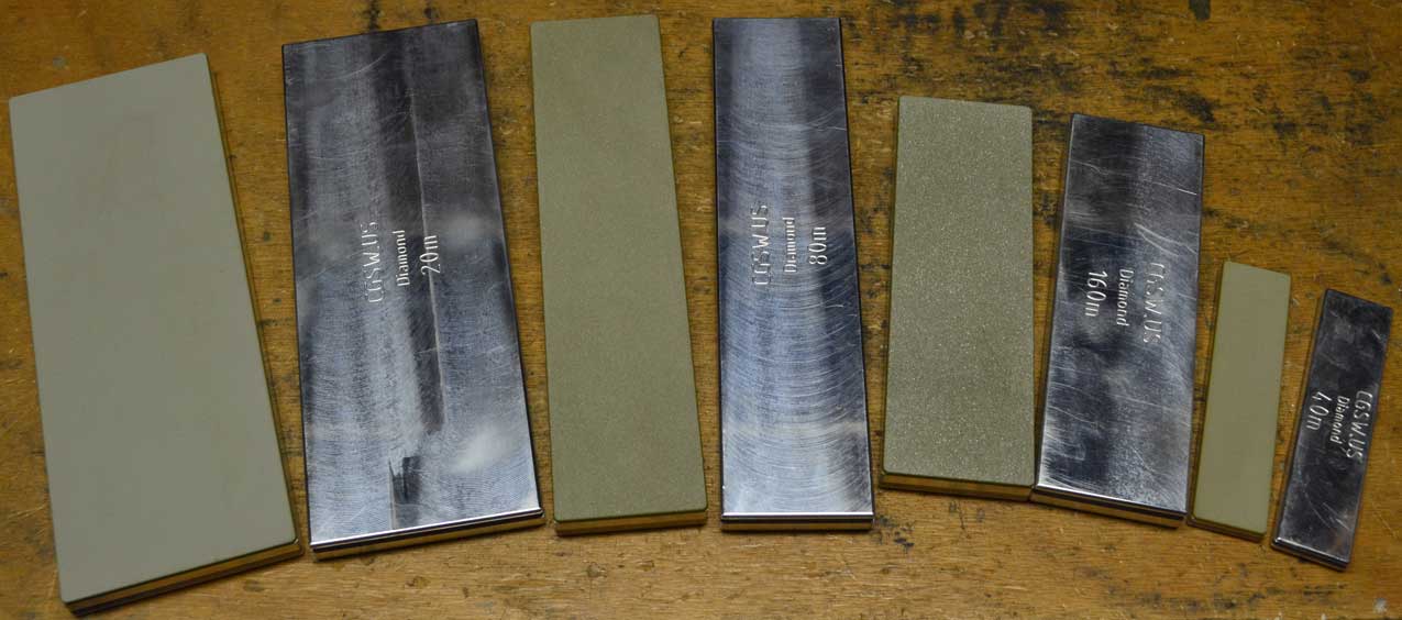

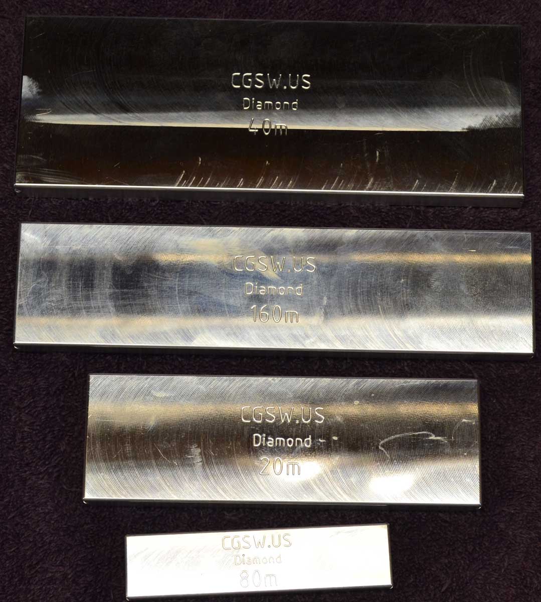

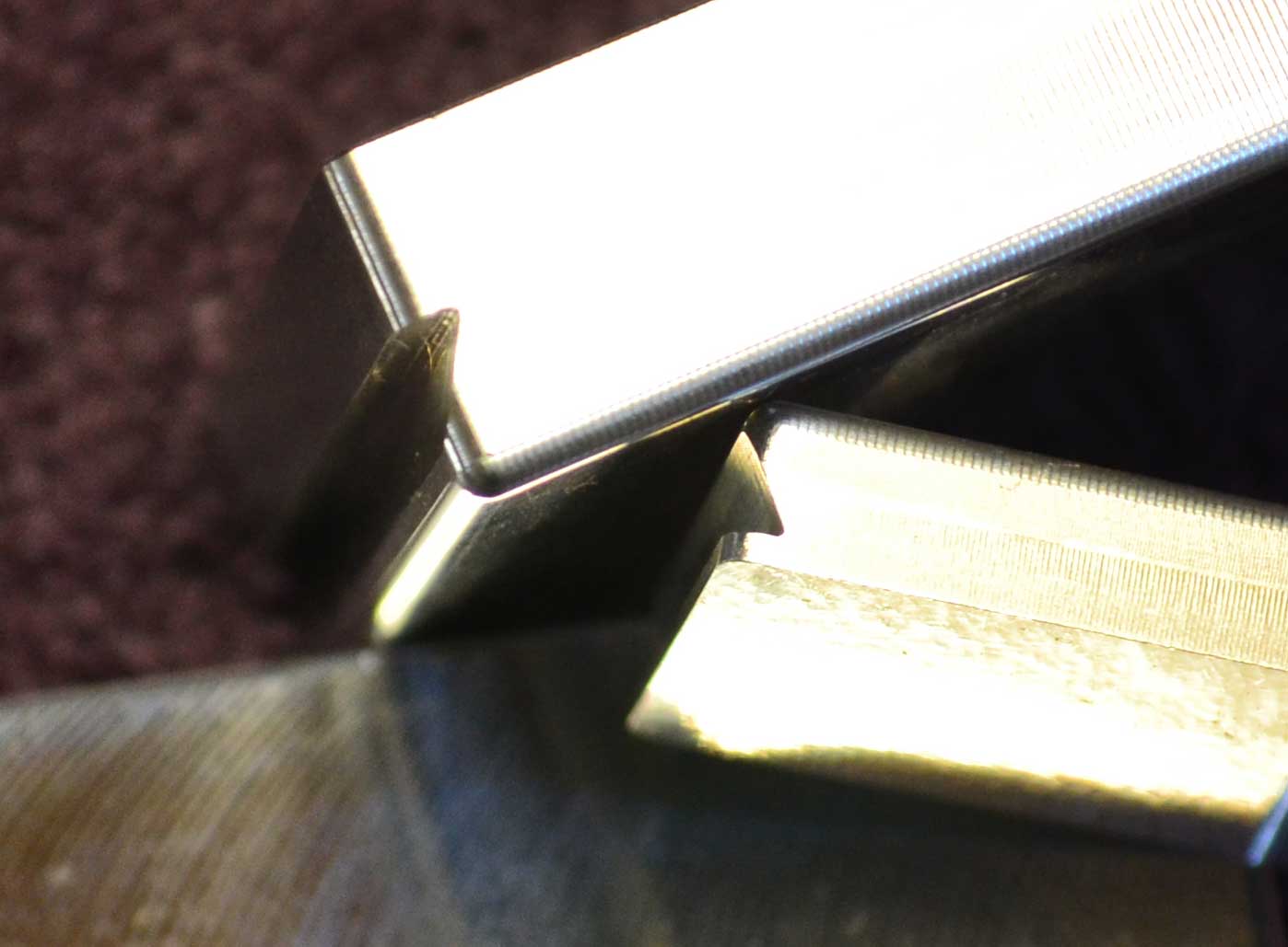

I "think" I will be molding them in the next 2 weeks, but thought the same thing a month ago. If this was a walking journey it would be like walking through sand dunes while getting hit by a car three times, the last time a month ago. The new tooling did pass all tests last Sunday so I shouldn't have any more problems. I have quite a few bodies for all grits in each of the 4 sizes made so all that is left is to mold them and make the website. I purchased the domain name back in June so I knew what to engrave on the bodies but haven't done anything with it yet, so don't bother going there. Here are some photos of the bodies. The undercuts on the ends are for the machined aluminum holders with spring-loaded ends caps that I will be making for them. Not so important for the bigger stones but more so for the 1x4 stones, and a version for EP style mounted stones. Even without the holder the dovetails give your fingers something to grip the 1x4 stones if you like holding them that way, which is the way and size of stone I learned how to sharpen with. Anyway, once I get them done and ready to sell I will announce it here and on my YouTube channel. I won't have the holders ready to sell yet but I will show what prototypes I have made so far, the design hasn't changed much at all so I just need the time to make a small batch to see what everyone thinks.
Sizes are 3x8, 2x8, 2x6, 1/2" thick and 1x4 5/16" thick. Grits are 160, 80, 40, 20, 10, 5 micron. The first, second, and finest are identical to the EP 80, 250, and 4K stones with the middle three slightly adjusted. The resin, diamond concentration, and process are identical to the Matrix stones.

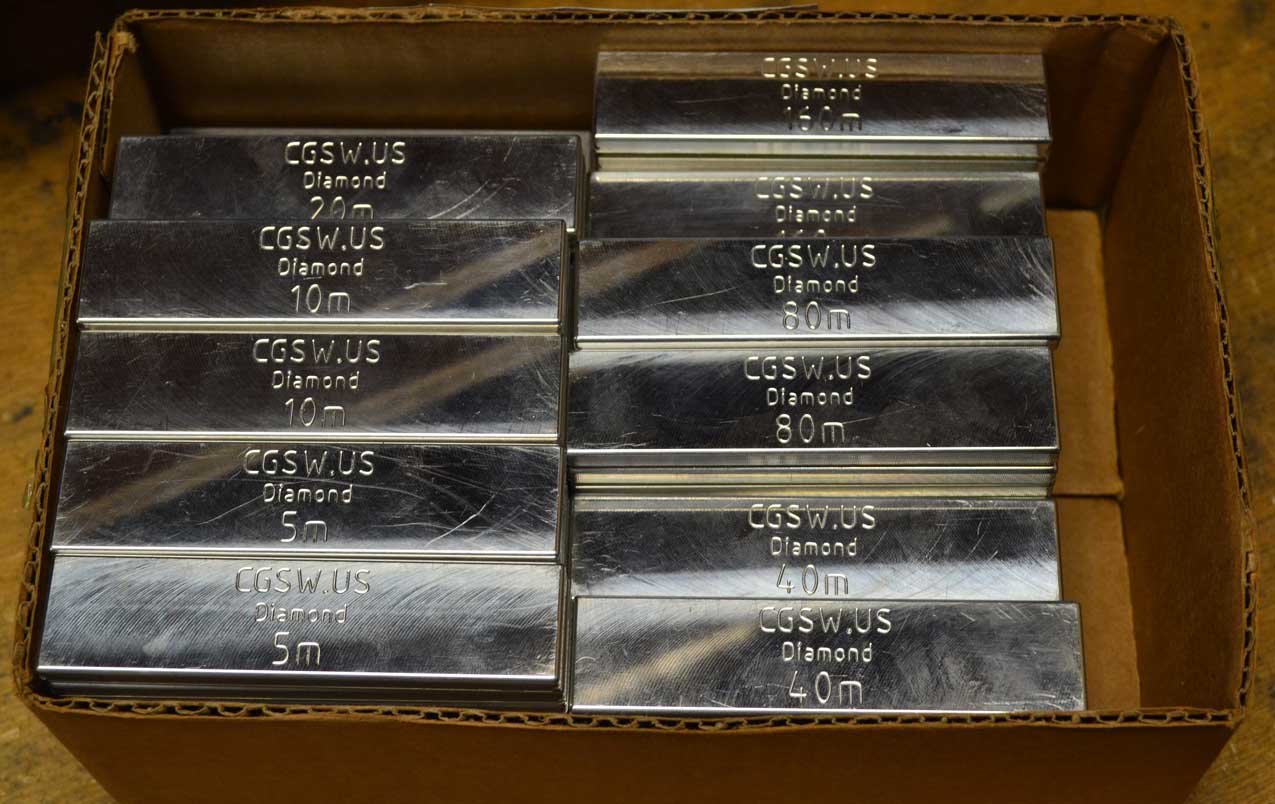

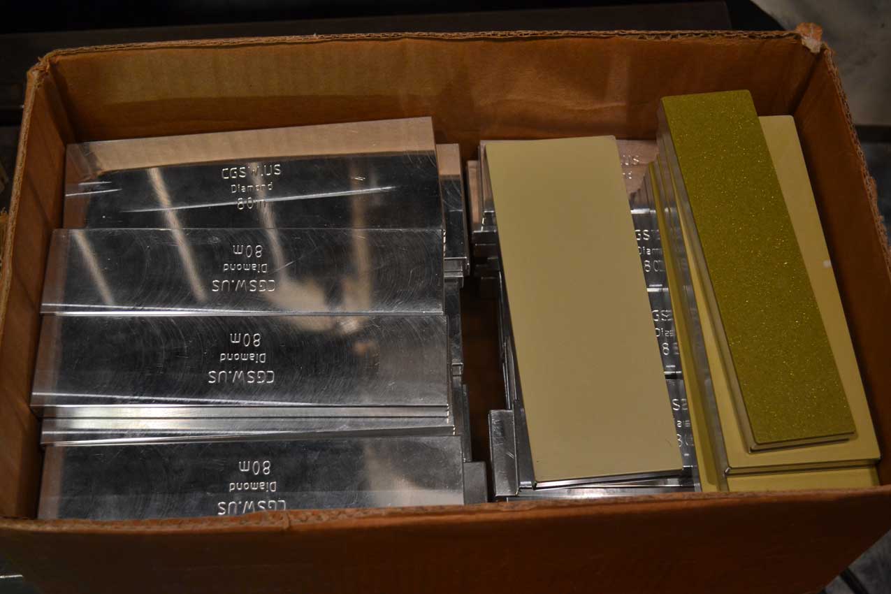

I reached another milestone so an update is warranted, all of the first batch are done and ready to go, which is multiples of 24 different parts. Now I just need to make the website, set up an email account, and get some 240 grit Alox. Here are some photos.
Most of the 2x6 and larger stones.
Most of the 1x4 stones.

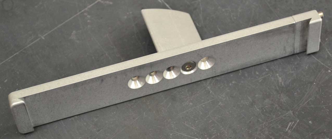

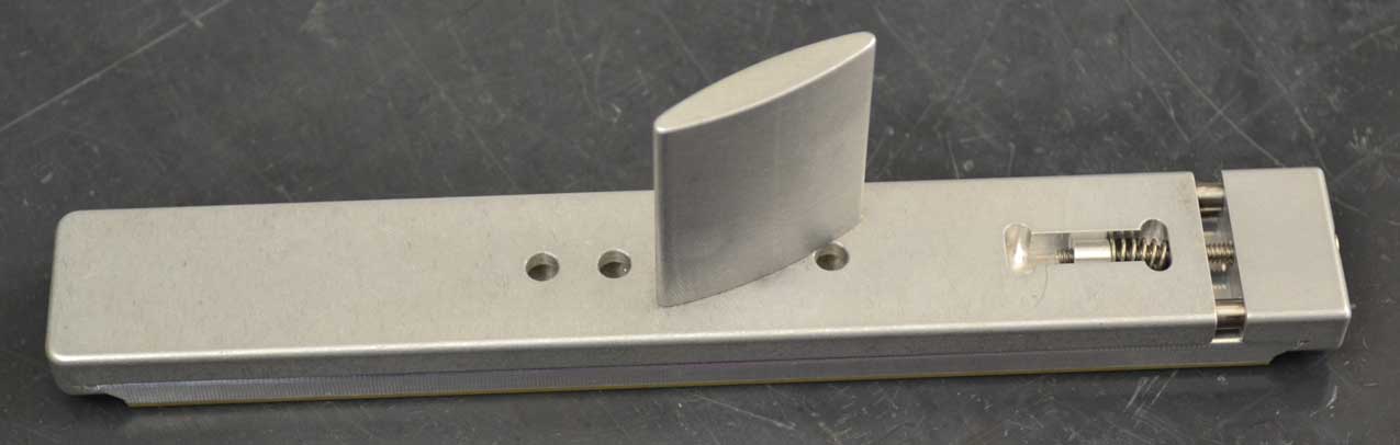

Here is a holder I have been working on. This version is for the EP style blanks but it doesn't change much for my 4" stones. This back burner project will be next to get into production now that the stones are there.
Being a prototype there are extra holes to help figure out what is wanted.
