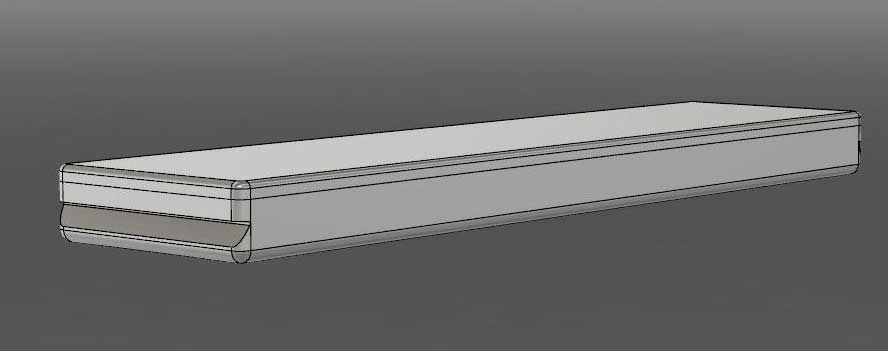

I want to order the materials today so I can pick them up Thursday when I am in Portland so I need to settle on a thickness for the 1 x 4 stone. I am thinking 1/4" looks like it would work out the best, I think 3/8" would be too thick for a pocket stone I would want to carry around. Here is the cad model of what it will look like. The undercuts on the ends will be what the paddle snaps into and would help if you hold it by the ends to sharpen without a paddle handle. This is the one stone that would make sense being double sided, but if it is double sided it would not fit in the paddle holder. If there is enough interest I can make some double sided stones later on, same mold just a different body. The thickness of the stones can easily be changed down the road, only the width and length will be set once the molds are made.
