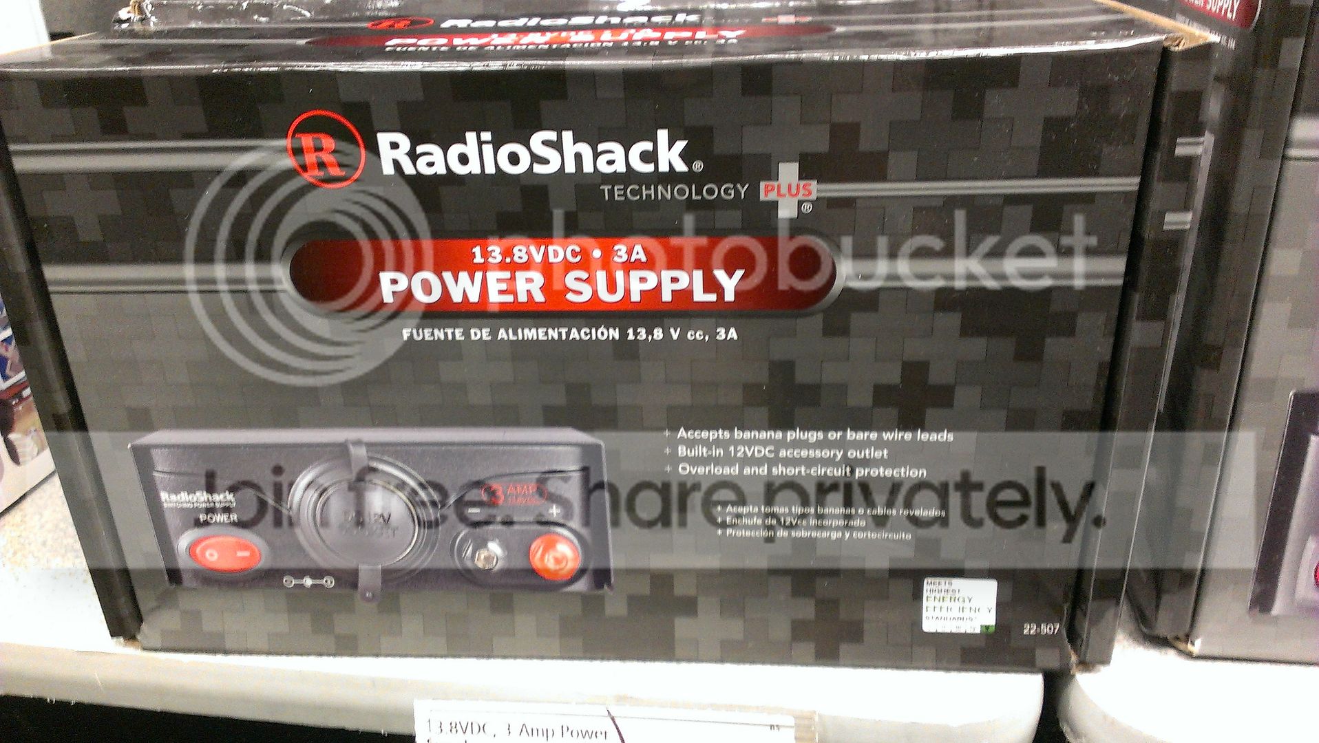

Post # 25 TJ smith=Where is the dimmer switch? On the 120v input or somewhere in the output?
Saw this at radio shack, almost bought it
http://www.knives.mlogiudice.com/kni...er_circuit.pdf
