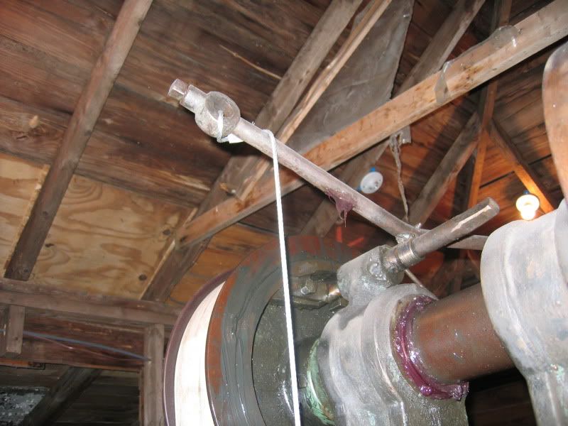

Good evening folks. Well another day at the hammer.
First, more useful information. I was trying to clean out the oiler holes on the ram/plunger. They were really plugged. I discovered that the holes on each side of the center guide on the ram are connected to each other. In other words, you can shove a piece of wire across from one hole and out the other to clean them out. The same is true for the other set of holes in the back of the ram. A piece of wire and then some compressed air down through the top and side to side finishes the job nicely. Watch your eyes though, because alot of stuff can come flying out (that shouldn't be there). If they are cleaned properly, a great deal of air will come out.
I agree this thread is the most information on the web for our hammers. I have decided to document my rebuild by pictures and on this thread. I need to figure out how to make my pictures lower resolution to load some. If anyone has a picture they would like to see, just let me know.
My links and side arms are pretty worn. Some of them probably can't survive another oversized reaming. Sid tells me that the preferred fix is to totally weld the holes shut, bore new holes and use new pins. Makes perfect sense to me. The issue will be cost. I am awaiting his estimate. The problem with bushings is that they can rotate and close off the oil holes. Then the pins will deteriorate from friction, eat up the bushing and the arm will get badly worn.
I decided to give the porta power another try to remove the main shaft but with a different setup. This is the most effective means of removing the shaft I have found yet. My porta power is a 4 ton unit with some of the ends and the extensions just smaller than the hammer main shaft. One of the welders in the shop next door brought a fork lift over and we positioned the hammer by a heavy support pole in my shop. I lined the porta power up carefully with the pole in order to have a straight shot into the rear main shaft housing. I chained the hammer to the pole top and bottom. I then applied some pressure in the shaft housing with the porta power using a v-shaped base on the porta power so it wouldn't slip on the pole. The main shaft was about an inch inside the housing. The hammer started to tip slightly from the top, but the chain stopped it when the chain got tight. (My hammer is bolted on a pallet which gives me more stability.) I then put a 1" round bar in the slot in front of the crank/flywheel and a piece of pipe over that bar and began to turn the crank/flywheel back and forth some. The turning freed the shaft enough to allow the porta power to push it out a little at a time. The shaft would move about 1/8" and I would pump the porta power a little more (1/2-3/4 stroke) and turn the shaft some more. I did this over and over. The shaft is now out about 4.5 inches out in the front behind the crank/flywheel.
I have secured the flywheel to keep it from falling by removing the set screw in the face of it and passing wire through it many times to make a loop and then chaining that loop to a beam in the ceiling (cable would be better to use and I may do that). Luckily, that set screw goes all the way through the flywheel. The drive pulley is secured by a combination of chain and duct tape!!!!!!!, since there is no hole through it. I will be watching carefully when the shaft allows the drive pulley to come out. The drive pulley has already come free from the main shaft. Apparently, it is on the wide part of the main shaft, and the amount I have moved the shaft is enough that the drive pulley is now resting on the smaller rear portion of the main shaft.
