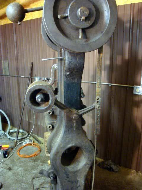

Mike, actually me and my buddy Mitch did all the work for the clutch and brake. If you look at picture 3 we put the wire linkage further up on the angle iron to provide more play in the idler pulley with the same amount of movement on the treadle. So not completely cobbled. :p hehehe

More work on the hammer rebuild today.
Useful information: 1) The set screw holes into the main shaft bushing go all the way through the bushing and to the main shaft. The set screw could be removed temporarily and the main shaft lubricated through these holes as well as the oil holes. It seems dangerous to the shaft for the design to allow those set screws to go all the way through, but the holes do. 2) The bushings for the main shaft have grooves in them spreading to the front and to the back each way from the oil holes in an attempt to spread the oil. They are low on the bushing though, since the oil holes go down at an angle. Mine are totally impacted with hard oil/dirt. The oil would tend to pool in the bottom of the bushing, even if they are not clogged. 3) The key on the flywheel/crank is definitely larger on the front than in the back, meaning that the key must be punched out from the back of the flywheel/crank after the main shaft has been removed or at least pressed out a distance. 4) There are two holes in the brake ring that are apparently designed to oil the brake ring. They are in the bottom of the ring on the hub at about 5 and 7 o'clock. They are easily plugged and concealed by dirt. Oil is necessary, since the brake ring and drive pulley is just a metal-on-metal contact when the brake is applied. 5) The drive pulley is keyed to the main shaft. There are 4 set screws holding the main shaft to the drive pulley. Two of those screws, one on each side of the pulley, exert pressure directly on the key and the other two hit the shaft itself.
Well, I finally was able to get the main shaft out today. Using the porta power straight through the back on the end of the main shaft, while rotating the flywheel/crank to free the shaft, is definitely the best way I have found. I kept squirting lubricant through the oil holes, the set screw hole and every crack I could find. After the shaft moved out about 6 inches, it became free. I would guess the flywheel and main shaft weigh about 100 pounds and the drive pulley is not far from that by itself. The shaft is worn and scoured, and so are the bushings. I assume most of the problem is a lack of lubrication coupled with the open oil holes allowing dirt into the shaft/bushing area.

I'd really like to see pics of this whole set up from your post... 1) The set screw holes into the main shaft bushing go all the way through the bushing and to the main shaft. The set screw could be removed temporarily and the main shaft lubricated through these holes as well as the oil holes. It seems dangerous to the shaft for the design to allow those set screws to go all the way through, but the holes do. 2) The bushings for the main shaft have grooves in them spreading to the front and to the back each way from the oil holes in an attempt to spread the oil. They are low on the bushing though, since the oil holes go down at an angle.
Asking because it doesn't sound like what Bruce and I are used to on our 50#'s. On mine (rear drive pulley), there are angled set screws keeping the bushings from turning and threaded holes (1/2" fine, if I'm remembering right) for grease cups on top of the bushing journels. Our hammer didn't have grease cups so I drilled a hole through a 1" bolt and fit a grease zerk in it. Could use a longer bolt but would need a lock nut on it to keep it from moving down to the bushing. Other grease zerks on our machine are idler nose and pitman arm.

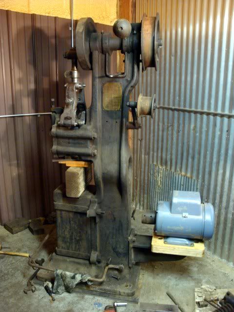

Pixor time!
Mike's hammer.

The jackshaft-type mount on our hammer has feet near the four mounting bolts. They are a work-around for the hammer frame not being flat/square. Shims can be placed under the feet to align the motor-shaft/jackshaft shaft with the hammer shaft. You may know this, but... flat belt pulleys (those without flanges) need to run parallel, or nearly so, to keep the belt on. In the pics of our hammer, the motor pulley's Z axis and the hammer shaft Z axis have been shimmed parallel. The reason being, a flat belt will walk off the closer ends of flange-less pulleys that are out of parallel very much.
Another thing about flat belt pulleys... the crown is 1/8" in 12" for almost all types, with some (not on these hammers) being a little more than that. They need to be at least 1" to 2" longer than the belt is wide.
It's probably obvious, but belt width less than spec (2 1/2" on a 50#), like 2 1/8" for example, gives up 17% of surface area. The motor in the picture is an 1140rpm Baldor 3hp. The original rpm for the hammer is 900rpm, with an original driving pulley diameter spec. of 5". By putting a 4" flat belt pulley on the 1140rpm motor, the 375 beats-per-minute 50# spec. is met... but with a loss of about 25% of belt-on-driving-pulley square inches. For a machine specifically designed to clutch through a slipping belt, the amount of belt surface area on both pulleys will have an effect on hammer function.

If you look at the picture of our hammer, the one showing the drive pulley, you'll see the gib key and bolts holding the drive pulley on. I'm figuring you are going to need both. The gib key is going to have to fit right... just short of an interference fit on the sides.
