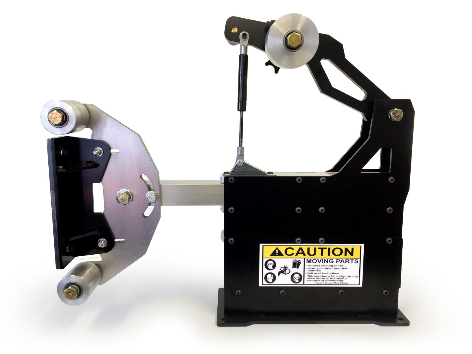

Looking to start dabbling in knifemaking
That motor is base mount. It would work for a kmg, but the OBM is c-face mount iirc.
Actually, the motor mounts completely independent of the grinder. A base mount is what is needed.
As for drive wheels, most "standard" drive wheels are between 4" and 5" diameter with a 5/8" bore, though I think OBM and VWJackStraw both offer a 7/8" bore as well. 3HP will work, though Personally I don't think you'll ever need more than 2hp. Heck, even 1.5hp for a direct drive setup is probably more than most guys would bog down.

So Im looking for a VFD and what I need I think (im an idiot when it comes to this stuff) would be something with an input of 110ish and output of 220Vish If i'm using standard US electrical outlets correct?
something like this but in a 1.5-2 HP power?

Those TECO drives are good drives, but the one you linked to is only a 1hp, and will not run a 1.5hp motor. You can run a motor that's equal or less than the rated VFD power, but not the other way around. In other words, a larger VFD is ok, a larger motor is not.
You might look at the "eBay specials" for something like this: http://www.ebay.com/itm/1-5KW-2hp-7...386082?hash=item541689dae2:g:XJ8AAOSw0vBUkjm0
The nice thing about that one is the speed knob that's a little easier to control without holding buttons down. Keep in mind, the cheaper vfds (including the TECOs are open frame, so they need to be in a seperate dust proof enclosure, or wrapped with filter paper or something so that they're kept clean and all the metal dust stays out.
If you want a single phase 110vac in, 220vac 3ph out, then you may have to look at something like a kbac-27d, or something similarly a little pricier. 110VAC input can get you up to 1.5hp on SOME drives. Most of the cheaper drives are either 1hp for 110vac input, or shoot right up to 2hp at a 220vac input, or at least as far as I've seen recently. Somebody feel free to correct me if I'm wrong.
If you can run a 220VAC circuit, you'll have some better options on lower cost, higher power vfds.

You don't need a 220v circuit the 110v is fine to run a VFD 3phase system....however the VFD is the key component to get max hp from the motor. A 2hp MINIMUM rated VFD is required to NET 1-1/2hp from a rated 2hp motor on a 110v circuit.
The 1hp rated system is just going to cause frustration when you start grinding and see how easy it stalls and you take hours to grind instead of minutes. I have 1hp VFD's on disc grinders and I can stall them when I get in a rush and start hogging material.

Hmmm... I spent quit a long time looking for a VFD that was 110v IN and 220V out that was over 1HP and could not find anything. Not a cursory search but spend about 2 hours surfing different websites, ebay, and amazon.
Well the problem is the VFD HP ratings. This is the BEST unit on the market unfortunately also the highest priced. These are all I run in my shop A++++
http://www.electricmotorwholesale.com/9520-KBAC-27D/
I did actually see that unit, so that would push a 2HP motor at around 1.5HP? Looks like it is the only option so I can bite the bullet and pick it up along with a 2HP Motor... Blows over the budget though...and I ran out of knives to sell :(

Yeah I understand blowing the budget....do it all the time myself...The GOOD News is if you ever have 220v single phase available in the future you're all set just requires an internal jumper wire switch and Bada Boom 2hp Of Steel Hogging Grinder Power!!!
