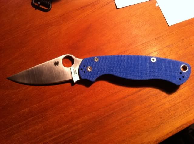

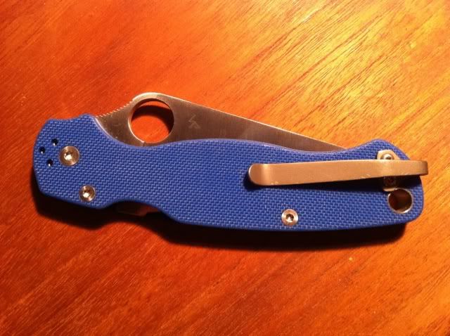

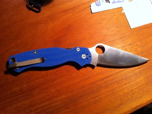

Mine showed up tonight after being "Out for delivery" for 3 days. I agree with everybody on it's fit and finish. This one actually feels a lot nicer than my plain black one which had a weird grind spot on the right side of the blade and a sticky lock. This one is smooth as butter and the finish is perfect. It's going to enjoy being put to work tomorrow!

gosh darnit mine came today (a day late mind you) and it has a sticky lock and isnt that smooth i was sorta expecting depressing the lock and the blade swings free but that hasn't happened in the 500-750+ openings of it since 2:30 pm today and the grind is inconsistent the back part of the edge is amazingly sharp hair popping in fact but near the tip it wont even shave arm hair also when the blade is closed where the tang and choil bud up to each other is not flush( although this is the first para 2 i have held so idk if this is par for the course)
its a bit disappointing to be honest
its not to where it takes 2 hands to close it but its pretty bad if i do more than thumb it open it sticks :(
additionally fit and finish are ok meh to be precise machining is quite rough ex: on the lockface and lock area it looks like their bit on the cnc or whatever they were using was dulling and it gets worse on the liners where the lockbar is
however the lockup is solid and centering is perfect
idk i have emailed cust service and am waiting for a reply
am i being too harsh cause i dont think i am i mean if not for the sticky lock i could get over everything else but i hate lock stick
That's about normal for a Spyderco IMO. Normally on a para 2 if the blade settings freely with the lock depressed it will have some side to side play, in my experience anyway.
Is that an STR deep carry clip?

Another possibility...the P2 is very sensitive to adjustments in how tight the screws holding the stop pin are. I have had to go back and forth adjusting the pivot screws and stop pin screws on most of my P2s to get the blade motion adjusted to my preferences.
On some Para2s and Manix 2s people have had to take the pivot bushing out and gently file one of the sides down to remove the blade play. I personally never tried it but it seemed to work for a lot of people.

My blue m390 had sticky lock up too. I could not swing it open at all. I just loosened the pivot screw and tightened it again and it works very smoothly now.
