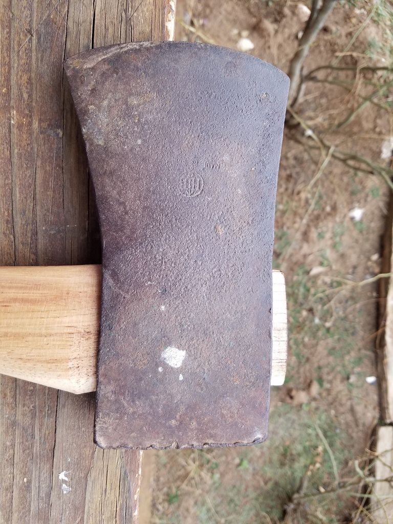

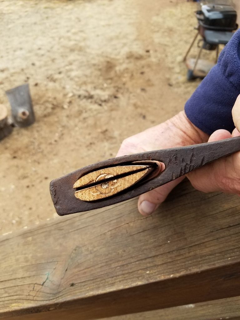

A side shot would help, if possible. It may just be a case of needing to rasp the shoulders down, and as the head seats lower, it may shift back in the direction of the poll as post handles extend fairly far in that area. If that's the case, the head will shift back, helping to fill the eye, and you may just need a supplemental wedge or partial wedges to fill the top of the eye (as the bottom of the eye would be filled).
It could shift back some ;)
It might be that your fullsized vintage Swedish axe head has a larger eye than what we see in our American axes?
Many Euro axe heads were eye sized for use with European Birch and Beech, and it looks like you might have one of those! And you do run out of fitting shortcuts and inventiveness when a darn 'domestic made' (ie n. American spec) handle is too small to begin with.
The eye measures 2 3/4" X 1". I'll get you a side photo posted in a few. DM
This is it. A standard American full size axe handle is 13/16" x 2-7/16", taking advantage of the strength of American Hickory. Not having Hickory, Europeans had to use weaker Ash, Birch, Beech, etc. The weaker woods needed more material to have adequate strength - hence larger eye size.
Ok, I understand. Thanks gents. This handle and the double bit style was all they had. Now, I have to return it and ask about a special order handle. One that will fit the Bruks Swedish head. If they can't order one then I'll look on line or drive 130 miles to a larger city and try to find one. What a pain, time and money. I best get 2 once I find it. Shucks! I suppose this spare axe is worth it as so many on this Forum speak highly of it. Yes, I'll be mostly spliting with it. Some limb work too. DM
