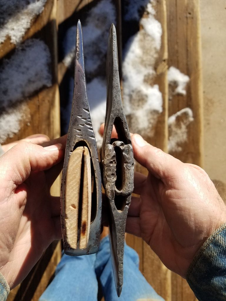

I measured the thickness of the Kelly double bit metal handle axe and it's 1" . No more at any place. The Hults Bruks is 1 5/16" at the middle of it's eye and mostly keeps this all the way to the hammer head. Will this make it a better splitter? Thanks, DM
Yeah exactly. Of course there are a number of variables but I'm sure you can imagine that a more obtuse wedge will split much better than a more acute wedge ... at least to a point. My feeling with mauls is that they seem to be just a little too obtuse for my taste or the wood I split (but of course they can be profiled to taste). Splitting axes are somewhere in the middle - lighter weight, more acute than a maul, but heavier and more obtuse than a traditional felling axe. The bit and cheeks thickness matters too, as well as the weight. You can get yourself a 4 or 5lb axe which might appeal to you too. You can profile the edge itself more obtusely ... lots of different approaches that all might help. Axes are obviously pretty handy for splitting but generally speaking, they weren't intended for serious splitting and it's not unusual in the 3-1/2lb range to find pretty thin bit axes that are really strict cutting tools.
Yes, I think that's the difference between my Kelly and this Hults Bruk axe. My double bit Kelly is of the thinner profile. A good chopper and for limb work. Whereas the Burk looks to be better for splitting. Which is exactly what I needed as 80% of my axe work is splitting. I'll enjoy discovering the differences. DM
Here's a photo of the profile of the 2 axes, Kelly axe on my right and the Hults Bruk. The Hults looks to have a better splitting profile than the Kelly. DM

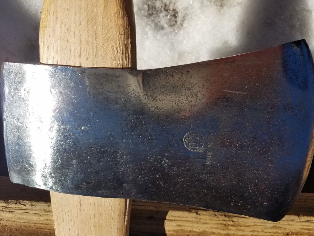

I got the handle all 'slathered' in and the epoxy is drying. Took me 3 hours not counting sanding and polishing on the Hults Bruk head. It needed it. I bought it from a neighbor and don't know how many years it sat around his shop. Plus, I have another hour and a half drive and shop time to get it. Not counting the first one being wrong. Now an over night wait for drying.
So, more than a half day and overnight wait and 20$. If it lasts this season I'll be happy. And I'm hoping it splits better than my Kelly. I've never owned 3 axes. DM
Ok, today I sharpen this axe up to 500 grit on a Norton India. It took this edge well. Then I went and split a large, heaping wheelbarrow load of oak with it. My thoughts:
1) I can swing it to a higher speed because it's lighter.
2) With most of the weight being forward this helps to drive it deeper.
3) It's polished and this has a play in deeper penetration and being able to work it out of the wood easier.
4) A wider axe so this helps to split open cracks better.
5) Minimal vibration. An item I was shocked about.
6) Less fatigue.
The down side is 4 1/2 hrs. work plus having to let it dry over night. And 20$ cost in materials. Should it last me 1 year-- just 2 seasons I'll count it breaking even.
Should it last over that I'll count it coming out ahead. DM
