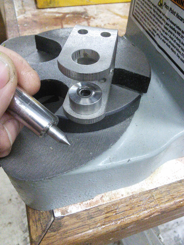

I wonder if your die (tandy?) Is more prone to splitting?
I used to hammer mine, but I broke down and bought a press.
I believe last time I bought the eyelets was from DIY holster supply.
.322" tall.
I like .062" thick kydex for knife sheaths
I have an Italian Twist Press No. 3. It's practically brand new. I probably haven't set more than 30 eyelets with it so far because I rarely need to. The only time I need eyelets in leather sheaths and holsters is to attach a belt clip or for a lanyard hole. Recently I have been making leather sheaths with belt slots cut into the leather. And I just recently got into making kydex sheaths.
So even though I've owned the press for years, it's practically brand new. When I'm not using the press, I keep the inserts oiled up and in their own plastic baggies. So, there is no rust on any of them at all.
.322" tall.
Man, those are expensive and so is the shipping! Anyway, I just ordered 100 of them. If they work great and don't split, they will be worth it.
