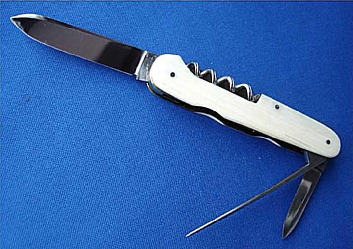

Here's another ivory scaled knife, a gents utility ?, marked G IBBERSON & CO, SHEFFIELD, ENGLAND, made in 1930, measures 4" closed, it has hand forged carbon blades, crocus polished.
This knife was made by Ibberson's premier craftsman (double ended cutler) Ted (Edward) Osborne. Ted was one of the most accomplished later Sheffield cutlers, he made many complex very fine knives, he even made a special gold presentation knife for HM the Queen in 1952. Ted usually marked his initials and date inside the web of the knife (EO-year).
Thanks for looking..Mick
Wow! Very cool knife. Would Mr Osbourne have made this knife from start to finish? I understand from past posts that most of the knives made in Sheffield would have gone through many "hands" before completion. Each person being a master at his or her specialty.
Ken
Hi Ken,
No Ted would have been provided with the parts, his job would be to assemble all, to a very high standard, before passing the knives on to the buffer girls to finish and pack.
Ted Osborne did design many of the later Ibberson patterns, the Royalty sets, 3 and 5 pc lobsters, smokers knives with 8 blades, 4 & 8 bladed fisherman's knives etc, an extremely skilled man.
Ibberson's was a relatively small firm, it still had it's own forgers, grinders, harder and temperer's, scale cutters and so on.

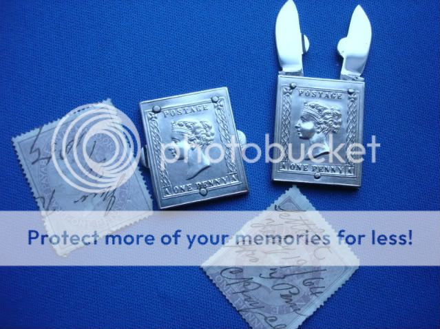

These knives, again made by Ted Osborne date from 1940 (a little late for this thread, sorry), they show the sort of thing Ted made, these are Penny Black Centenary 2 blade lobsters. (very rare)
Mick
A real treat to see some of your fantastic collection Mick. The stamp knives are most unusual. Thanks very much for sharing them with us.

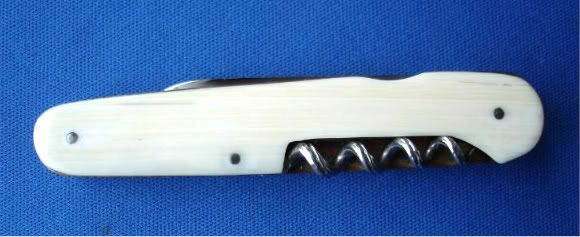

Looking at the Gent's Utility? I was wondering about the cork screw?, Is this one a twisted wire construction? Was wondering what style of corkscrew was favored by the Sheffield maker's during the "golden age" .

To answer Ken's question from a few posts ago if I may. The corkscrew on Mick's knife is a twisted wire variety. That particular example is grooved or 'fluted' which theoretically eases the insertion of the worm. The other main type of construction involves cutting the worm out of a solid steel rod using a lathe. It seems to me that the wire type is more commonly used on old Sheffield pocket knives.
