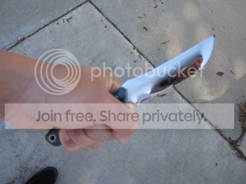

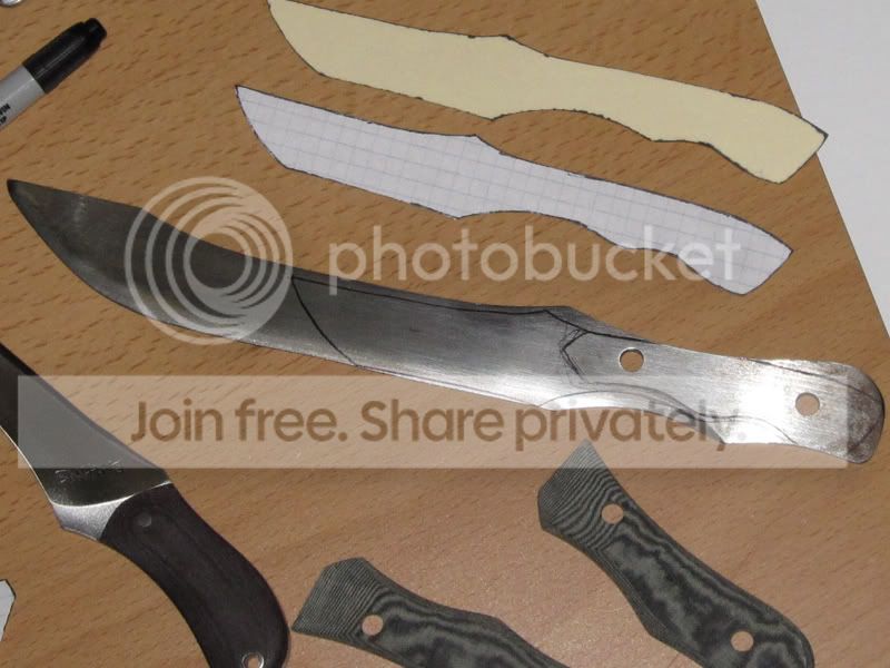

It started out life as a piece of beat up, neglected, and ugly O1 steel.
then...
NOW!

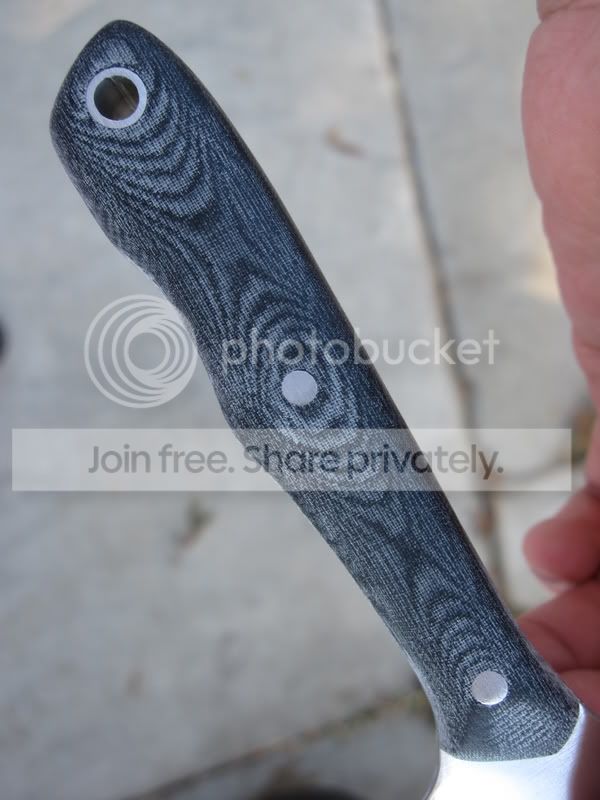

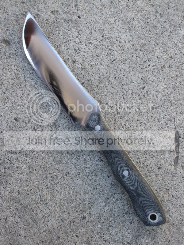

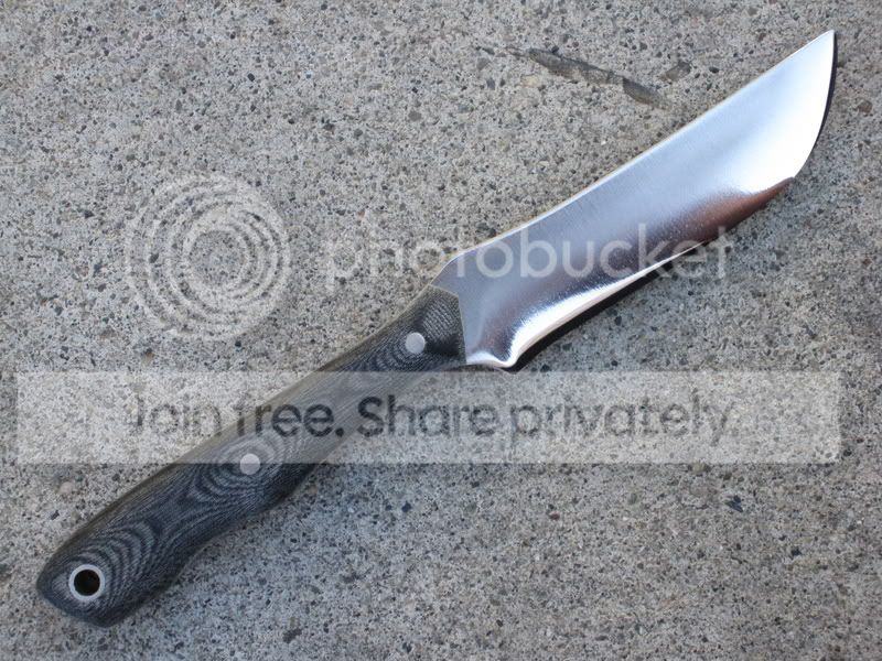

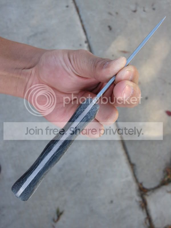

The edge is insanely sharp, the black linen is beautiful, and Ban's trademark Frosty finish is gorgeous! The handles are a little narrow towards the front because the starting piece was already screwed up so I had to work with what I had. Now it needs a some nice leather to go with it. It's going to be a user so we'll see how it stands up, I'll keep everyone updated.
I'd like to say a huge thanks to frogfish for helping me with the heat treat and putting up with my phone calls to make sure I wasn't screwing up the temper. It was really cool checking out his forging shop and all his equipment. It was really well organized too!
And I'd like to thank Ban for helping me out every step of the way. I left the knife in his hands overnight before we got started on the handles and he said he couldn't stand the scratches and surprised me with his trademark frosty finish the next day! Knife making takes some serious skills and Ban's got it. I have no doubt in my mind that he's going to be one of the top custom knife makers. You guys better keep an eye on him. ;)
