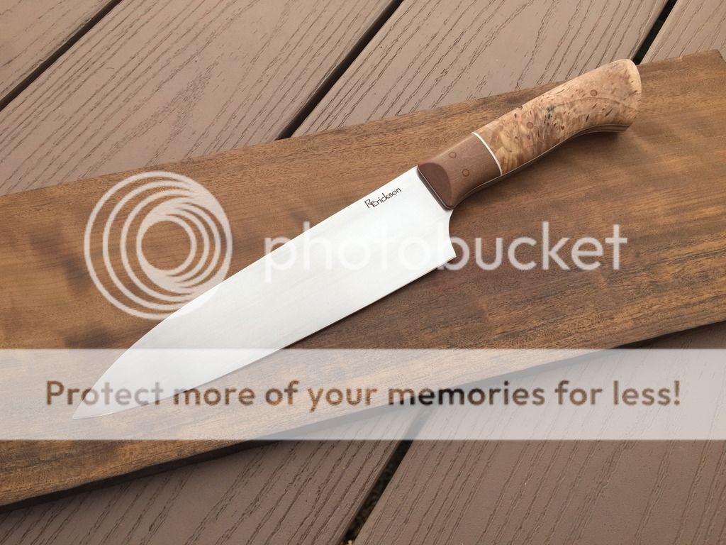

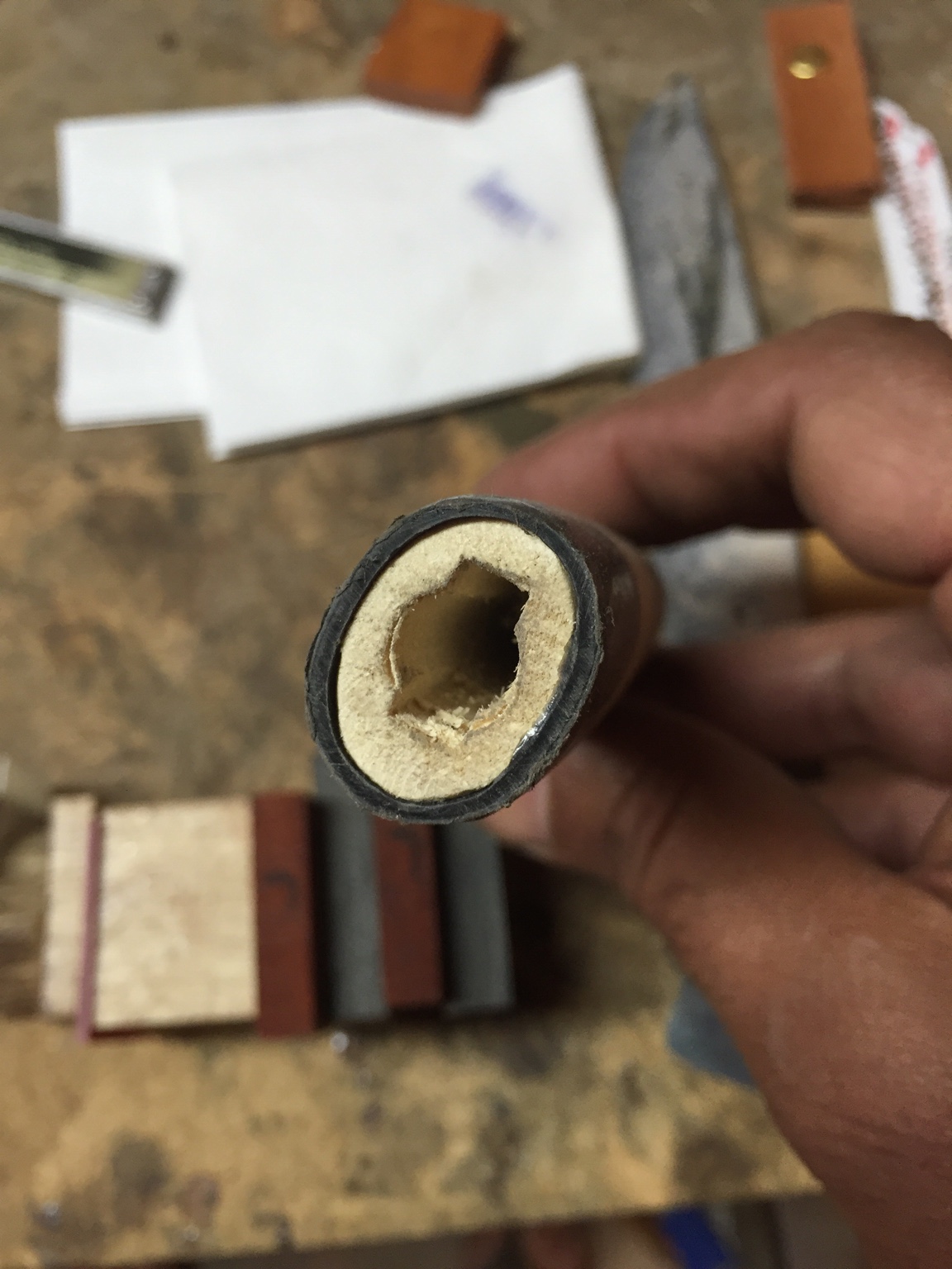

Oh I didn't know that about the sawdust mixture. The pre made ones I have look like this. Pre drilled and slotted ready to fill with epoxy. On these u Can also burn in the tang for a solid fit depending on how u cut ur tang etc.
