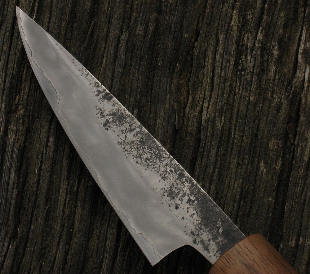

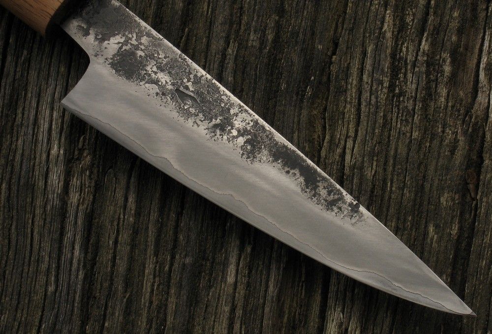

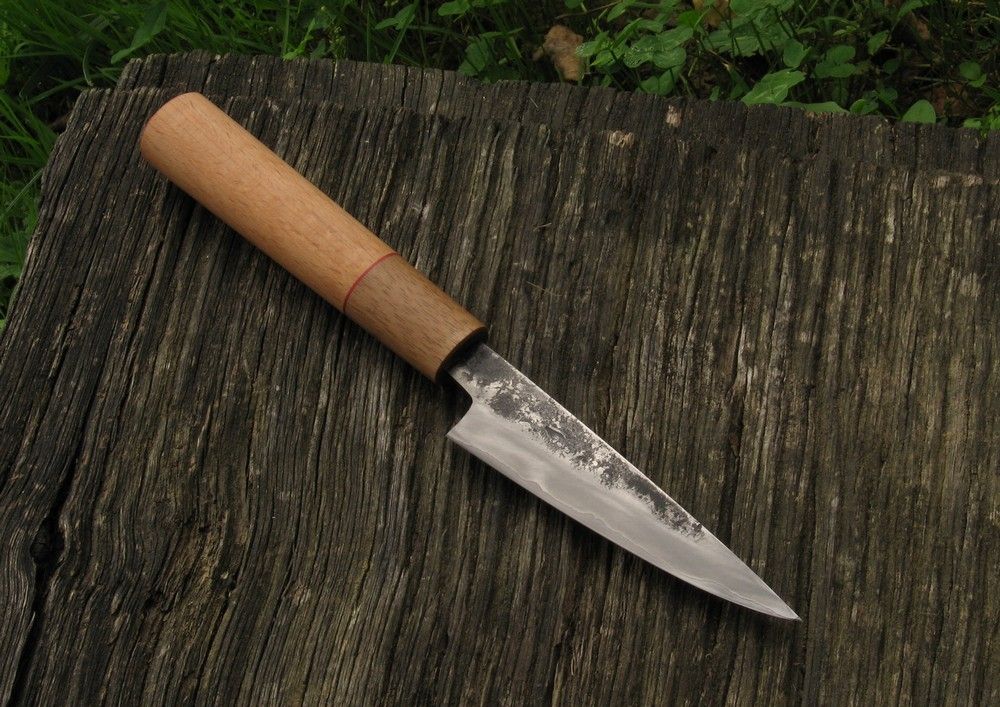

Just finished this little SS paring knife.
Bevels are done with 800 stone then short dipping in acid to darken central steel and buffed without polishing compound. I really like how surface turned out.

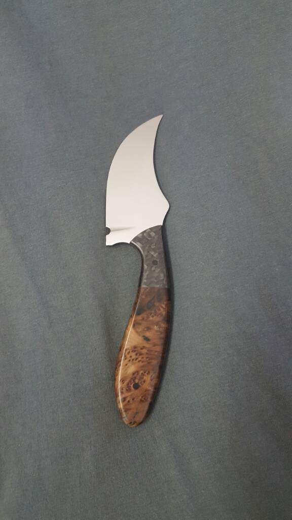

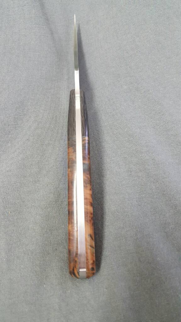

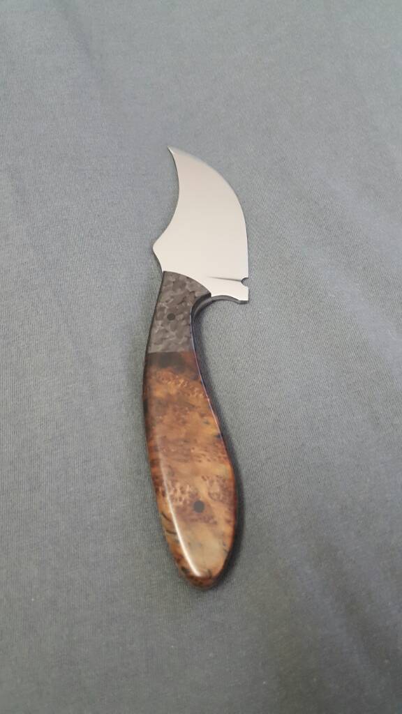

Very nice Karlo! I just finished this skinner for a customer today. I drew this up a while back and I've really been looking forward to seeing it done. I think I'll make a few more of these. .130" aeb-l, redwood burl, and carbon fiber.

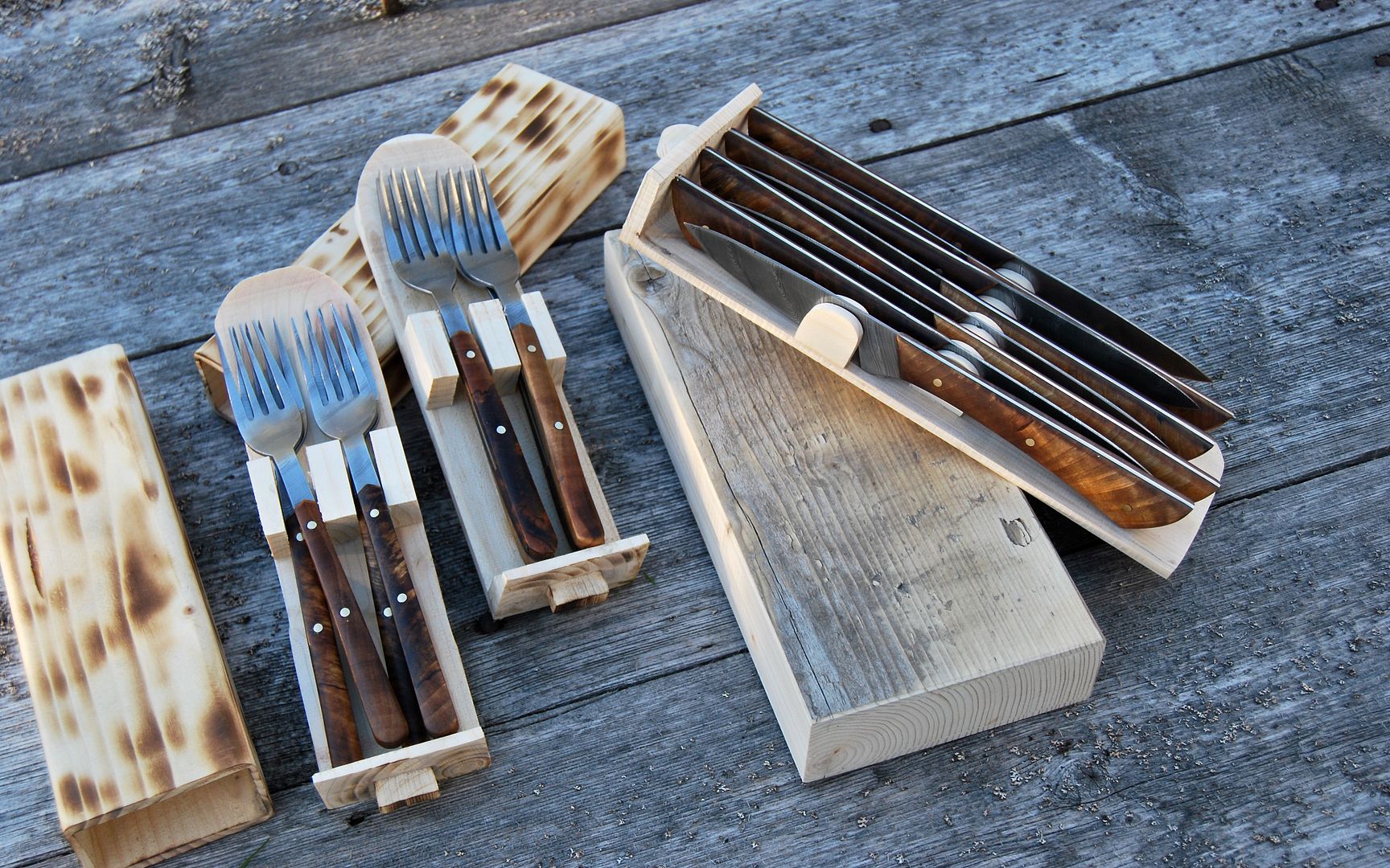

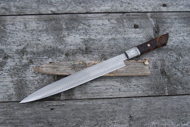

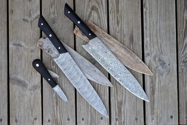

Hello is a Swedish knife makers that make little chef knives and cutlery, so I show some Alste I made. working in Damasteel and arm local materials mostly birch burl and little mammoth and walrus. please take a look.

You are too kind. I'm just getting the hang of this, finally making tools that feel more like an extension of the hand. Your knives look really well made. One suggestion I have for you is less belly, and less handle drop for kitchen knives, but those features are great for skinners. :thumbup:

I really like that! Great profile and finish. That just speaks to me.
You are too kind. I'm just getting the hang of this, finally making tools that feel more like an extension of the hand. Your knives look really well made. One suggestion I have for you is less belly, and less handle drop for kitchen knives, but those features are great for skinners. [emoji106]
I appreciate that. I'll take all the advice I can get!
