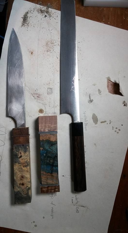

Not finished yet but here is a suji that will be rehandled and a custom petty in w2 and buckeye burl. Ironwood and black/copper fittings. I may use a little thinner ironwood for an endcap not sure yet.

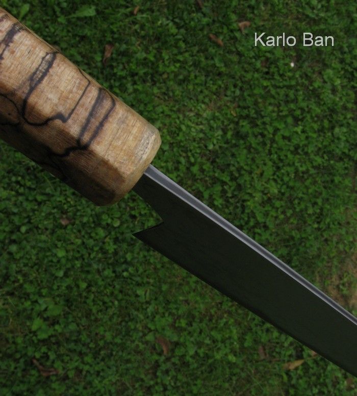

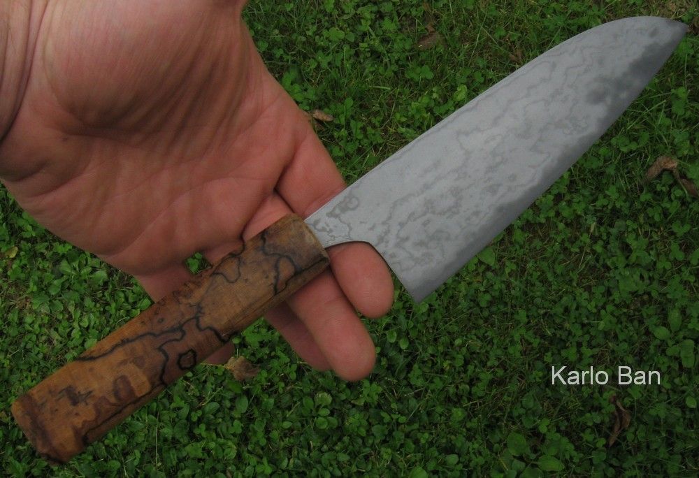

Here is my last one. White #2 and suminagashi.
Blade and wood have very similar pattern… totally accidentally and nice.
Hope you like it.

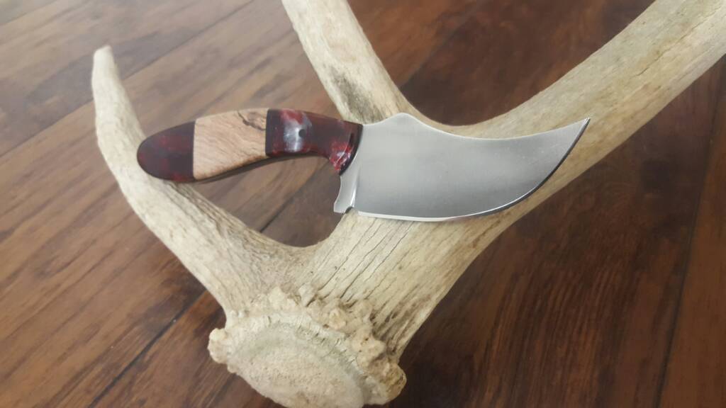

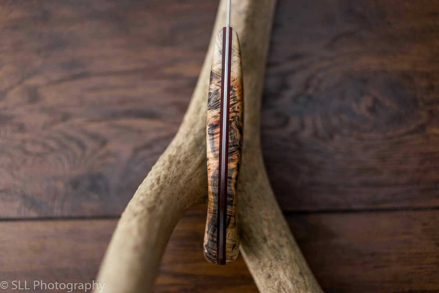

Finished this skinner the other day.
.130" aeb-l, resin and stabilized cinnamon scales.

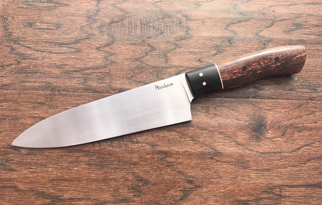

Here's the last one I made for the kitchen:
Specs:
OAL: 12.5"
Blade: 7.5" Distally tapered, combined full flat and convex grinds, hand finished to 600 grit. Heel height 1.9", edge is 0.007" before sharpening. Sharpened to 17 DPS
Steel: 52100 carbon steel, heat treated by Peter's to RC61
Handle: Marbled Cocobolo, black paper micarta handle. Micarta and bronze liners and pins

That's beautiful! I'm always indecisive about plunge lines on my kitchen knives. I really like how yours seems like it just belongs there. Nice work!

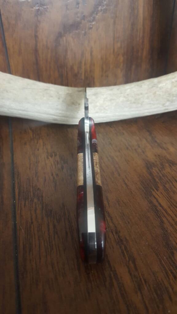

Finished this set today. Both are .070 aeb-l and box elder. I wish the two sets of scales would have been more similar but I'm pleased with how they came out.

Thanks Josh, I'd say I'm doing more and more plungeless kitchen blades. When I do a plunge I usually shoot for the plunge to be about perpendicular to the spine or a little forward leaning from perpendicular.

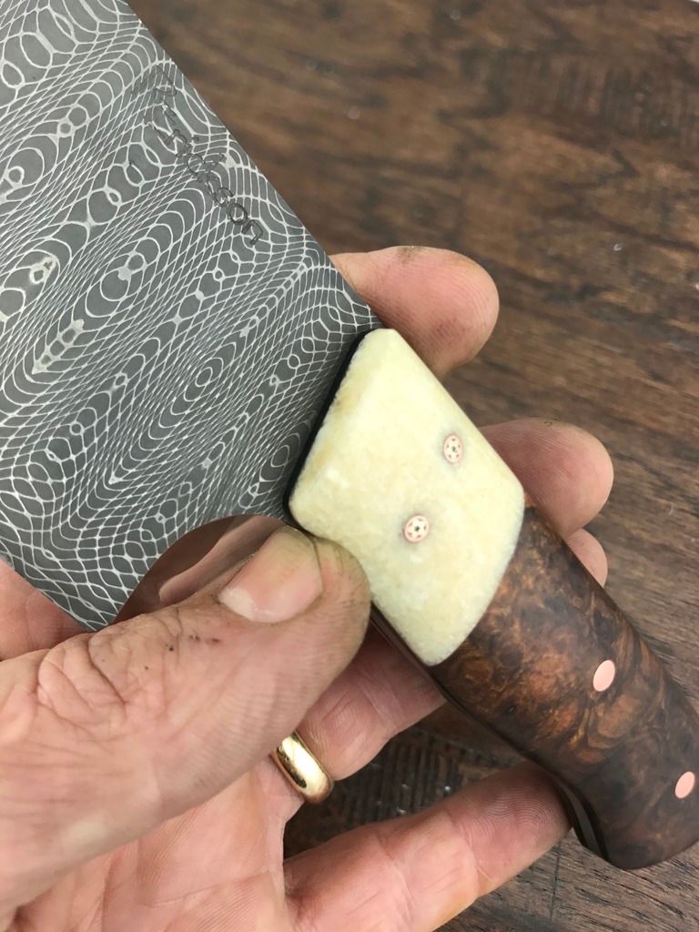

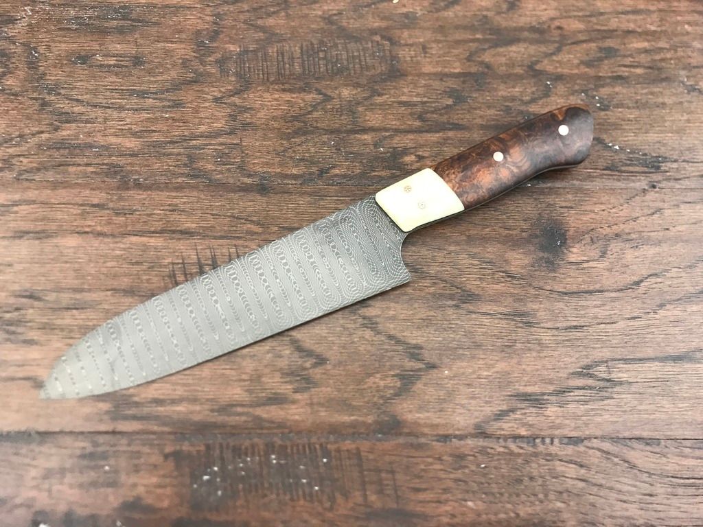

First time using Damascus from Vegas Forge. It's their Spirograph pattern. It's great stuff! The handle is AZ Desert Ironwood burl and Walrus tusk.
Wow very nice. That's as classy as it gets.
