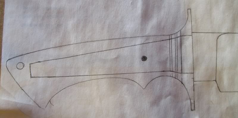

Here's all I have of it right now. The design. I'm actually making the gentleman two Bowies, to go with one he already bought from me.
I'll just be featuring the larger one in this thread.

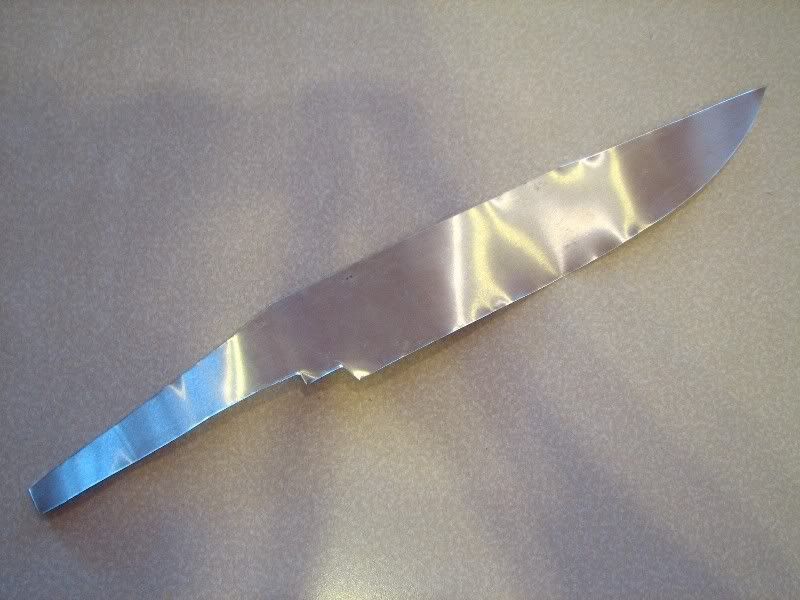

Anyway, I did do something today. When I'm forging a blade, I like to have a pattern that I can hold up to the workpiece, so I know I'm making it the right shape. I like to use something like 18 ga sheet metal, because it's stiff and sturdy, but all I have on hand is some aluminum flashing, so that's what I'll be using.
First, here's the original drawing showing where the tang will be:
Here the aluminum pattern:

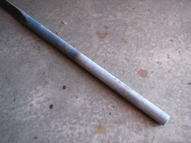

Here's a picture of the 1-1/4" bar of L6 I'll be forging it from:
One end of the bar is already flattened from another project, but it's been reduced too much for this big blade, so I'll be working off of the other end.
In case you're wondering why the bar is white, I took the picture a week or two ago when it was really cold, and I brought the bar into the house to take the picture, and the bar frosted up in a matter of seconds. :eek: :D

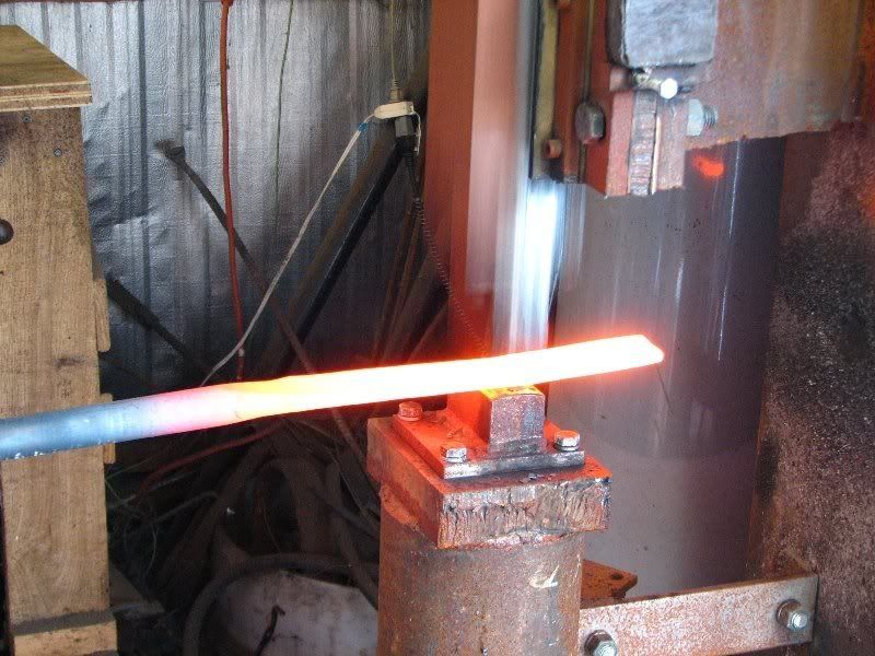

The first step is beveling the end of the bar by hand hammer, otherwise the power hammer tends to make the end "mushroom" over, and makes a cold shut. Which can be a real pain, when you start grinding the blade and keep running into a black line...

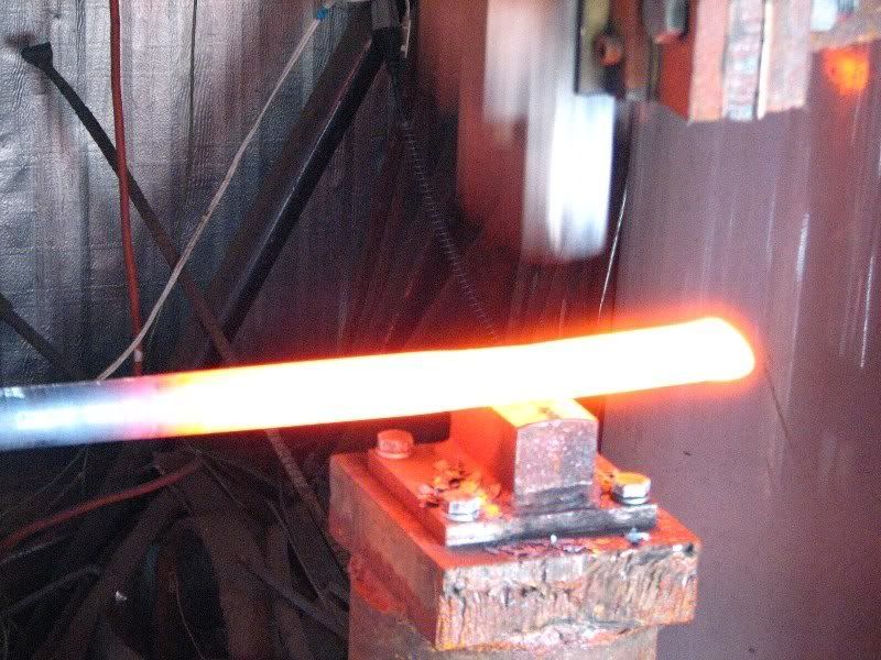

Next we go to the power hammer and establish a flat on the bar by forging with the bar at right angles to the power hammer dies. The reason for this flat is explained in the next step...

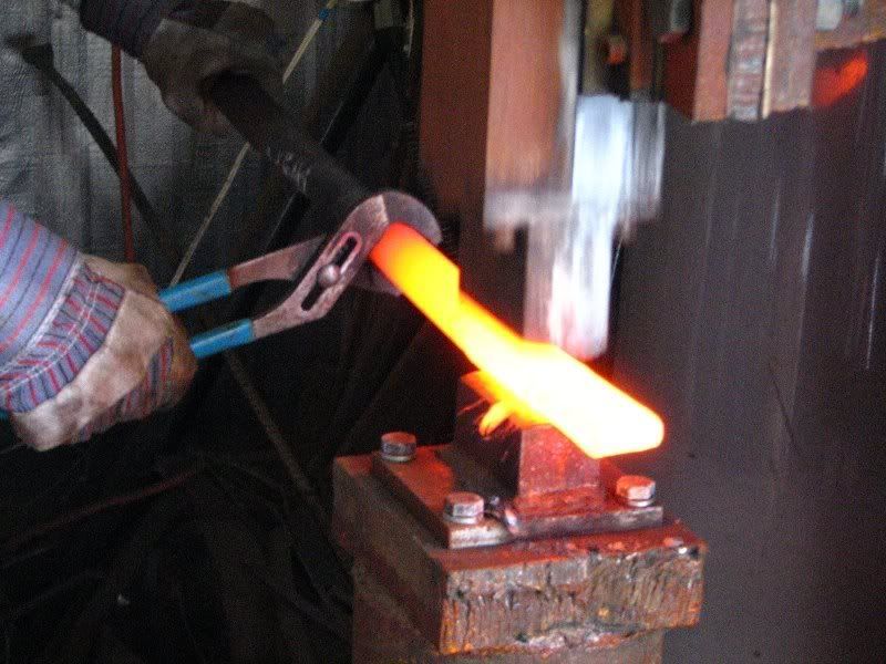

In this step I'm widening the bar to 1-3/4" by forging with the bar parallel to the dies. The reason for putting the flat on is so it's easier to hold the bar on the rounded drawing dies. Trying to forge a round bar on round dies can be a pain.
Flat dies tend to squash the steel in all directions, whereas rounded dies push it more or less in two opposite directions. The radius on these dies is 6"

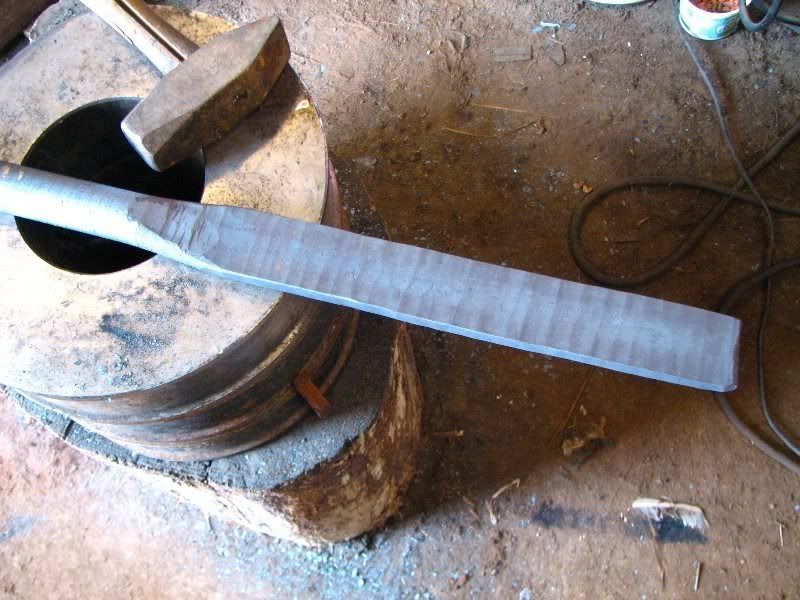

Here it is widened to 1-3/4" It's 7/16" thick, and 12" long.

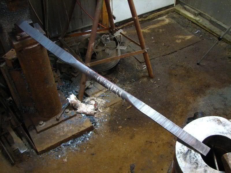

Next step is to draw it out lengthwise until it's 5/16" thick.
Here it is drawn out, with most of the distal taper forged in also. At this point, the whole thing is 46" long, which is to long to maneuver in my tiny shop, so right now it's cooling down, and I'm going to cut it in half, then take up where I left off.
I think you may wish to shop around for a new handle for that hammer soon...
He he. Which split are you referring to? The small one on the side has been there for years, the big one I put there because it's supposed to reduce shock...
Here is the bar cut in half. After lunch, I will hopefully finish forging the blade.
