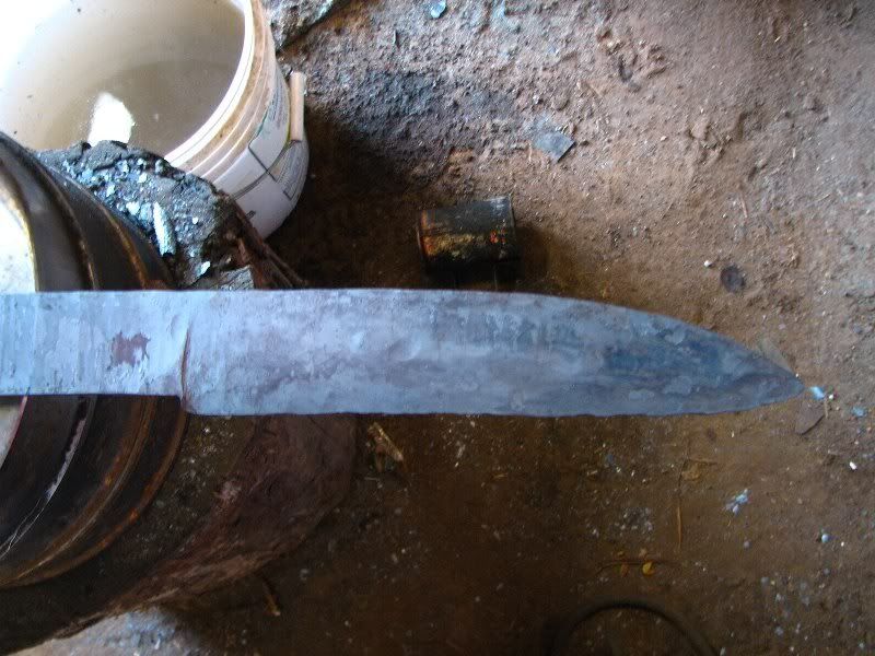

Ok, here it is just starting to forge the tip:
And here with the tip finished. After I start forging in the bevel, I'll tweak the tip shape.

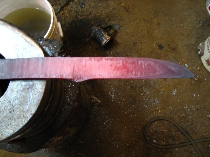

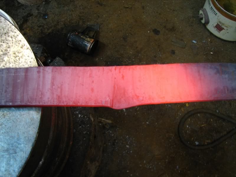

I like to start forging the plunge area first, then bend the rest of the blade in preparation for doing the rest of the edge bevel. There's a couple steps here I couldn't get on camera... But here's the plunge/choil started.....
And the plunge/choil finished, and just about to do the "banana".
Here it is "banana-ed". For those who don't know why it gets bent like this, the reason is, when the edge gets forged, the steel expands and curves the blade the other way. So you pre-curve it. Sometimes I don't curve it enough, sometimes too much. This time I got it about perfect.

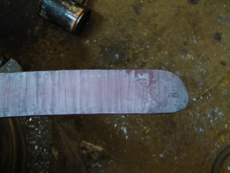

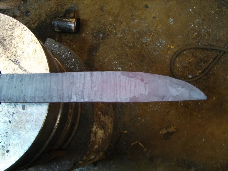

Here the edge is mostly forged in. The tip didn't curve up as much as it should have...

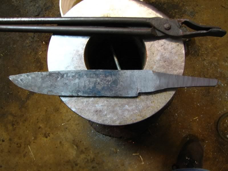

...but that's easy to fix. Here it is basically done, just need to do the tang.

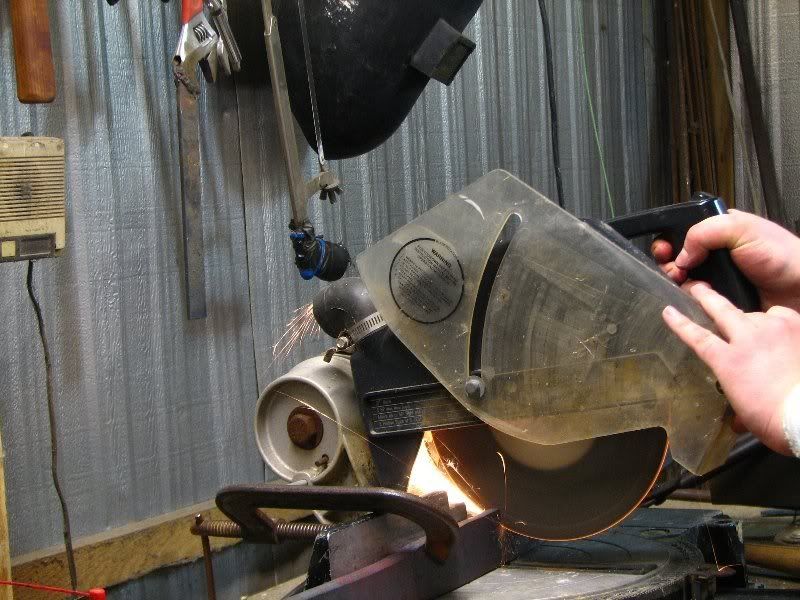

If I had a hole through the upright support of the power hammer, I would forge the tang while it's still attached to the parent bar, but I don't, so I have to cut the blade from the bar, then forge the tang. Normally, I use a hot chisel to cut the blade free, but this blade is almost 5/16" thick, and 1-3/4" wide, and I want to finish this project before my grandkids get married. So, for the first time ever, I used a chop saw to cut it off.
Cut off:

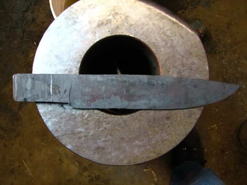

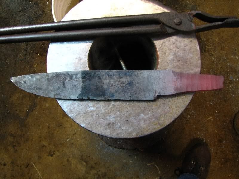

I heat up the tang end, and hold the blade in my gloved hands to do this next step. I wish I could have got an action shot of forging the tang, but I had my hands full. :) Here it is after one heat:
Here it is after the second heat. This step is so easy with the power hammer. Used to take me about half an hour by hand.

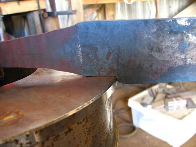

I do it by hand. First I measure back from the point, and mark where I want the dropped edge to start, then I lay it on the edge of the anvil at an angle, and carefully hit it with the hammer. Then flip it and do the other side. It usually takes 2 or 3 heats to get it the way I want it.
The I set the choil area on the far edge of the anvil, with the edge down, and hit the spine with the hammer. What this does is square up the choil area.
Got to make sure the edge is centered, too. :)
I'll take a couple pictures to try to illustrate these steps.

Here's a photo showing how I square up the choil area:

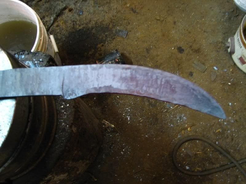

Well, finally got a couple more blades forged, so now we're going to "thermal cycle" this big blade, as well as two more. The other two blades are both damascus, and I hope to be posting photos of them in the not-too-distant future. The heat treat oven is not a free energy device, so I like to do as many blades at one time as I can. I made a rack out of angle iron to hold blades in the oven, and it holds three. Of course the angle iron scales, so I got some stainless angle iron off of fleabay, but I haven't gotten around to making a rack out of it.
I used to use the forge to thermal cycle, but I wasn't getting the steel hot enough, so I kept getting alloy banding in my blades.
So, here's the way I thermal cycle now. I set the oven to run 4 cycles. First cycle is at 1600, then 1550, then 1500, then 1450. The high temperature of the first cycle serves to dissolve carbides, making sure that the carbon is moving like it should. The others refine the grain, and homogenize the structure. I take the blades out to cool after each soak at temp and check with a magnet to make sure the austenite has finished converting to something else. What it converts to depends on what alloys are in the steel.
This blade is L6, which, because of it's deep hardening nature, is kind of interesting to heat treat. One thing I noticed about L6 is, when letting it cool after the first cycle, it takes a long time (ten or fifteen minutes, sometimes) to regain magnetism. But as the cycles progress, it takes less and less time to get magnetic. This is because with each cycle, the grain size becomes smaller, and when the grain size gets smaller, the hardenability (depth to which the steel will harden) decreases.
The last cycle, I let the blades cool all the way to ambient, which makes it a normalizing cycle, then run an annealing cycle. Which goes like this: hold at 1300 for one and a half hours, cool at the rate of 50 degrees per hour to 1000 degrees, then cool to room temperature.

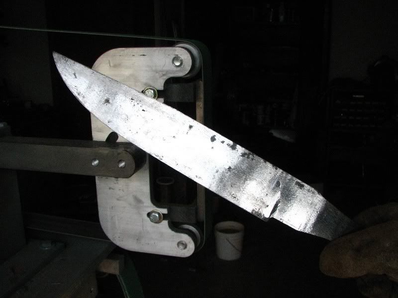

First, here's a shot of the blade after annealing:

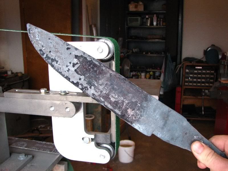

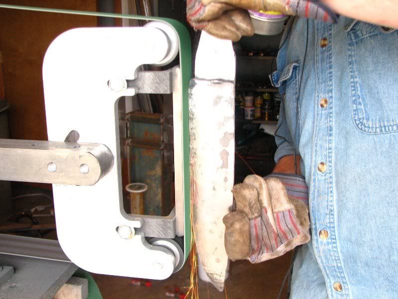

The first step (for me) is to use the small wheel with a dull belt to knock off the scale:
Here it is cleaned up:

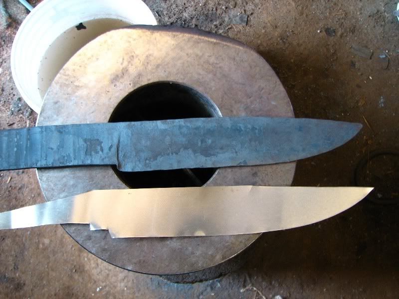

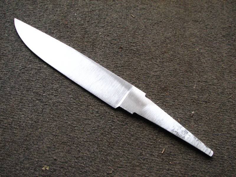

Then I grind it to the final shape:

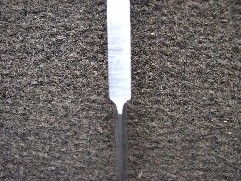

Next I flatten the ricasso and taper the tang so the guard will slide up to where it needs to later on.

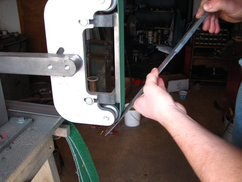

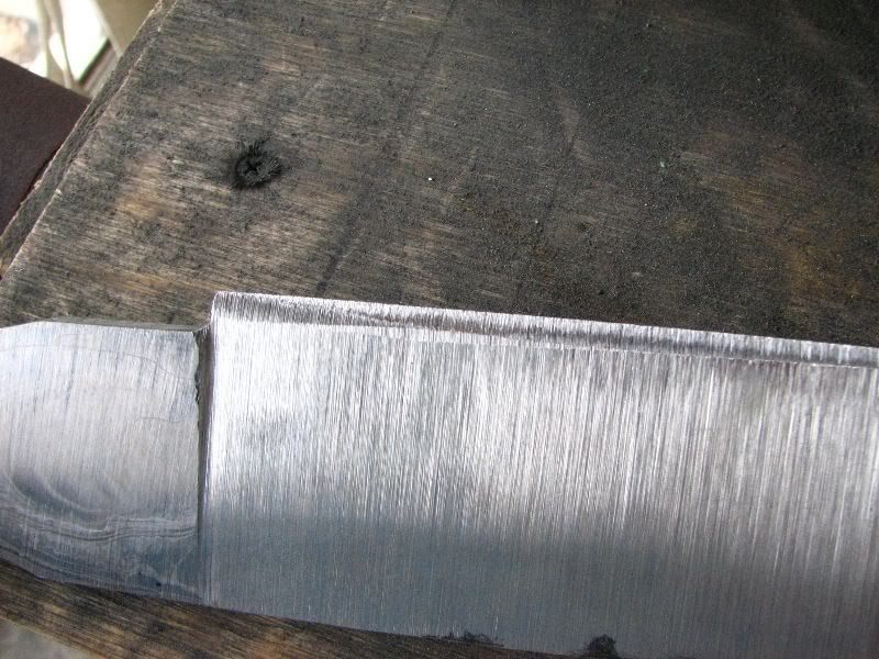

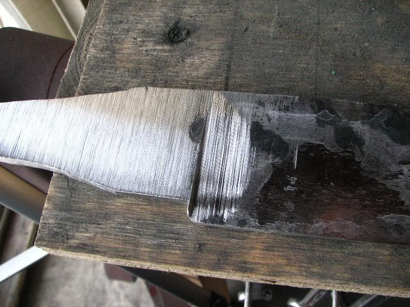

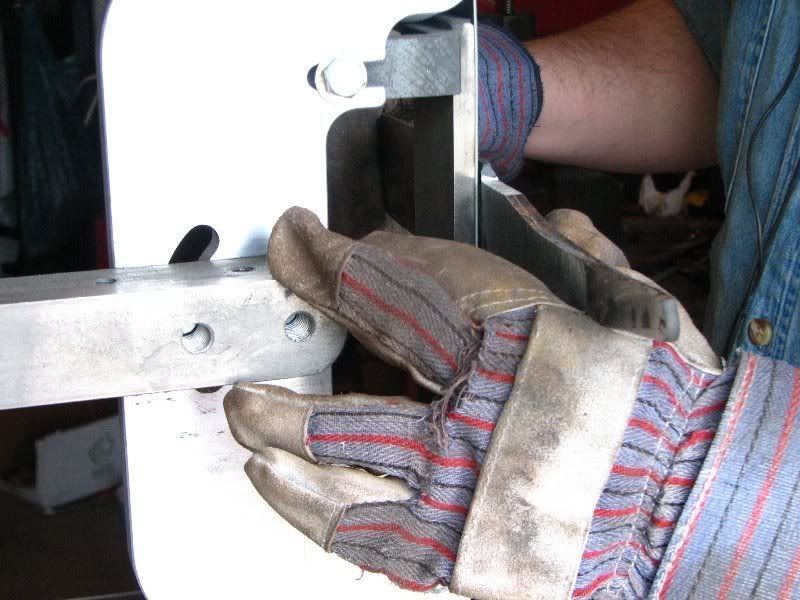

Then I do the plunge grind:
Here I have already cleaned upthe flats, but it's still too thick at the edge, so next I ground a bevel which does 3 things. It establishes the final edge thickness, and it's real easy to see how much more I need to take off. This is when I make sure the edge is straight, and the bevel keeps the next new belt from getting it's grit sheared off by the sharp angle.

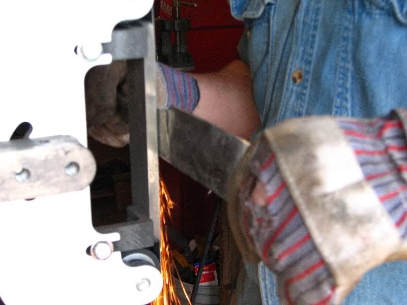

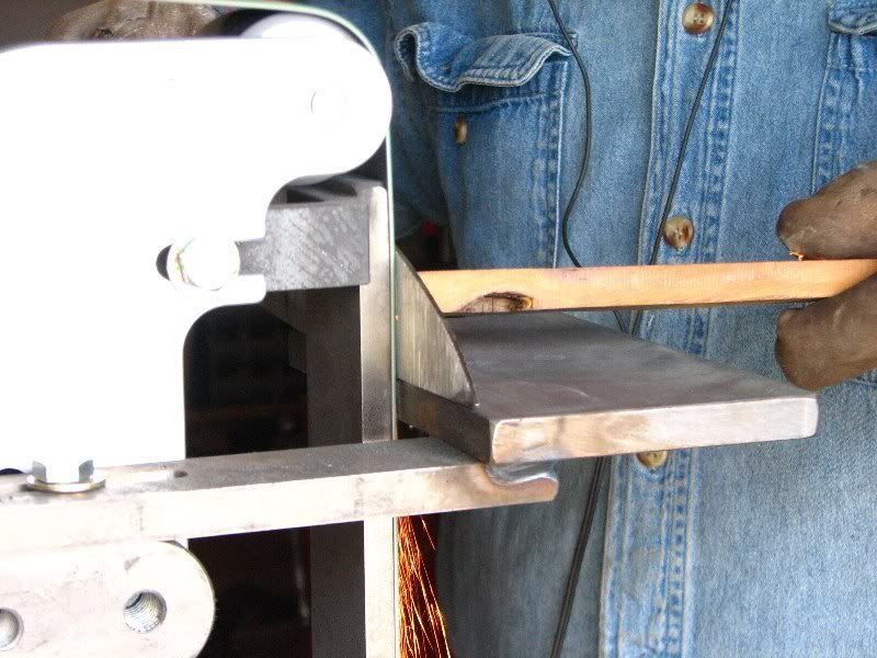

Here I am grinding the flats. Up to now, I've done all my grinding freehand, but I just bought the grinder I'm using here, and it came with a work rest,
so I decided to give it a try. I liked it. I used a push stick to apply pressure where I wanted metal removed.

The plunge grinds. Not too bad, and they'll get cleaned up as things go along.

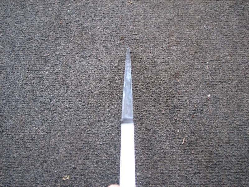

Here's a shot showing the distal taper:
