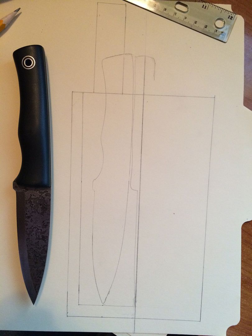

Grab a few old manilla folders (or the inside of a cereal box) and trace the pattern over to this weight stock. Cut it out.
What I did was to carry over my trace to a manilla folder and then started to see if my knife fit. What you want to do is to take the sheath and set it up on it's spine - with the blade perfectly straddling the center line and carefully trace the knife all the way around. Then turn the knife on its side and trace again. This will allow you to see where your knife will sit inside the sheath as well as determine if your pattern is the right size for the knife you are making.
At this point. Slow down and take your time. Planning in the pattern stage can really save you leather and time. Fold the drop loop over (it should be 1 inch wide) and see if there is enough room for your belt once you have it folded where you will want to stitch it at. Your loop should not go beyond the depth of the handle when the knife is inserted. If it does - either bend the loop at a different point - or cut the loop shorter.
Essentially the pattern will act as the leather for right now. Fold it over - tape it shut - pretend it is a sheath. Does it wear right? Does it do or have what you want it to have. If not - make changes. Take your time - and remake your pattern to make the changes you want.
When you have this done - find some bubble wrap and cut the pattern out of bubble wrap. The bubble wrap is about as thick as 10 ounce leather - which is what we are going to make this sheath out of. Refit everything and make sure you like it.
If everything fits - make sure you have a welt pattern that matches your sheath pattern. For single stitch sheath - use a ruler and add a line on the inside of the that traces the edge of the sheath from the center point at the tip (the bottom) to the center line at the top near the drop loop.
Of course - if you don't want to make any changes and simply make yourself a sheath - size my pattern to scale and cut it out.

Tonight I laid out a template for my Kephart. For my first attempt, I'm going a little more simple, I think, and doing a square bottom. Probably hard to tell, but there's a taper from top to bottom to accommodate the handle width so it'll hopefully look more rectangle when complete.
Some questions before I cut out the template to give it the dry run:
Does it look like I gave myself enough room?
For the belt loop, I have it centered on the half. Should it be closer to the handle position?
