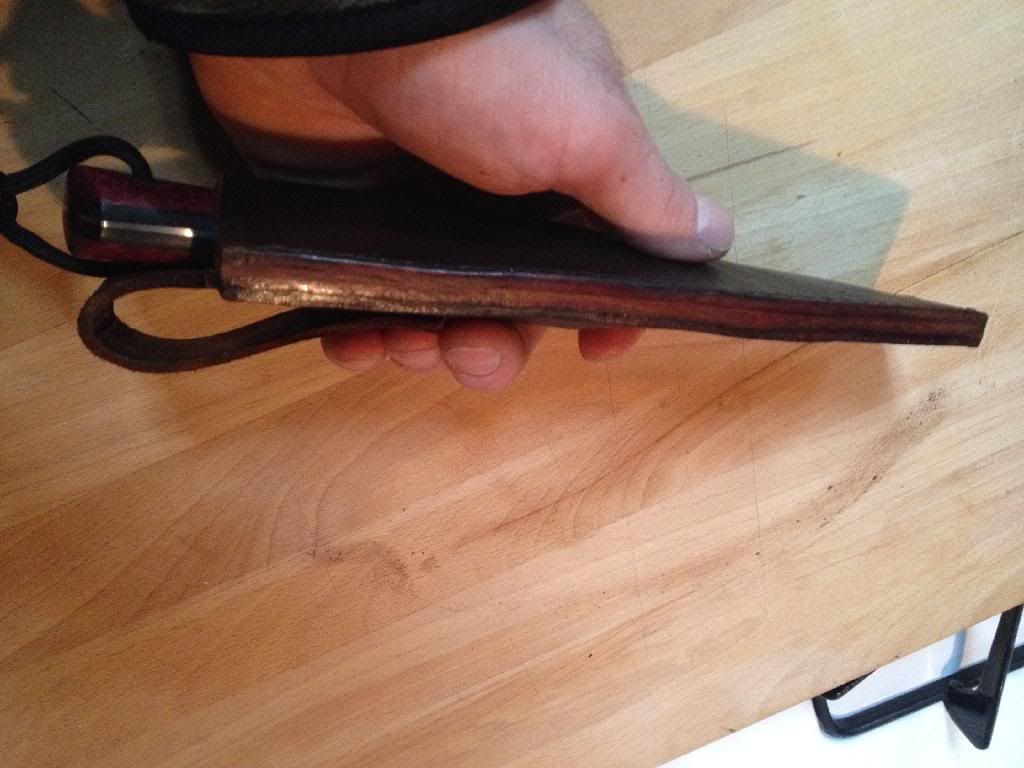

Hey Thurin nice job on the sheath, I had been tempted to try the prongs too but wasn't sure how well they would work. Did you fold your sheath over and put the welt in and punch through everything all at once?
Thanks PaG.
I punched each one separately, punching through from grain side up. I stared in the bottom corner where the stitches come together and worked out from there. Using the 3 hole punch, I overlapped one prong each punch so that it was consistent the whole way up. They lined up really well. The only place I had any issue was when I glued the welt, I misaligned it sideways every so slightly in about a 1 inch section in the middle.
Using the needles to line everything up while gluing made it pretty easy.
After gluing up, I used a stitching awl to go through each hole, making sure they were lined up and to punch through the glue, etc.
I'm tempted to try the drill press method at my father-in-law's so I can compare the two.
Thanks PaG.
Thanks for the info Thurin, I was worried it would have trouble keeping the holes aligned between the two sides and the welt using the punch prong. I used the drill press method on mine and it worked really well after I figured out what size needle to drill with. I had the sheath folded over and the welt glued on one side and drilled through everything at once to make sure the holes would all line up for stitching.

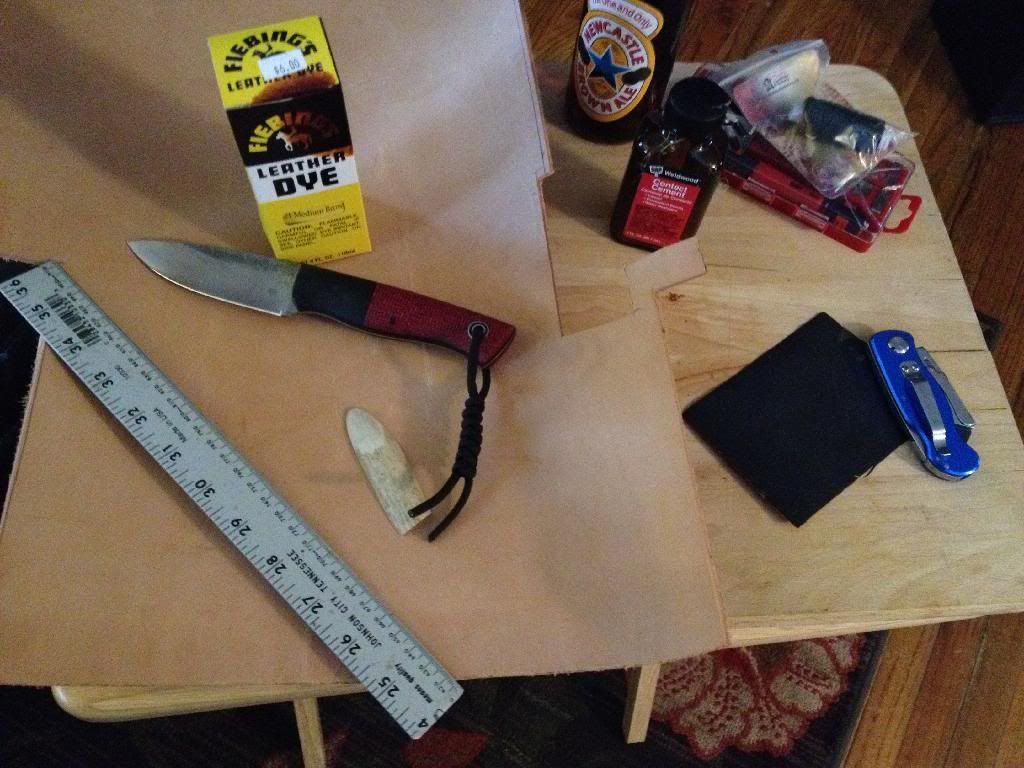

I'm going to start my sheath. Here are some of what I'm working with. The sticker on the leather from Tandy says this is 6/7 oz leather shoulder. A little thick I think, but I'm going to give it a go.
I did manage to cut a piece of antler and sand it smooth for burnishing. I have to admit I really enjoyed watching the video last night TF. The one liners are great!! Don't worry, I'm not going to eat any potato chips. ;)
Since I don't have a drill press I'm following Thurin and using a 4 prong stitch chisel. I'll see how far I get today and post up a pic later.

Schmittie, I would think that your 6/7oz. leather is just fine (a little thin if anything) just makes a little more flexible sheath. I ordered 7/9oz. leather and must have got one on the high side of 9oz.; it's looking really thick compared to yours. I'll make it work.... Yesterday I made an edge burnisher on the lathe out of a piece of Ironwood instead of buying one, probably only took an hour or two and cost twice as much as if I'd just ordered one! Pics when I get a chance.
Rich
schmittie-That looks like pretty good leather from the nice finish on the backside. Hard to tell what the thickness is from the photo, but 6/7oz. will work. It will be easier to manipulate than 8/9oz. and still just as good protection for you and the knife.
The stitch chisel will work, it does leave a pretty big slot though. A suggestion on the chisel would be to find one that has the prongs on a slant rather than a straight line. The slant makes for less chance of the stitch pulling trough to the next one in line.
Quick tip on dye work-Really get the leather wet before applying the dye. I mean almost soaked through. Apply the dye after letting surface water drip off. Try two test pieces, one dry and one wet. Use one coat on each and see what you like best. If your dye is the standard Fiebings, add 1tsp. olive oil to the 4oz. bottle. Shake well before applying. Dye will spread more evenly and the olive oil helps condition the leather. I like extra virgin.:D

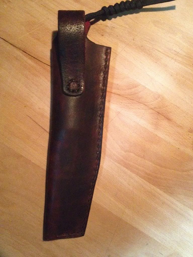

Well, here is what I accomplished tonight. There are things I like. There are things I don't. I, for one, see the wisdom in many of the tools listed by TF. I plan on making a few purchases before attempting again.
1- I agree with Rick's tips above. The prong chisel I have leaves too much of a slot and I'm not thrilled with how it has finished.
2- I was surprised at how dark 'medium brown' dye ended up looking. I'd like to get light brown for future use. But I was going for a slightly 'mottled' look and I'm not unhappy with how it finished though it's hard to tell from the picture.
3- My belt loop is a little cockeyed.
4- I used a part of the leather that looked to have lots of creases/imperfections for more of a rustic look. But they didn't seem to stand out like I hoped.
5- I have never been able to understand the process of buffing the edges with antler. But seeing the video TF posted made all the difference. I think I was able to get a nice shine on the edges and was impressed at how well they actually did buff.
6- I should have gone one more stitch on the bottom towards the bend.
That's about all I have to say for now. It was a fun project. A few more tools and I would like to do another. Soon. :)
1) The prong chisel from Tandy is a little wide for my tastes - I think a diamond awl is about right in width.
2) I have used light brown for years and find that multiple coats allow it to get as dark as I want. Although - the browns are a bit different from shade to shade.
3) I have had trouble with belt loops too in the past. I have to close the sheath - and then hold up the belt loop to make it vertical and parallel with the sides of the sheath and then mark it lightly with a red pen at the bottom of the belt loop.
4) If you have not sealed the sheath yet - grab a worn piece of 400 sand paper, put your knife in the sheath, and hit the area's that have creases and where the knife handle is a little. You will take off a little dye in those areas and it will look more rustic and worn. Take off as much as you would like it to look - wipe it off and then seal it.
I think your first one turned out great. It certainly does the job you want it to - and will last forever. Good work.

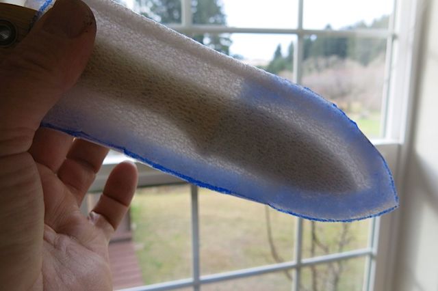

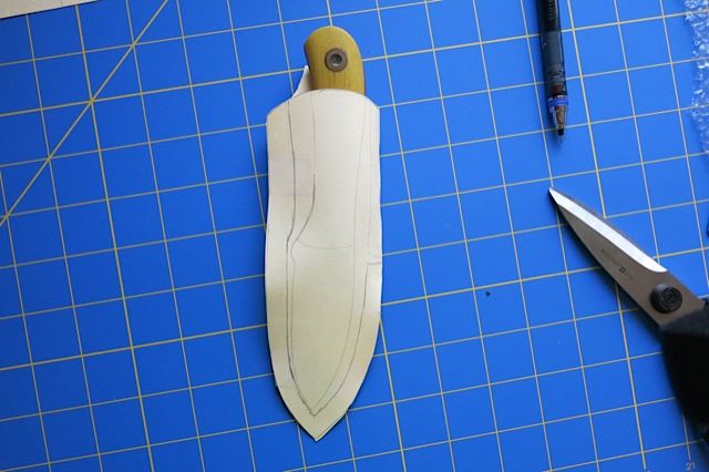

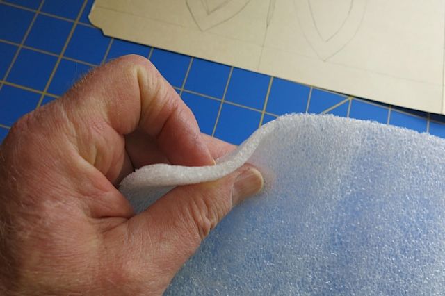

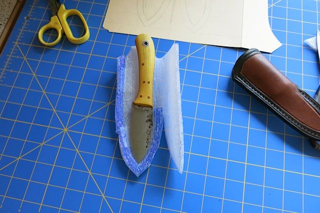

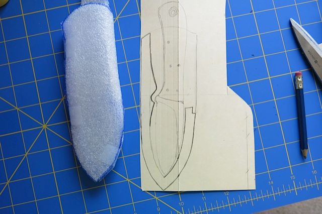

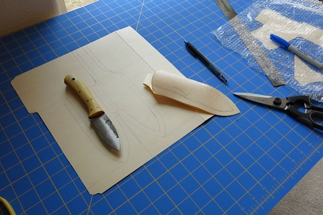

I'm finally getting started, and following Tal's useful suggestions. Here is an EDC II laid out on a manilla folder while I play around with proper width.
Then I cut one out of bubblewrap, not too happy with it. It's too floppy, loose to approximate leather, so I went looking in the garage and found some closed-cell packing foam a little over 1/8" thick. It worked great.
And, it's transparent enough to put up to the light and see the inside fit.
So now I need some advice from Tal: I have a couple of knives from custom makers that also made the sheaths, and those sheaths are so well-fitted to the knife that they literally "click" in and out. I've looked over the sheath and it appears that they have intentionally cut a "step" or a notch in the welt to catch the knife tang, or a bulge if there is no tang. In the drawing below I've attempted to capture that effect in the welt I'm proposing for this EDC II sheath. Have you done this -should I try it -or is this just too complicated for my first sheath? (I know it will require some really close tolerances.) Next step is cutting leather.....
I'm sure Tal will comment on this, too, but I've never done that inset in the welt. That sure doesn't mean it's not a good idea, but looks like it would have to be just right to work easily. Another good chance to learn something on this thread. Got to say that this thread is one of the really good ones. Not a bit of the cut in stone "right way" versus "wrong way" that shows up in other forums. It's mostly showing methods that work for each individual and learning from those ideas.
When using that butterfly style sheath, it helps to round back the tip of the welt where it ends at the fold. If it's rounded, the blade tip will want to ride smoothly down into the body without catching on a squared welt end.

I have some thoughts on the topic - but I think in your case when you make it - it will tell you how much welt you can get away with.
No matter what - though - I can get your sheath to 'click'.

Honestly - I wouldn't mess with it as you can get this effect by wet forming the knife properly. When wetforming simply be sure to pinch the leather (forming it) behind the finger guard of the knife (where your welt is located right now. Molding there will create retention. You don't need to make it drastic - most of your retention comes from a properly fitting sheath - like you have right now. So a little goes a long way.
When you are done - use a sealant that is more stiff (like Tan Kote) and you will love how it feels.

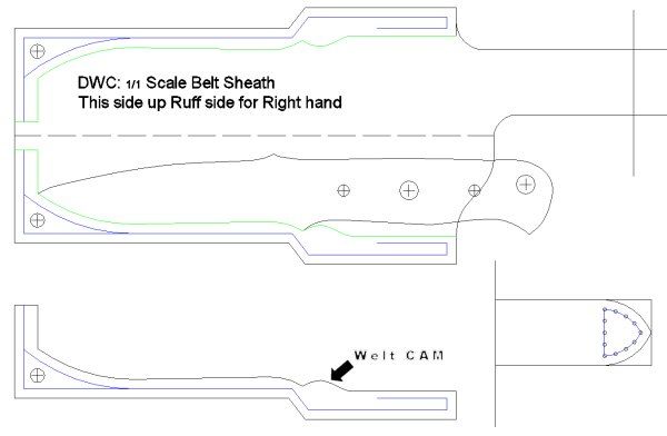

Here is an image I found on the net of what some call the Loveless cam lock: I didn't know what to call it. Some like it, some find it doesn't last. I still want to give it a try.
Rich
Rich,
Damn it - I really like that design. I will need to try that. THAT welt Cam is a perfect design. Not putting the stitching near it leaves you more GIVE on the cam. Just take your time - trim as needed.
Speaking of - want me to draw up that design for an Arete or something and scan it for you? I can use what I know so far and go from there. I am intrigued!
