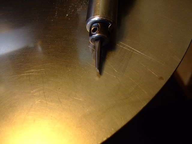

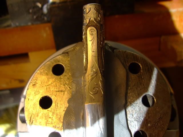

Now that I have both sides of the rear of the handle , I am moving on to the gold inlays on the side of the handle. This is a pretty simple procedure. I start with a square graver and cut my lines. They are thinner than the final inlay so I can make some minor adjustments if I need to. I follow with a round bottom graver that will establish the width of the inlays, and then use a narrow wedge shaped graver to undercut the sides. I drive the wedge in perpendicular to the line.

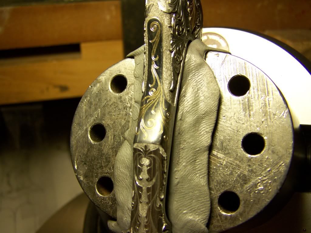

Once this is done, simply lay the gold over the cut and hammer it in.
Now that the gold is hammered into the cuts, I stone off the excess and polish the area. Border cuts help the gold stand out and give the inlays a cleaner look.

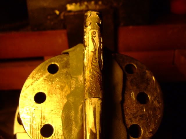

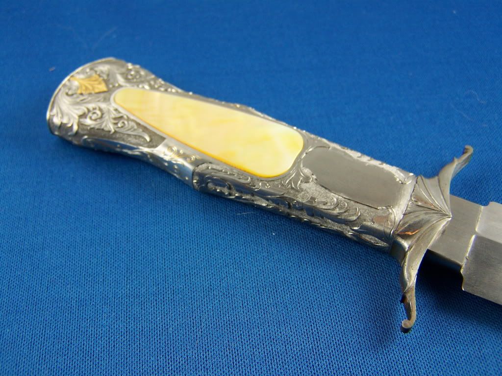

The polished area with the inlays will be blued. as will the border around the pearl inlay.

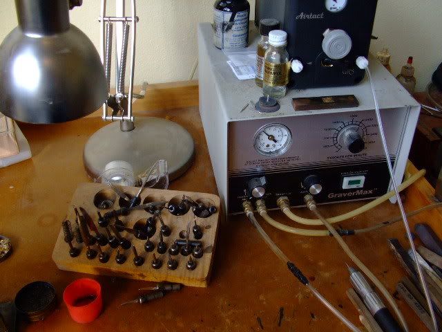

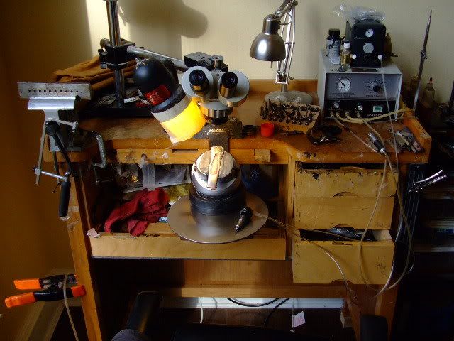

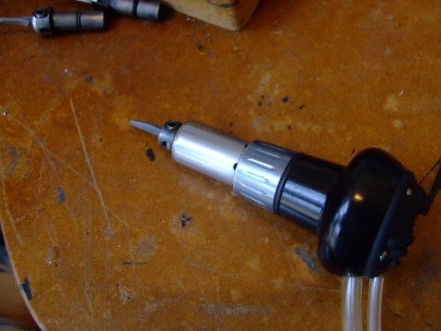

Here are a few pics of my engraving bench. They show my square graver that I do 75% of my work with, the handpiece and my assortment of gravers.

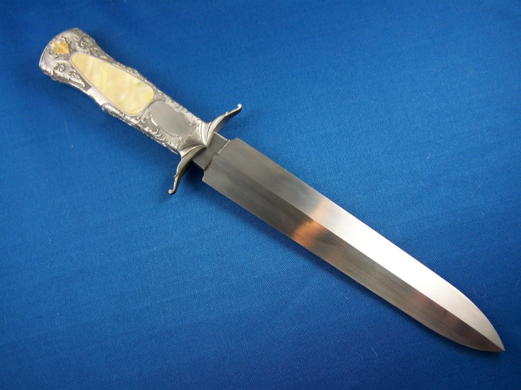

Wasn't able to work on this one as much as I needed to today, but did set up some of my new lights for taking pics. Thought I would show the whole knife and the handle with the pearl inlays.
