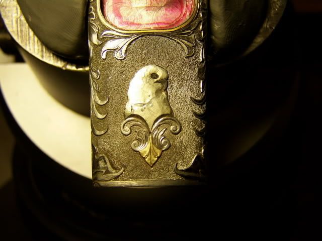

OK, I have all of the scroll work cut, relieved, carved and stone polished to 400 grit. I worked on the first Parrot today.
First pic is the outline of the parrot and the scrolls that create a "pedestal" effect.

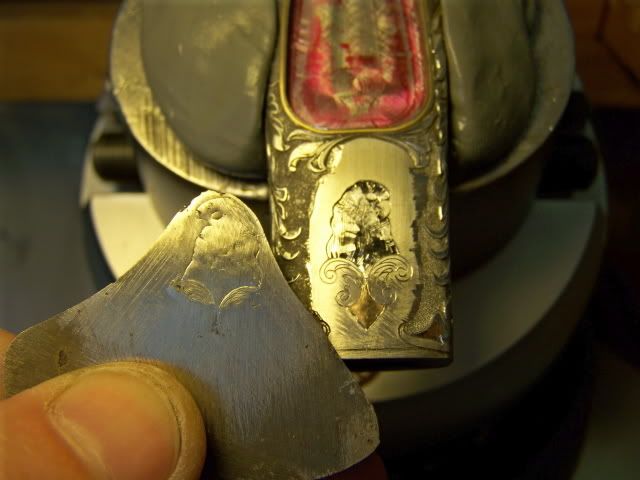

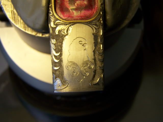

Now I cut the inlay pocket and the scroll outline. I had some silver sheet, but it was too thin for this project, so I melted it all down and forged it flat to just under .04". I decided to do a sheet inlay to show how I do that as opposed to the wire inlay method I showed earlier in the thread. So to get the outline of the pocket on the silver so I can cut it out, I simply lay the silver over the pocket, and hammer around where the edge of the pocket is. This gives a very accurate impression on the silver.
Next step is to undercut the edges of the pocket, and raise burrs in the center of the pocket. I used my undercut tool so I would have very strong burrs. The idea is to hammer the silver inlay into the pocket and it should flow under the burrs a little and create a velcro effect to hold it in place. I use a jewelers saw to cut the inlay, and I cut it undersize a little. I don't want a perfect fit becasue as I begin to hammer the silver onto the burrs, it will begin to flow outward as well, and go into the undercuts before it tries to lift over the edge of the pocket. If it does lift over, it can be a real pain to deal with.

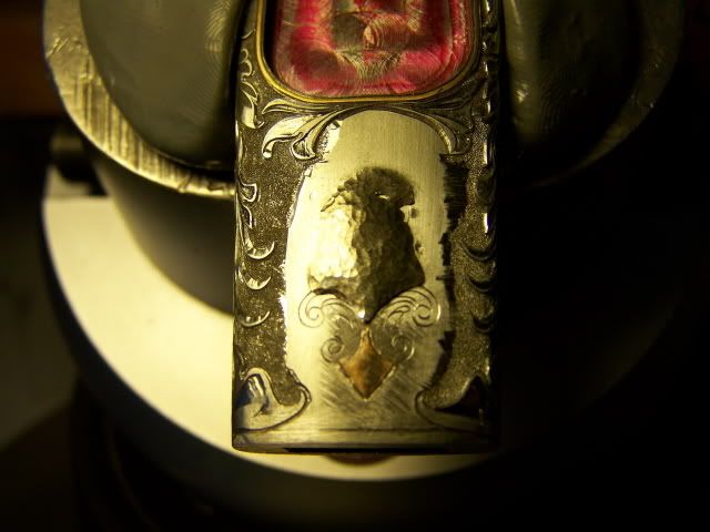

The silver inlay is just above and left of the pocket.
Now after the inlay is hammered in.....

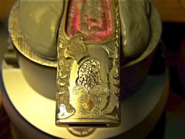

And the foundation level of sculpting done, as well as the background removed and textured, and the scrolls sculpted and stoned. I have another gold leaf inlay as well.
On a Moluccan parrot, his eye and beak are black. I left the steel from the frame and will blue it once it is finished to resemble the birds natural colors. I will have the feathers carved and textured tomorrow.

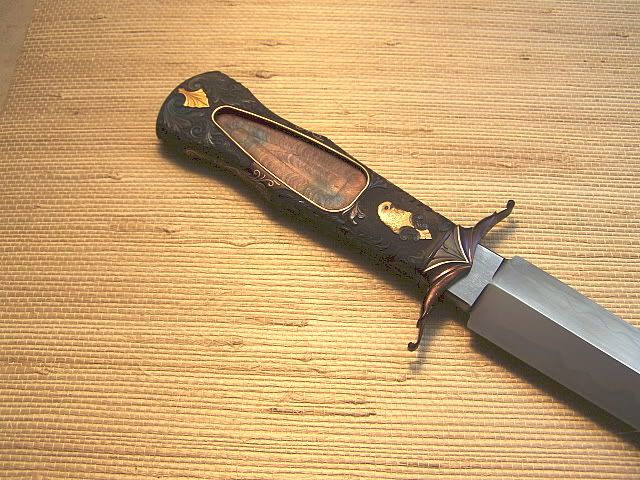

OK, with the carving all finished, I am ready to blue the handle. I like nitre blue against the gold, as it is a brighter blue. I had to sit close to the salt tank and keep checking for just the right color. With the whole handle blue, it's hard to see the engraving.
Now I need to grey the engraving. Now I am not exactly sure if there is a "true" French grey, and what I am doing is just a look alike, but it works, and is easy to control. I mask all of the areas I want to remain blue with frisket paper. It is a low tack adhesive backed vinyl. Basically the whole handle is covered, and I cut away the areas I want greyed. I use a Pasche air eraser. It looks like an air brush, but it is really a mini media blaster. I use the fast cutting grit at low air pressure and blast off the blueing, leaving a nice flat grey finish. Useing different grits will actually produce different shades of grey.
Once I have all the blueing off the unmasked areas, I remove the frisket and lightly go over the greyed areas with 4000 grit paper to put a slight sheen on the high areas.
Last is to blacken the background with Gesswein antique flat black. It is a paint used for jewelry and such. Very fine pigment so it gets into the smallest cuts. Put the inlays in, put the handle on the knife and BING BANG BOOM......you have a finished dagger!! I still need to engrave my name and sharpen it, but we will call if finished.
