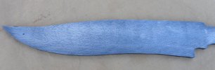

I was thrilled to be ask to be part of this project two weeks ago David Broadwell sent me the the spics for the blade and as I found time I worked on it John asked me to take pics as I worked on it and about half way through I started to do just that. so in this first set of pics I am forging down a mosaic billet so that I can tile it
attachment.php
attachment.php
now I will take some tiles from the hart of the billet
attachment.php
I used the mig to hold them together then tig all the way around each tile
attachment.php

Now I forged the tiles together ground and etched the billet so I could see where the welds are.
attachment.php
Now I will grind the welds out of the billet.
attachment.php
Now I will forge it down to a smooth bar about 1/2" thick and 1-1/2" wide.
attachment.php
Now I take this left over pice W's bar and forge it to a square
attachment.php
Then I twisted it up good and tight.
attachment.php
I forged it to the size of the billet and tacked it on the ends with the MIG
attachment.php
After forging it together I cleaned it up and cut it on an angle like this now I am ready to forge it into the blade
attachment.php

Now the blade is ready to go to David B so he can work his magic on it. I am looking forward to seeing how it all turns out thanks agin John for asking me to take part in this project.
attachment.php
attachment.php
attachment.php

Thank you all I left some room on the blade for David B to work I know he will be carving on the blade or I would have been happy to grind and heat treat. this is a light etch so David can see where things are at. I think when the blade is done this will be some of the most unique steel I have ever made. And I have enough left for about 3 or 4 more Blades.
