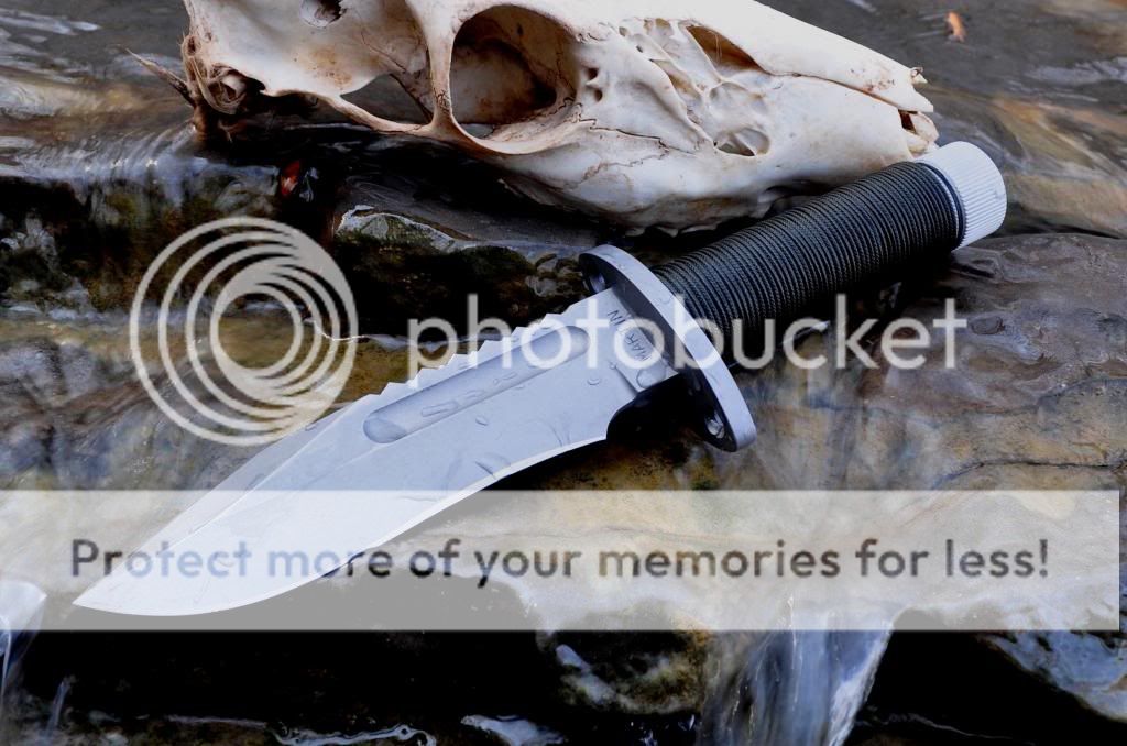

A couple of months ago I got the chance to check out the Boker Apparo, the production version of a hollow-handled survival knife that was designed and first made by Texas knife maker Newton Martin of Martin Knives. I had first met Newt about four years prior at the International Blade Show in Atlanta Georgia. I was intrigued by his work and was keeping a close eye on it as I have always had a fondness for hollow-handled knives and really liked his designs, but I have had some bad experiences with durability issues with some hollow handled knives in the past. After getting to test the production version of one of his designs, and being very happy with the results, I spoke with Mr. Martin about the possibility of a smaller design that would be more practical for me and my work. I found out he was working on a new design, and was fortunate enough to get in on testing it in the field.
This is the new design, it's called the Caiman.
The specs are:
Overall Length.............................10.75-in / 27.3cm
Blade Length...............................6-in / 15cm
Blade Thickness...........................1/4-in / 6mm
Blade Steel.................................CPM S35VN
Guard Steel.................................416 stainless
Handle material............................300 Series Stainless Steel
Cap Material...............................Aluminum
Weight......................................15.5oz / 440grms
Even with the t fits in a Spec-Ops Combat Master Short perfectly. It was tight at first, but it has loosened up a good bit over time,

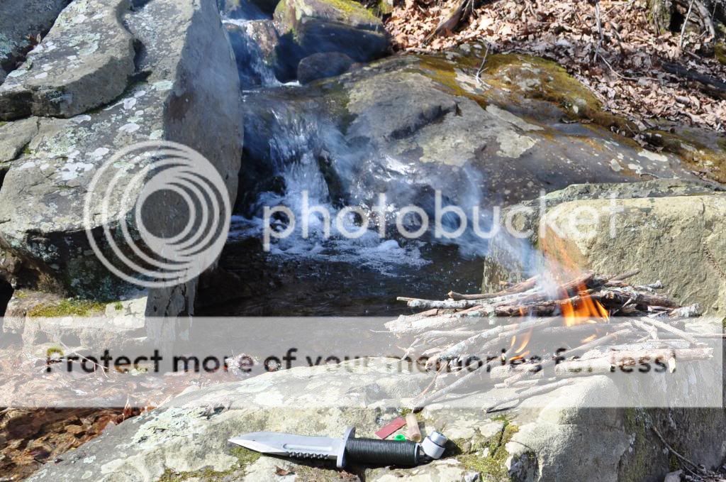

The most recent time, I put just some NATO life boat matches and a red phosphorous strip in the handle, took the knife directly from the warm environment of the truck and placed it in very cold running water, and left it there for thirty minutes. As the knife lay submerged, I gathered the tinder materials and fuel for a fire. After thirty minutes in the cold water I opened the handle, pulled out the dry contents, and with one strike of one match I had fire.

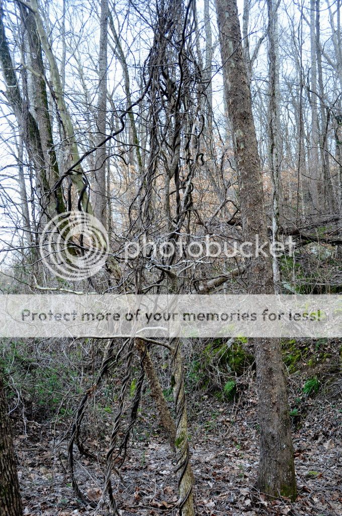

If you take a good look around in an area where moss is common you will start to notice patterns in the growth of the moss.
Looking North
Looking South
Looking East
Looking West

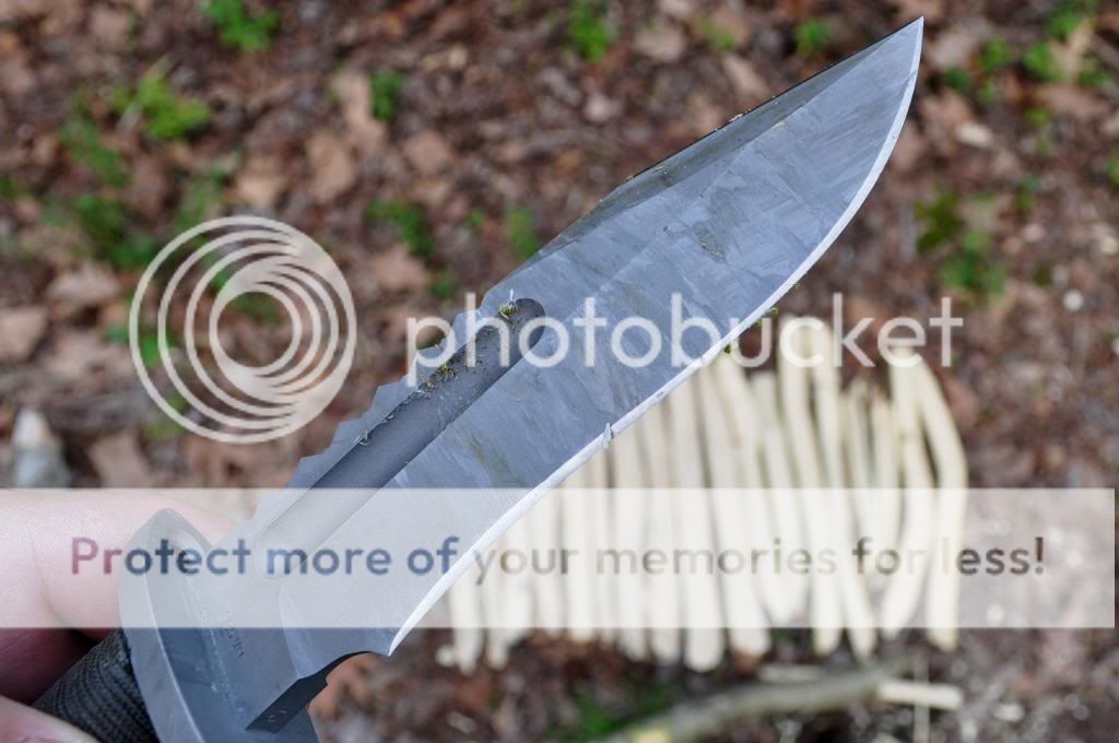

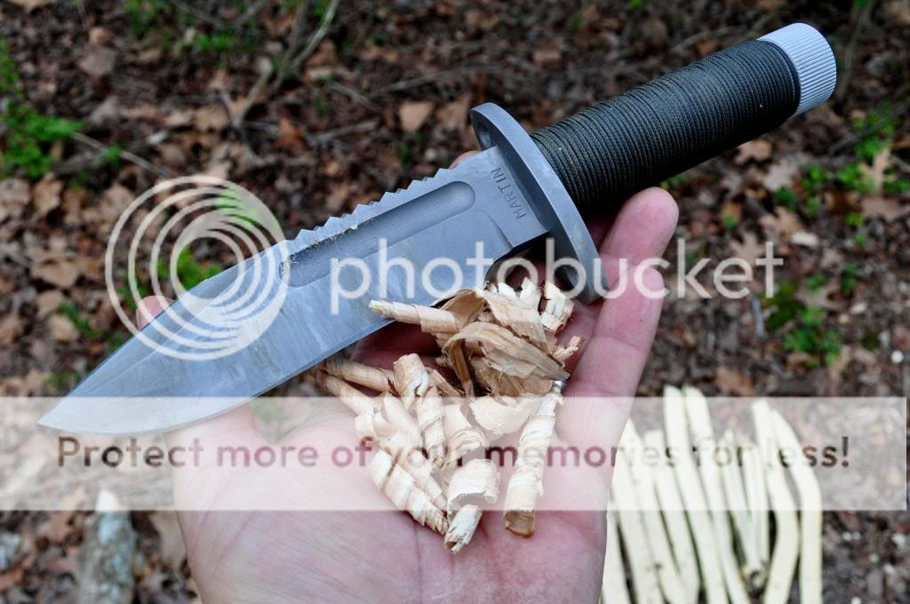

The knife arrived with a great edge, and that edge along with the re-curved blade profile, made whittling fine curls in some hard seasoned maple a breeze.

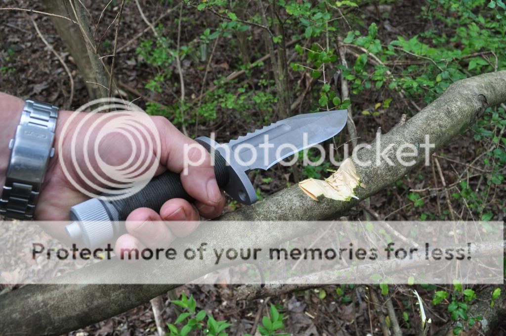

One of the first chopping test was to attack some of the large vines in the area. There are a lot of them, and many provide no food or water and only kill trees over time. The Caiman handled even vines up to one inch in diameter with one clean cut.
There are a lot of heavy vicious brier vines in this area that I have to cut my way through sometimes to get to wild plants I want to harvest, or shots I want to take. I don't like carrying a machete most of the time as it just gets in my way and slows me down. Snap cuts made quick work of clearing the path.

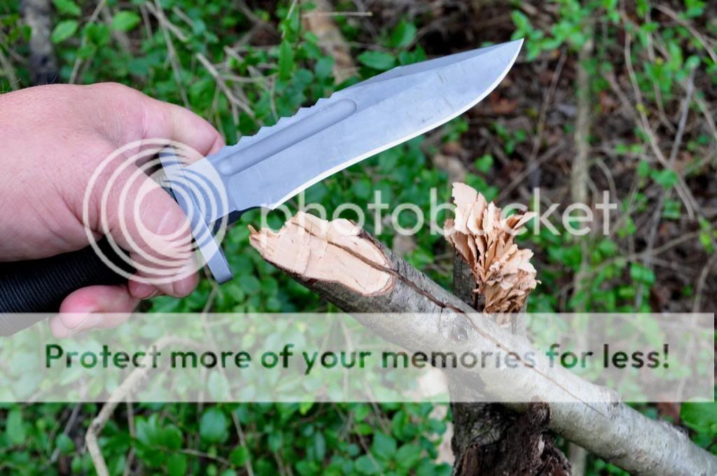

Quick snap cuts also made short work of small saplings in the way.

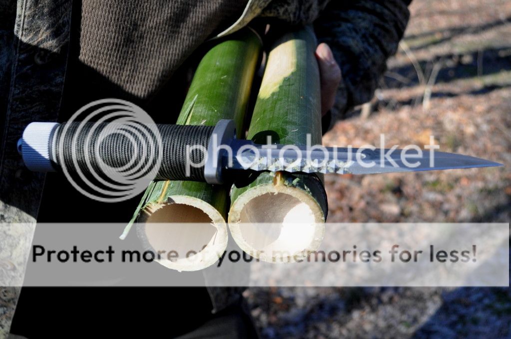

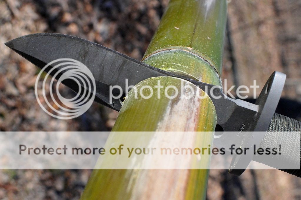

Having spent a lot of time in areas where bamboo is widely available, it has become one of my favorite natural resources. The mass of the 6 inch blade easily made clean diagonal cuts through one inch bamboo.

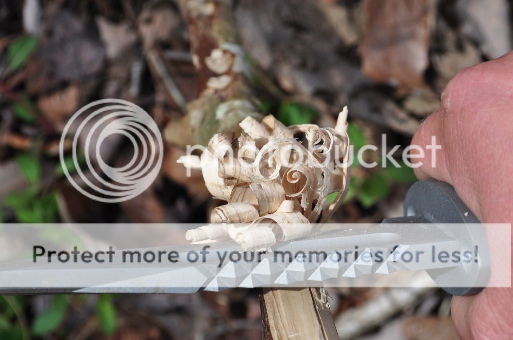

The new saw design, with three rows of teeth, is really efficient even with such a short length of saw. It makes quick work of making notches in seasoned wood, and the two inch section of saw easily handled cleanly cutting through two inch diameter bamboo.

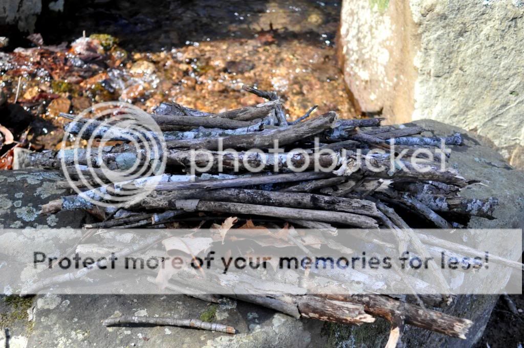

A little digging around for tinder materials to do a little lateral testing.

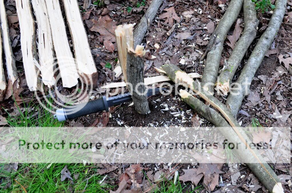

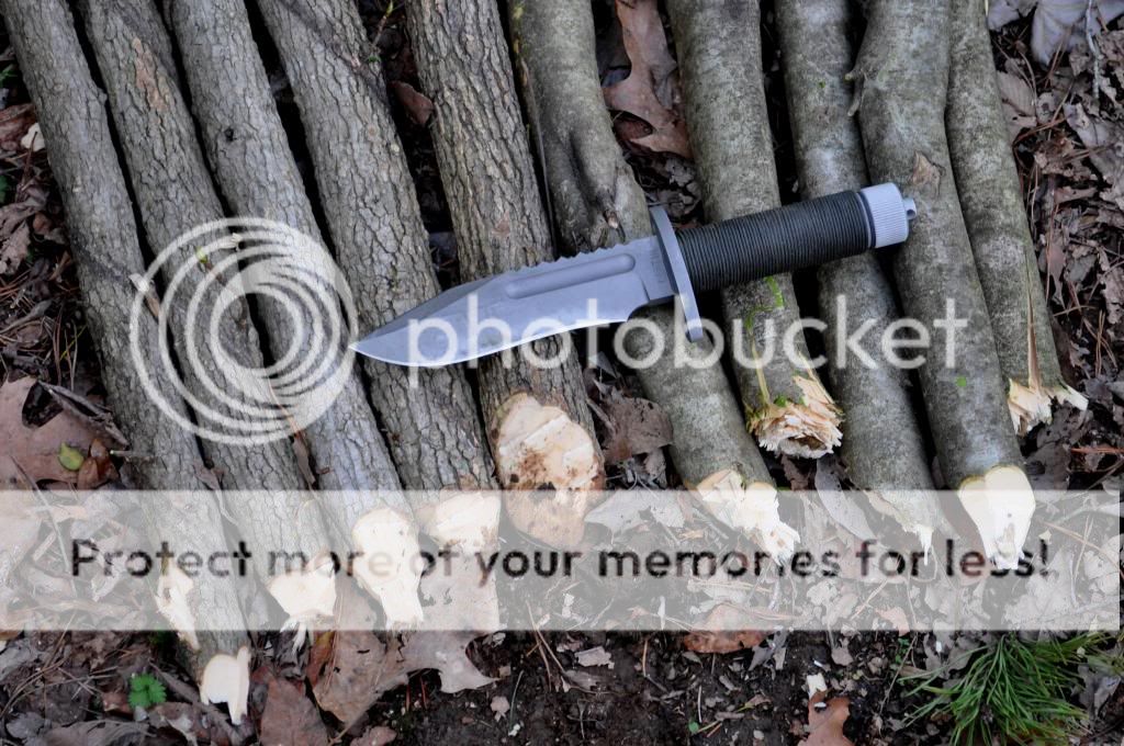

Ok, so the lighter testing done, time to move on to some rougher uses. Part of the job of a survival knife is to facilitate shelter construction, and because of this it needs to be able to handle some chopping. So with this in mind I chopped down a few saplings of 1.5 to 2 inches in diameter, and then chopped them into smaller sections for more testing of chopping capability. As a general rule round hand;es are not the easiest to control when chopping with a lot of force. In this case the way the handle is wrapped there is a swell on the palm side which helps to prevent the handle from turning in the hand. This swell also makes the handle easy to index in the dark. The sharp edge and the swell in the forward end of the thick re-curved blade bites deep when using a rearward grip.
And the edge of the swell will still easily handle making tight curls.
End part 4 of 5
Fire is another aspect of survival, which sometimes meaning splitting into wood for drier fuel. Durability of the knife is another factor in survival. The largest of the saplings I cut was a sweet gum tree. Sweet gum grows in a spiral which makes splitting it pretty difficult with any knife or tool. I thought that should be a good test of durability of a hollow-handled survival knife. You can see the sections sides of the pieces I split twisting during the splitting. You can also see by the damage done by the sharpened clip point to the first baton I used, that I wasn't exactly babying the knife at this point.
