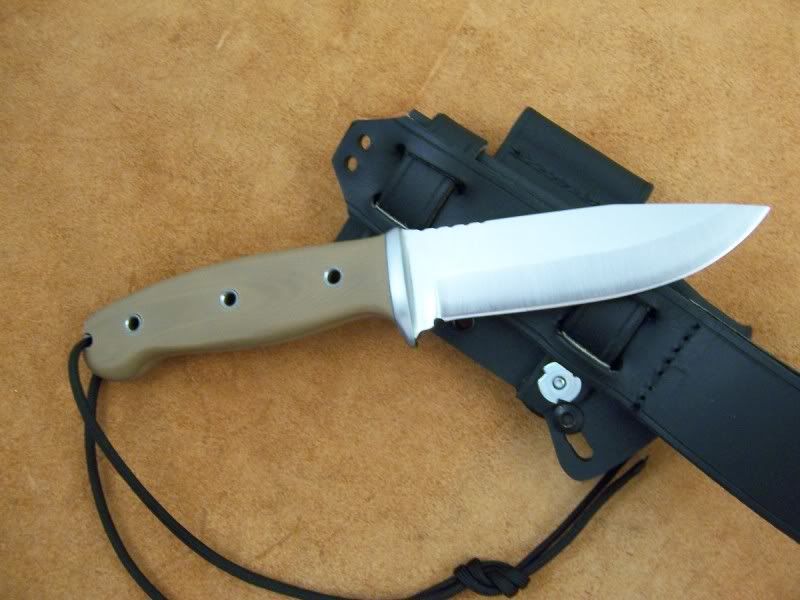

The handle is a little thinner than most “bushcraft” knives, but it fits the hand well and gives it a flatter profile for the way I carry it. Mine ended up being a saber profile with a convex grind and it continues to remain razor sharp with stropping touch-ups.
There’s nothing magical about it; it just plain works well for me. Although I have a preference for spear or drop pointed blades, this clip point is still very stout and centers the point of the blade.

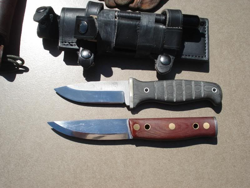

A little side-by-side with the Skookum Bush Tool:

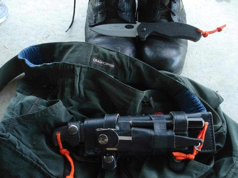

So, last year I was in Afghanistan and had a chance to correspond via email with Ed Martin and I was looking for a slightly larger blade and a sheath system I could integrate with my IOTV armor as well as different carry options depending on the situation.
I was really looking hard at the SERE 3Tb (now listed as the “MK-T3 small”). I went with A2 steel, 3/16” blade and the typical clip-point profile. The sheath option offered was a Kydex/leather hybrid that could be adapted for vertical or horizontal carry. It fit the bill perfectly and Ed was able to get it finished up and sent to me in Afghanistan (more more carry and a few cutting tests). Here are a couple pictures courtesy of Ed as he kept me updated throughout the process (truly a first class guy):
I’ll need to get some update pictures of both in the near future. Again, sorry to hijack the threat Brian with a few other Martin models, but I think it shows the two brothers are very talented in a very different but still functional designs.

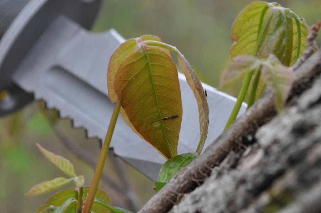

Great review, and thanks especially for doing some work with the saw; I've been wondering how their three-row setup would work. It looks like it moves material more efficiently than the classic double row version, though of course no 1/4" thick "saw" will ever be destined for serious lumberjack work. :D
Thanks for your input in the thread. I wish I could say I had known them that long. The more I talk about their knives, the more good feedback I hear.
I really like the three-row saw so far, I thinks it is an improvement over the two-row saw on the Apparo, but hard to say how much of an improvement since this saw is only 2 inches long. I do like how the center row of teeth is higher. I like how it starts the cut and holds the saw in place laterally in the initial cutting.

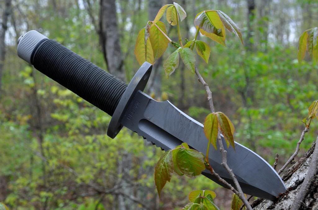

If the parts are joined with the proper metals and proper technique, there is no reason any hollow handled knife should ever separate. Brazing, bronze welding, silver soldering, oxy-acetylene, arc, and TIG will all accomplish the task adequately. Parts cleanliness and joint design are fundamental, as are flux if needed and a shielded deposit. A solid jig and tight fit will ensure a product that is straight and true. Correct tacking is also necessary.
Most of the hollow handle knives I have seen are essentially a waste of time, material, and money. They are turned out not for quality but for quantity. I have a Randall 18 7 1/2" I've carried for years, beat hell out of, and it's still in one piece. Having only 1 Martin, which is a standard tang model, I cannot directly address the quality of this particular knife, but given the quality of the one I do have, my bet is that Newt is like any good craftsman: If it ain't right, make it right, but never let a product you wouldn't put your name on go out the door.
I welded for the Des Moines, Iowa, predecessor of Chicago Bridge & Iron. My ID#39 is on bridges and water towers and tanks all over the country and various places in the world. I never failed an X-ray, and did TOO much repair work on welds by others that had failed - all of whom had been there far longer than I. Now, I'm retired, and yet the welding bug bit deep; I still look at welds too see how much the welder had in his work.
From what I can see of the joining process on this knife under magnification, I think you should have no problem, unless there are sub-surface faults that cannot be seen. I think you could take it to a hospital and for $30 they'd X-ray it. That's if you really want to know. I did that with an old double barrel shotgun, I cut the frame in half; it was cracked and the crack could not be seen.

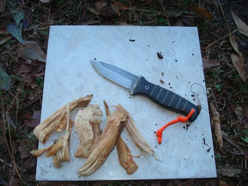

You are to be commended for the thoroughness of your testing. Most guys whack at a twig and call it good.

Thanks for your interesting input. I don't think I am going to bother with an x-ray though, I am happy with the knife as it is. Also, thanks for the compliment. I have a thing for dedicated survival knives, and my own thoughts of how well they should hold up and tend to test based on my own thoughts.
