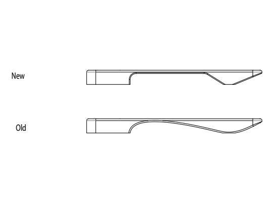

I have no experience with milled clips, so this is purely academic, but the new clip looks functionally identical to the original. Can someone chime in with how the redesign will fix any issues?

We wanted to provide some additional context to the conversation around the pocket clips on the Falcon (which is the same design as used on Crux).
We’ve been reading comments here in the discussion and monitoring the support requests for this drop closely, and have found the total number of clip-related claims is under 0.5% for 2500+ knives delivered.
While the data doesn’t show us there is a widespread problem with the design, we recognize that members were looking for a bit more flexibility.
So, based on your feedback, we’ll be taking the following actions:
1) Introduce a modified clip design on upcoming releases of Ferrum Forge Falcon, Crux, and any future models that are designed to be compatible with this clip style beginning in 2018.
2) Make replacement clips available for purchase, also beginning in early 2018. We hope to sell them for $20 or less, and to keep them in stock if there’s continued interest.
3) Provide a $5 credit toward the purchase of a replacement clip for anyone who purchased a Falcon or Crux with original clip design. Credits will be given automatically to any members who join the first drop for replacement clips, in the form of a refund issued when the drop ends.
Thanks to everyone for helping to make a great knife even better. We’ll send an email to everyone who’s purchased a Falcon when the updated clips are available. Here's a rough preview and comparison of the old/new designs:

If you look at the profile diagrams, you’ll notice that the present clips reach minimum thickness over a very small distance. All of the force from bending is concentrated over a that same small area as it’s essentially the only point of compliance.
The new clip has a longer distance of minimum thickness so the force should be spread over a larger area, lending itself to increased compliance—more springy.
In keeping the same general milled configuration, I would have also liked to see the clip lengthened a bit, increasing the compliance even more. Restating my comment a few posts above, the response speaks good things about MD customer service/CQI (:thumbsup::thumbsup:). Design/redesign aside, the replacement offer is a good move.

I wonder if it would be more than .5% if folks like me weren't afraid of breaking them by trying to loosen them? Flat (metal) clips I am never worried about tweaking a bit but this one is so stiff it concerns me.
