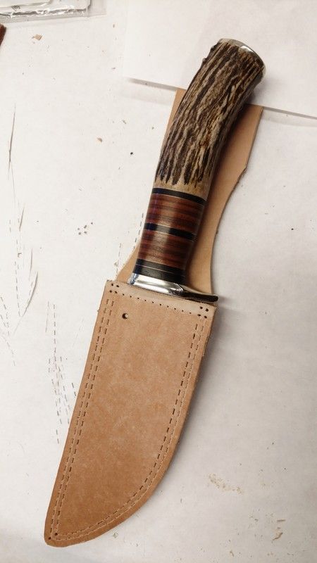

Should we do a dangler sheath for this so it can be worn with a pack, or just one that hangs low? Not sure I've seen a dangler with this style of knife, but Maynard usually carries a pack I think and billygoats ridiculous terrain. What say you Maynard?
Something that keeps the end cap down below the belt line would be beneficial for sure. Although, I've lost knives before(and Glocks) at elevations I didn't want to re-gain. So, this one would be inside the pack with the zipper triple padlocked.

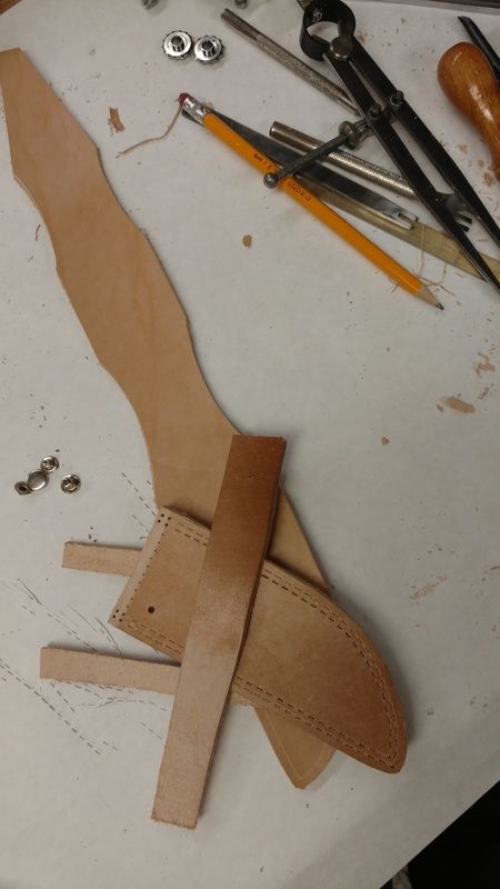

Right now I'm thinking the back piece will be vinegaroon black, and the front piece a dark brown with a black strap and silver snap. The edging will be black also. That sounds strange but I think it's gonna make the handle pop. The front piece will be pigskin lined, with a little folded lip on the outside
I think so, part of me wants to leave it undyed and natural, and part wants to do it like I explained above, dark and "rich" colored. Still not sure whcih way I'm gonna go but leaning towards the darker.
Pigskin puzzle piece. I've only done one pigskin lined sheath before and it took me a few tries. The top is punched for stitching and the pigskin is glued just over the stitch holes. From here I'll stitch it, fold it over and glue it to the backside. Pigskin sucks, it's rubbery, and doesn't want to form like cow but it makes for a nice lining.

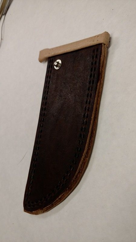

I was thinking more along the lines of a classic neatsfoot oil finish. I went with dyeing it, and am still fighting pigskin, almost done with that part.
Here's an ugly picture, but gives an idea of how the front piece will look.
