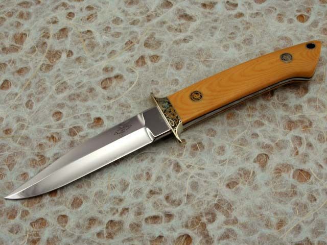

OK, I have to admit here are two examples where ivory micarta handles are absolutely beautiful.
Tharcis Holtzer Fighter. Photo borrowed from another thread.
I agree on this Holtzer fighter. This is the nicest micarta I have seen.
I generally like the fine grain linen micartas on certain knives but this color is near impossible to find. Came across a few blocks four or five years ago and haven't seen any since. Stunning knife.

OK, I have to admit here are two examples where ivory micarta handles are absolutely beautiful. I was actually seriously considering the Loveless for purchase about a year ago, however lost it as I was bogged down deciding if I could live with a micarta handle. My loss. :( someone else’s gain.

I thought those two are Antique Ivory Micarta, which was only available from Westinghouse direct, and quite out of production for many years now.
Which is a shame, as they're so attractive.
-j

1. The antique white ivory micarta was only a little off white when freshly worked, but yellows with time, exposure to light and air. It is some of the nicest synthetic material out there, but is very, very hard to find.
