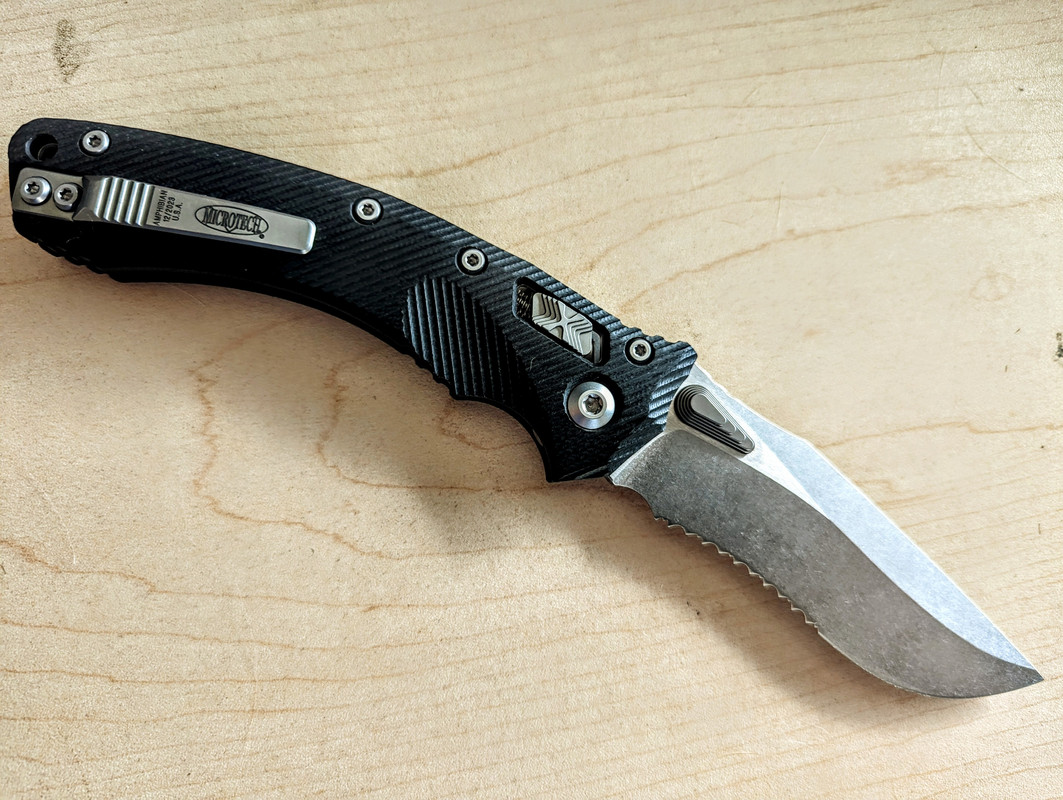

I just bought this from my LKS, and I LOVE it. I'm a big Axis lock fan, but I do prefer the ram over it so far. The action is smoother, the need to "balance" the wear on spring isn't an issue, and it way it wedges onto the tang gives me a pretty good idea of how I can expect it to wear in over time.
I haven't used it hard, but after reading this thread, I wanted to give it a good once over. As it came out of the box, the lock up is tight with no blade play. It has not failed a spine whack test of 6 or 7 medium/hard smacks at various points along the spine (tip to just north of the thumb tab as well in kind of in the middle of the two). So, basically I hit it against a wood desk covered with a thin blanket about 20-ish times without failure. I wouldn't say they were HARD, but I would say that it held up to more strikes than any of the ZT framelocks that I had that slipped off their face being tested in a similar way.
I did try to keep the tests consistent. When I tested the lock up, I did so by gently thumbing the blade out instead of giving it a flick. I figured the flicking action may cause the ram to drive in a bit deeper. I wanted this knife to be locked up as little as possible. I also did a few strikes on the spine after engaging the the lock and really cranking it forward to see if it moved after I hit it on the desk. I experienced no failures, but the lock did walk back from the "super engaged" position to the "just locked as if thumbed open position" on the tang, so take that as you will.
I have not adjusted the pivot at all, but I may crank it slightly tighter. I tend to like my Adamas knives more solid than fidgety, and while this knife does not seem to fail spine whacks, its does swing out with a bit of a wrist flick. Still, the lock up even this loose is incredible for a $300 folder.
The pocket clip says that it was produced December of 2023.

It's designed for longevity, if it goes all the way forward, as soon as you put some wear on the lock it will develop vertical play. This gives it room to self adjust, you'll find this on all cross-bar locks or Axis locks. Most locks don't fully engage for the same reason, most framelocks are at 50% or under linerlocks too, it's all intended to allow for self adjustment as the blade and lock surfaces wear out.
