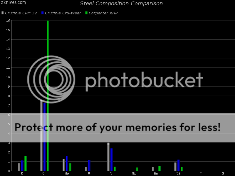

I would say CRUWEAR is similar to 3V, XHP, and M4. I don't have any D2, so can't comment. Out of those 3, XHP feels the most similar to me. 3V takes a beating better than the others, but loses its fine edge first. CRUWEAR loses some toughness, but gains in edge holding. M4 is still tough, but less so and has better edge holding. Edge holding isn't everything to me though. I am pretty rough on my knives and have rolled (never chipped) S30V, VG10, ZDP-189, CTS-204P, M4, ELMAX, and probably some others I am forgetting. I have never rolled CRUWEAR, XHP, or 3V. I may have not pushed XHP too hard though. CRUWEAR is just a very well balanced knife steel that excels at nothing but lacks nothing. It holds that fine razor edge very well and touches up nicely.
Chemistry isn't performance. The graphs from the Crucible site has 3V almost triple the toughness of D2 and Cruwear. About double toughness of M4.
D2 and Cruwear are nearly the same
http://www.crucible.com/PDFs\DataS...Vv1 2010.pdf
All steels are limited to their chemistry.
In the PDF you listed (your link does not work for me for some reason so here is the pdf on the link that worked for me)
http://www.crucible.com/PDFs\DataSheets2010\ds3Vv1 2010.pdf
Look at the values of Impact Toughness in the table.
CPM 3V HRC: 62 Impact: 40 ft-lb.
Cru-Wear HRC: 62 Impact: 30 ft-lb.
CPM M4 HRC: 62 Impact: 32 ft-lb
(Granted I am very critical on datasheets as they do not give you all the heat treatment information and piece orientation etc for testing so see it more as marketing)
Not really that big of a difference and expected if you look at the chemistry. XHP/D2 etc compared is IMO the really odd ones out and forms completely different carbides to that of 3V and Cru-Wear.
Quite interesting to see how close the 3V vs Cruwear chemistries are! I cannot imagine that anyone will see much of a difference in real world use if they are at the same hardness, edge angle and edge finish, unless the heat treats are way different.
