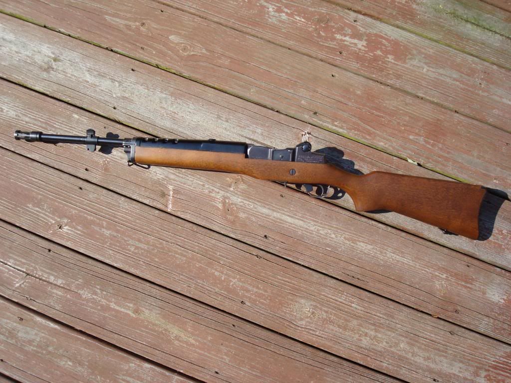

I like the reliability of the Mini and the accuracy of the AR. So I had this made for me.

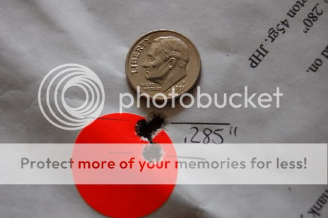

This is at 100 yards... Who says Mini 14's aren't tack drivers...:p

Short answer is yes. Many things make them look less "tactical" and most enhance its accuracy potential. Plain muzzle, stainless barrel, free floating forend, flat top receiver with scope, 20rn mags which I prefer anyway,fixed butt stock vs collapsable. With your skill at fitting, no reason you could not trade work for parts and build your own. One thing that also helps is to change the color- people see "Black Rifle" and knee jerk. Desert tones are popular now and look less threatening.
