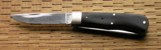

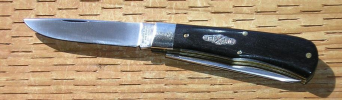

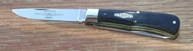

One of my raggydolls who's pattern I dig bore the brunt of my first attempt at a blade delete.
Couldn't find a tutorial here so dove in.
Fairly butchered the bolsters, for shame ed:(
I assume the original owner was a righty as the only decent blades were left hand opening. Paired the two remaining blades on the main blade back spring.
I filed the pivot of the manicuring blade to allow a decent walk and talk.
Used the original pins and peened them over. The worst of my ham-fistedness was erased by sanding the bolsters back.
Wanted the manicuring blade on the mark side so tweeked both till the snicked home without hitting.
Delighted with it and I'd say rather lucky it went so well. John Nodder might approve, but I'd say he wouldn't hire me lol.
