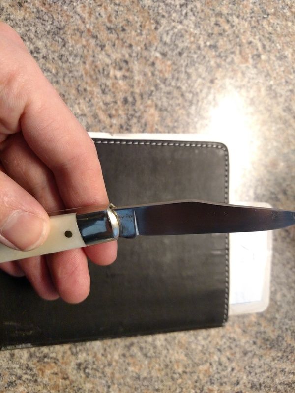

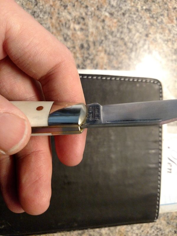

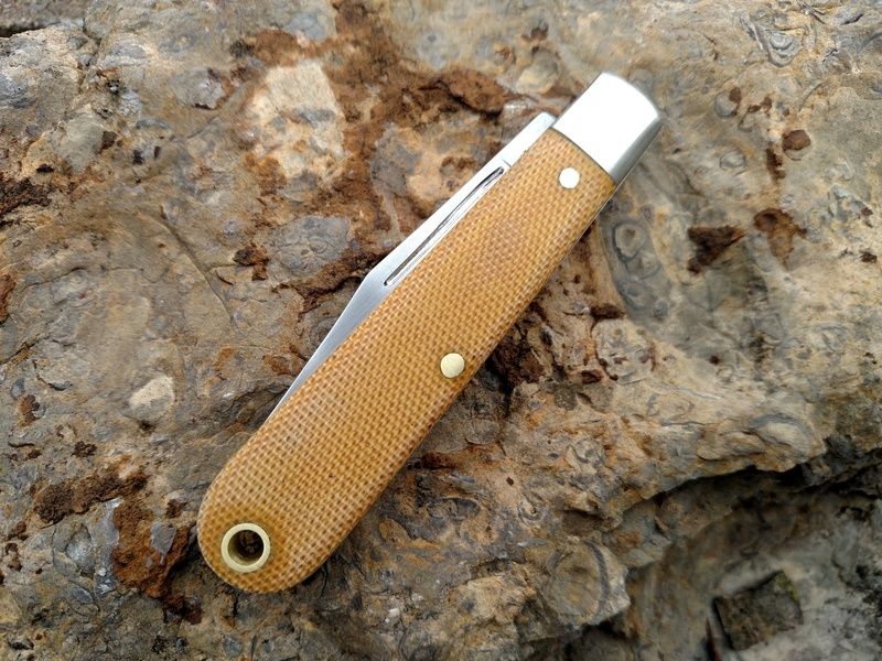

Just finished up a couple experimental TL-29 mods. This one was in Camel Bone and was just an attempt to try my hand at breaking a TL-29 apart and putting it back together and it still be a functioning tool afterwards. I got ahead of myself, broke 2 TL-29's down at the same time and the springs are different lengths apparently. I put a longer spring in and the blade was extremely hard to pull open and was at a strange angle when fully open. I dont feel too bad as Ive seen a couple in other threads that appear to be the same way but it was bothering me. I also made a bone (lol) head move and cracked the bone so that was enough for me to take it all apart and start over. The only pics I took apparently were these, just to prove that it lived, even if only for a day. They showed the spring issue. I LOVED the bone and will be trying it again with a different TL-29, not sure what Ill do with these parts that I salvaged but it will be good practice to complete it.

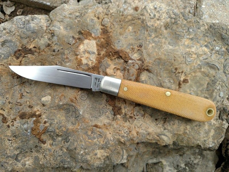

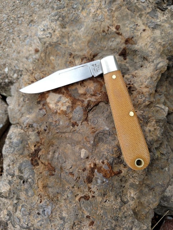

This is the other knife. I got it into my head that I REALLY wanted a long pull, clip blade GEC #15 (or #77 as I like the size better) in natural canvas micarta. Seeing that they are few and far between, I figured Ide git it a shot with the Camillus. I noticed that some TL-29 main blades have the nail pull towards the middle of the blade (centered in the recess of the screw driver) but the one I had received had it further up the blade closer to the tip. This gave me the idea to try and grind out my own clip and attempt a hand filed long pull. Clip turned out awesome...long pull not so much. It got off line before I knew it and looks silly THO it randomly is level with the handle lol. This knife will be a user tho I will likely try again with the long pull clip setup to try and get it right. The handle should darken up some as well as time goes on.

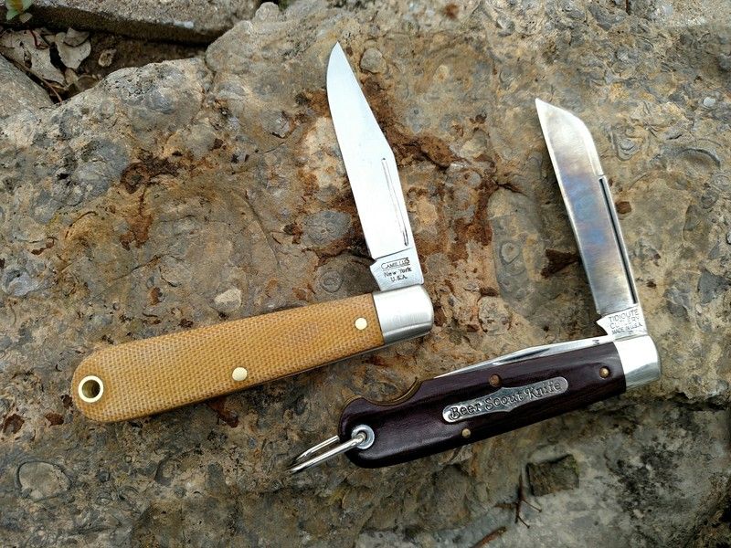

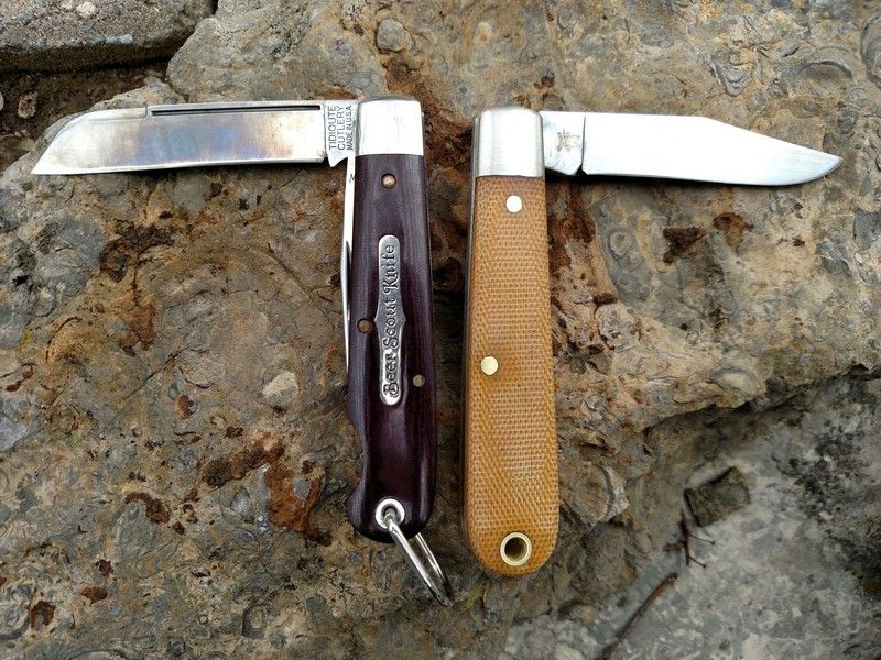

With a Beerscout to show its size. Slightly longer which is perfect for what Im hunting for size wise!
I learned quite a bit but still have some things to figure out and try on the next batch! Addicting fun!

Good stuff man! I too have developed the addiction. I have developed a little collection of completed knives and have a whole pile of 29s for future work. I like the clip point and long pull idea!

Thanks!!! I just have to dial in the long pull and then Ill be happy. I will eventually get it dialed in the more I work on it. I have a couple knives I want to keep the blades as is but I will be hunting others to attempt the perfect clip/pull combo with soon. Keep posting yours up, Im enjoying them very much!

You said you hand filed the long pull, what did you use? Also, if the off kilter pull bugs you enough you could grind the spine down to match the angle of the pull
I taped everything off and used some clamps as stops on each end then used a couple small flat files to get the line started and finish it off with the boxed edge of on of the smaller flat files. I got off course due to poor lighting Im pretty sure. I you look where I started near the tang stamp end, its on course and at the correct angle...then it got off from there. I toyed with the idea of doing just that, taking the spine down but I LOVE the clip look to this blade. IF I end up getting it right down the road, I will probably do it and it will become a super sleep pocket knife. Im also gonna toy around with putting a dremel cutoff wheel in my drill press and see if I cant add a bit of consistency to the initial cut, then file from there.
That said, i posted a visitor message to you but Ill ask here, where do you get your natural micarta and what do you do to get that amazing color?

I'm pretty sure I got it from USAknifemakers.com. I just sand it up through the grits to about 1200 then I buff it out. Depending on what you use as a compound it will darken up a bit. Add a little oil or wax at the end and it will give it a nice color.
Ah, thanks! Pretty sure I got mine from them as well but I stopped sanding around 600 grit. I might try going further and see what happens.
