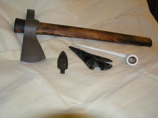

This is my pipe hawk. I had posted it before, but wasn't completely happy with how it turned out, so I got another haft and finished it differently. Also re did the patina the head, much happier with how it came out. For some reason it's looks a lot redder in the pics.

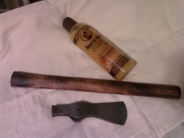

This is a trail hawk I picked up when I got the new haft, finished the same way as the the pipe hawk. I put some linseed oil on the head to protect it but it gets a brown tinge that makes it look rusted. I'll just take it off and oil them like I did before.
Nice looking hawks. Those hafts sure look long.
