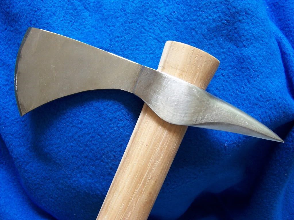

Okay so I got my hawk in today, I took the file to the eye, and smoothed it out. So on the bottom right I have a small gap, so I was curious where you guys think I should sand to get a tighter fit. Sorry for such a dumb question, but I would be lying if I said that this was the last one. I have the head sitting over night right now with some paint remover on it, hopefully that will be ready to go in the morning. Thanks to anyone that can help me out.
so I was curious where you guys think I should sand to get a tighter fit. Sorry for such a dumb question, but I would be lying if I said that this was the last one. .
I use a rasp (found for a buck at a garage sale) to remove wood faster. I think I get more control that way, too, able to even out the spots that are making the gaps like you show in the pic. That said I'm hit and miss on getting good fits so would like to hear what others do, too.
