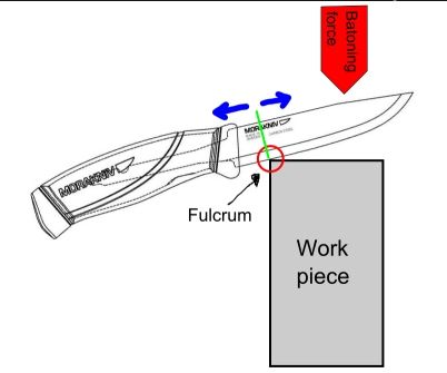

On the contrary all of the pictures I've seen of broken moras shows the blade broken at or around the logo roll mark, about an inch forward of the handle. This surprised me because I would have thought the tang would have been the weakest part. Interestingly, the logo on my robust is printed on.
I'm not too surprised. I think it mainly has to do with bad batoning technique.
If you keep the handle horizontal you're fine, but as soon you drop the handle below the object you create a fulcrum point (see image below). At the fulcrum point (green line) you're tearing the blade apart in two directions (indicated by blue arrows). And for mora's you often create the fulcrum point at the logo with a bad batoning technique. If the handle is supporting the tang over its entire length it may just be strong enough and fracture occurs at the fulcrum (logo). If the tang is not fully supported it may just break in the handle.
(see for more detailed description here http://brkca.com/docs/batoning.pdf)
Adding to that, Mora's aren't very thick and have less wedging effect than thick blades. So the edge of a Mora knife is more "abused" during batoning. Since they are not very thick they are more flexible as well. If your're batoning through wood with knots or a grain that is not straight a flexible blade will more likely be bend/warped (have seen it happening with people batoning with Mora's that the blade was bend in the wood log, but came out straight again). Consider that hapening with bad batoning technique (so creating a fulcrum point) is a good way to break the blade.
